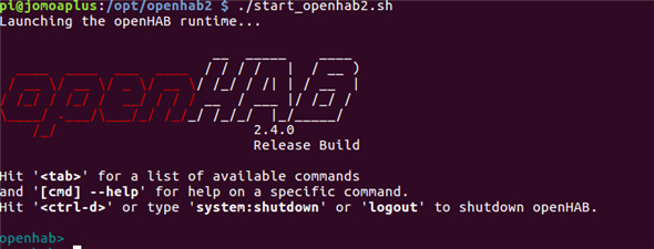

    4. Run or create a script with the following to start openHAB 2
# execute as restricted user openhab:
sudo su -s /bin/bash -c '/opt/openhab2/start.sh' openhab
    5. When openHAB 2 starts successfully, it will look like the following

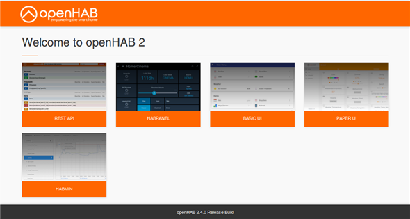

    6.  Once openHAB is started, wait a bit and then open a web browser and with the following.
http://<ipaddress>:8080/start/index
    The openHAB 2 Welcome page has multiple options for various User Interfaces (UI) that can be used to configure openHAB and interface with devices.  For this project, the BASIC UI and PAPER UI were used.  There was an attempt to use the HABPANEL, however issues were seen when running the Exec binding and there was not enough time to debug it.
     What I had found was that it was best to configure some items such as the MQTT Broker binding in the PAPER UI and configure other items in the associated config files as was done in openHAB 1. This gave me more freedom to run scripts and customize message sending.

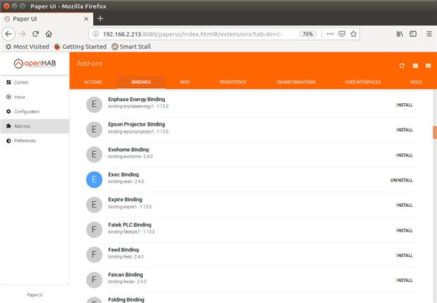

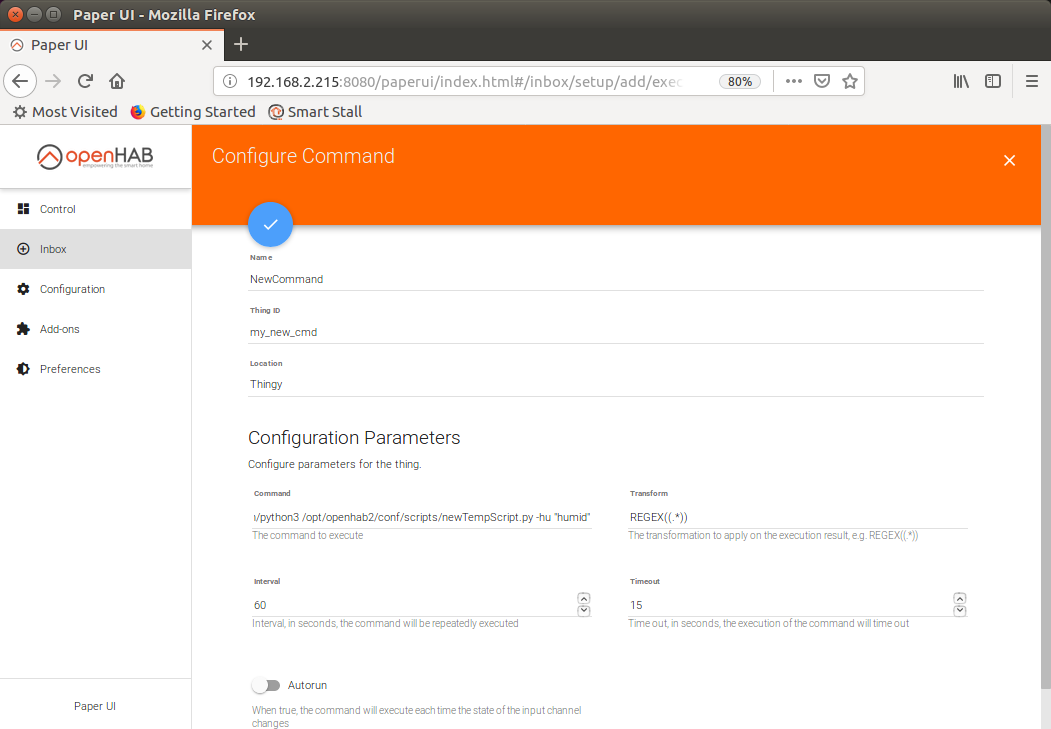

    3.  Next, from the openHAB 2 PAPER UI, install the Exec Binding by clicking on Add-ons from the left pane and navigate to the BINDINGS heading. Scroll down the list until the listing for Exec Binding is seen and click install. Once installed, the circle with the 'E' should turn blue. Check the openHAB logs for any errors.

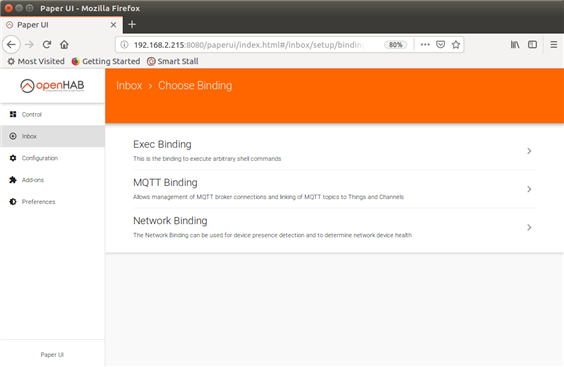

    4. Once installed, click on the Inbox option and the Inbox-> Choose Binding window should appear listing the new Binding.
    5. Click on the Exec Binding option and the Configure Command window should appear where a new Exec command can be configured.
        Add a Name, Thing ID, Location and command to run and an Interval is the command is to run automatically.
     In this example the following command was used to get the humidity value from the MATRIX Creator.
      NOTE: This is a custom script and not part of the MATRIX Labs code.
/usr/bin/python3 /opt/openhab2/conf/scripts/newTempScript.py -hu "humid"

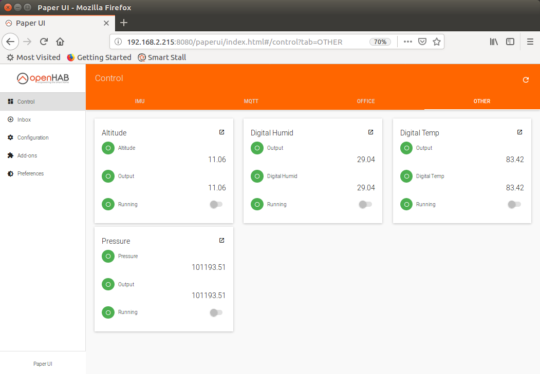

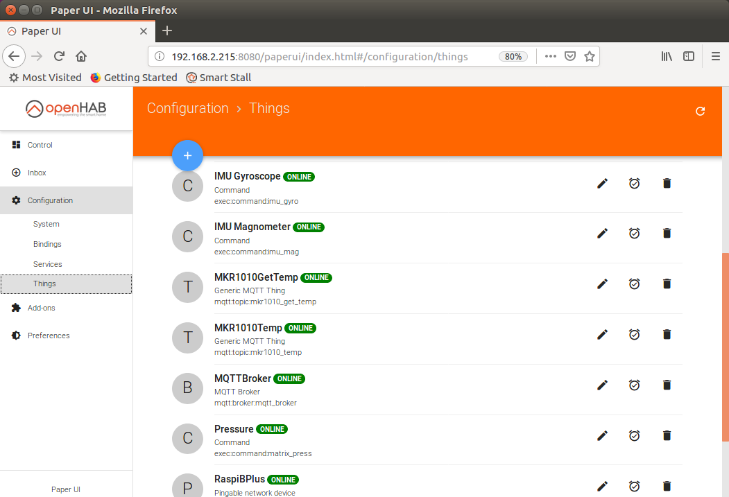

    6.  Once the configuration is saved, the new Exec binding should appear in the Configuration->Things listing.
    This is a list of some of the bindings used in this project.

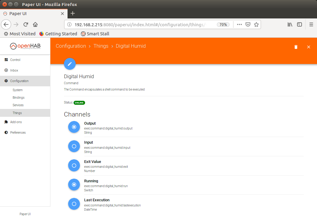

    7.  Click on the new Thing to further configure the options for the binding.
        NOTE: Input, Exit Value and Last Execution were disabled in this example by clicking on the associated blue dot.
    NOTE: Under the Output option there is a series of values.  These will be used to configure the Thing for the Basic UI:
                Ex: exec:command:digital_humid:output
    8.  To view the Thing running, click on the Control option to bring up the Control window and select the appropriate Heading for the Thing that was added.

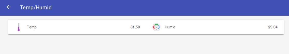

    10.  Items - A sensors.items files was created under 'items' which is used to define the Things configured in the PAPER UI for use in the Basic UI.   Using the Digital Humid Exec Binding example, add an entry in the .items file.
String HTS221Temp "Digital Temp" { channel="exec:command:digital_temp:output" }
String HTS221Humid "Digital Humid" { channel="exec:command:digital_humid:output" }
   NOTE: The use of the channel entry from the Thing listing "exec:command:digital_humid:output"
    11.  Sitemaps - Once there is an item entry in the .items file, create a .sitemap file under add an sitemap for the sensor item which will define what is displayed in the Basic UI. A sensors.sitemap file was created for this project. Here, both a Temp and Humid entry is made.
Frame label="ST HTS221" {
Text label="Temp/Humid" icon="sun_clouds"{
Text item=HTS221Temp label="Temp [%s]" icon="temperature"
Text item=HTS221Humid label="Humid [%s]" icon="humidity"

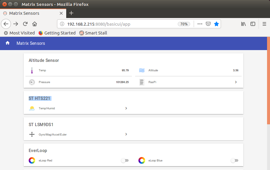

    13.  The Basic UI can be accessed from the Welcome openHAB screen or the following url from the system that is running openHAB 2.
http://<ipaddress>:8080/basicui/app
Since the Sitemap entry used a Text sub frame in the Frame definition, the ST HTS221 items can be accessed from the ">" character.
