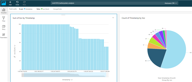

Report and Graph
In AWS Quicksight, I retrieve the data from IoT analytics. It can be presented, analyzed and shared in various formats.
While most of the other modules get data pushed, the reporting module pulls data from the IoT Analytics data set.
You can create dashboards, snapshots, etc...
The capture below shows the battery charge % over time, and a silly pie chart with number of messages per charge %.
