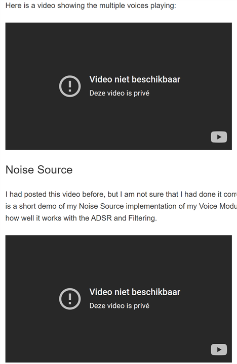

Here is a video showing the multiple voices playing:
Noise Source
I had posted this video before, but I am not sure that I had done it correctly (or timely as I edited the entry several times).  This is a short demo of my Noise Source implementation of my Voice Module.  I still need to try this out on my latest board to see how well it works with the ADSR and Filtering.

  • fmilburn
    fmilburn over 3 years ago in reply to genebren
    Hi Gene, it looks OK to me now.  Fantastic project!
    genebren over 3 years ago in reply to beacon_dave
    Thanks Dave!
    genebren over 3 years ago in reply to Jan Cumps
    Thanks Jan!  I have modified my YouTube videos to remove the 'Private' setting.  Hopefully that will fix that issue.  I am not sure what to do about the images.  I prepared them with the same tools that I have always used and added to the blog in the same way also.  I really do enjoy the community feel that we have here, but the tools are making me lose my mind.  What worked once, seems not to work the next time you try it.  I am just running out of ideas.
  • beacon_dave
    beacon_dave over 3 years ago in reply to Jan Cumps
    FYI seeing the same here.
    Jan Cumps over 3 years ago
    genebren , the images don't showup in this blog, and videos show as private:
