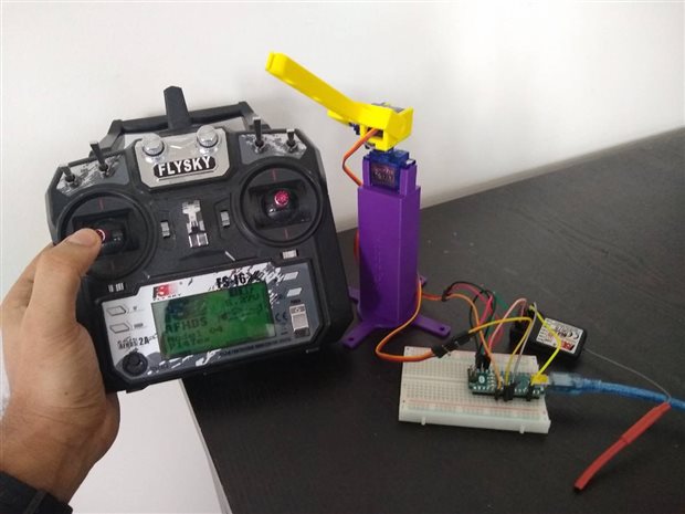

This blog post will show you how you can use a FLYSKY RC controller with an Arduino. As part of this demo project I am using the RC controller to control a couple of servos, this concept can be used to control animatronic projects which need DC motors and servos or any other kind of lighting setup. Basically, this project is just a demo and could have achieved by connecting the servo's directly to the receiver, but my plan as part of a couple of future projects is to drive DC motors/steppers and servos to build battle bots..

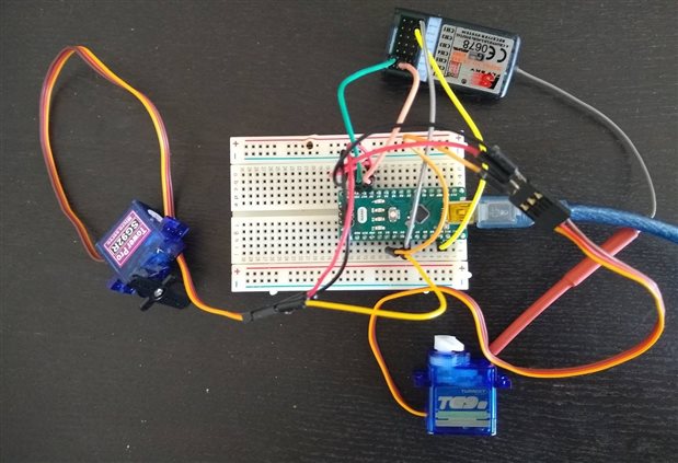

Circuit
The RC controller receiver FLYSKY AFHDS 6 channel is connected to the Arduino Nano PWM pins, the receiver pins are meant to connect servos
  • Any middle pin on the receiver is connected to 5V pin on the Arduino Nano
  • and the outermost pin is connected to the GND pin
  • CH1 is connected to PWM pin#6 on the Nano, which corresponds to roll on the plane
  • CH2 is connected to PWM pin#10 on the Nano, which corresponds to pitch on the plane
And the servos are connect to
  • Servo for the base of the 3D printed arm is connected to PWM pin#3
  • And the Arm is connected to PWM pin#5

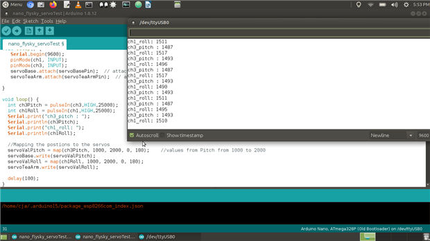

Arduino Code
Here is the Arduino Code used to print the RC controller inputs to Serial monitor of the Arduino IDE, and control  the two servos
//Created for Project14 using Arduino Nano , Flysky RC(AFHDS) controller and Servos.
#include <Servo.h>
int ch1=6; //roll on the RC controller
int ch3=10;//pitch on the RC controller
const int servoBasePin = 3;   //Servo connected to the top base of the 3D printed part
const int servoTeaArmPin = 5; //Servo connected to the Tea bag holder arm of the 3D printed part
Servo servoBase;
Servo servoTeaArm;
int servoValRoll, servoValPitch;
void setup() {
   Serial.begin(9600);
   pinMode(ch1, INPUT);
   pinMode(ch3, INPUT);
   servoBase.attach(servoBasePin);
   servoTeaArm.attach(servoTeaArmPin);
void loop() {
  int ch3Pitch = pulseIn(ch3,HIGH,25000);
  int ch1Roll = pulseIn(ch1,HIGH,25000);
  Serial.print("ch3_pitch : ");
  Serial.println(ch3Pitch);
  Serial.print("ch1_roll: ");
  Serial.println(ch1Roll);
  //Mapping the postions to the servos
  servoValPitch = map(ch3Pitch, 1000, 2000, 0, 180);//values from pitch from 900 to 2000
  servoBase.write(servoValPitch);
  servoValRoll = map(ch1Roll, 1000, 2000, 0, 180);//values for roll from 1000 to 2000
  servoTeaArm.write(servoValRoll);
  delay(50);// increase/decrease the delay to match the movement on the gimbal of the RC controller.

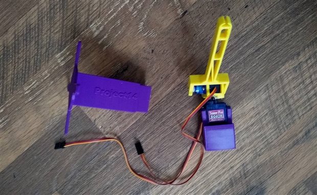

3D printed parts
For the 3D printed parts i used the STL files from the Automated Tea Dunker , to print all the 3D printed parts I used Hatchbox 1.75mm  PLA  and a Flashforge creator pro.
Here is a quick video demo of the Automated Tea Dunker in action with the RC controller
