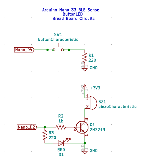

  • Button (Tactile Switch)
  • Piezo Buzzer
  • LED
  • 1K Ohm Resistor
  • 220 Ohm Resistor (x2)
  • 2N2222 Transistor
The Circuit
  • Connect the Button to Pin 4 of the Nano
  • Connect the Pizeo Buzzer to Pin 2 of the Nano
  • The On-board LED_BUILTIN

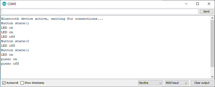

   8. View the change of state from the Arduino IDE Serial Monitor

   8. View the Serial Monitor for the LED state notices
   9.  For the Buzzer, writing a '01' to handle 0x0011 will turn it on.
   10. Writing a '00' to handle 0x0011 will turn it off.
