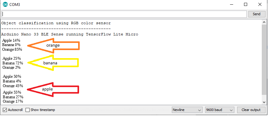

Run the TensorFlow Lite Model on the Arduino Nano 33 BLE Sense
   1. Download and load the object_color_classifier.ino file into the Arduino IDE or run it from Arduino Create
      https://create.arduino.cc/editor/TensorFlowExamples/8508c70f-5155-4e3b-b982-c5f6bd36ea5c/preview
   2. Add a model.h tab to the Arduino IDE Project and add the model.h code from the Colab session into the new file.
  3. Compile and Upload to Arduino Nano 33 BLE Sense
   4. Open the Arduino IDE Serial Monitor and present a well lit fruit to the Nano sensors to observe the identification data
