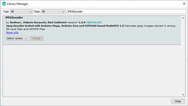

    1. Install the JPEGDecoder library

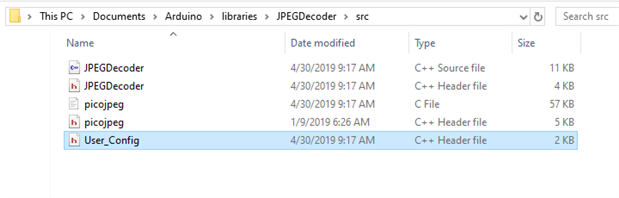

    2. Edit the JPEGDecoder User_Config Header file to remove SD Card defines
      Ex:
// Comment out the next #defines if you are not using an SD Card to store the JPEGs
 // Commenting out the line is NOT essential but will save some FLASH space if
 // SD Card access is not needed. Note: use of SdFat is currently untested!
 //#define LOAD_SD_LIBRARY // Default SD Card library
 //#define LOAD_SDFAT_LIBRARY // Use SdFat library instead, so SD Card SPI can be bit bashed

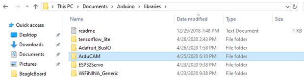

   3.  Download the ArduCAM libraries and copy the ArduCAM folder to the Arduino library folder
        https://github.com/ArduCAM/Arduino

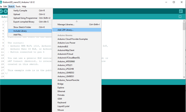

    6.   I ran into an issue with the Arduino_TensorFlowLite libraries in the Arduino IDE so I removed them.  The were still using the older experimental code.

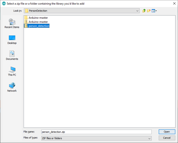

    7.  Add the person_detection.zip code to the Arduino IDE
        a.   Add .ZIP Library
        b.  Edit the name in  "library.properties" file for the person detection example.
            Arduino\libraries\tensorflow_lite

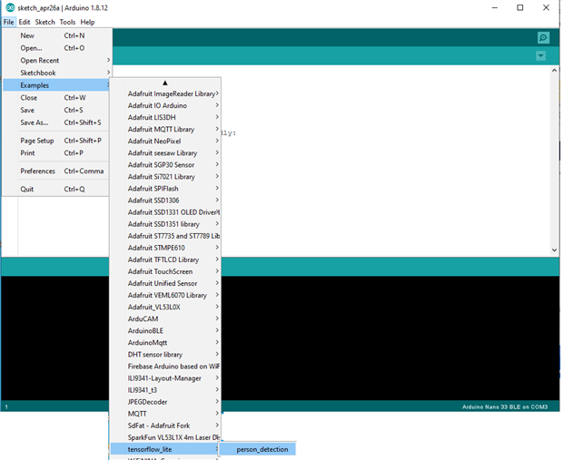

        c. The example should show in the Arduino IDE as such

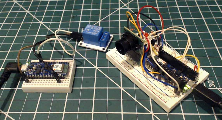

Add BLE Central and Peripheral communication
Reference
https://create.arduino.cc/projecthub/little_lookout/person-detection-with-tensorflow-and-arduino-47ae01
Hardware:
  • Add a second Arduino Nano 33 BLE Sense
       https://store.arduino.cc/usa/nano-33-ble-sense
  • Single Relay Board - 5V
        https://www.velleman.eu/products/view/?id=43557
Arduino Library
  • ArduinoBLE
    • Central -  PeripheralExplorer
    • Peripheral - LED
Prepare the code

    2.  Compile and load this code on the Nano with the ArduCAM connected
    3.  Modify the Peripheral LED code and add a 16-bit Characteristic UUID and location data.
         NOTE: This is designed to enable a Relay when a person is detected from the Central device

    4.  Compile and load this code on the Nano with the relay connected.
    5.  Start the Central Nano with the ArduCam
        Serial Monitor output - Scanning
Attempting to start Arducam
Starting capture
Image captured
Reading 2056 bytes from Arducam
Finished reading
Decoding JPEG and converting to greyscale
Image decoded and processed
Person score: 139 No person score: 194
Scanning for UUID
    6.  Start the Peripheral Nano with the Relay
Bluetooth device active, waiting for connections...
Connected to central: d8:4c:fd:36:96:eb
Got low alert
Set relay to LOW
Disconnected from central: d8:4c:fd:36:96:eb
    7.  Central Nano discovered Peripheral and sent a low for no person detected
Peripheral is: 1
Found f8:e4:92:83:c6:0a 'PersonDetectionMonitor' 1801
Connecting ...
Connected
Discovering attributes ...
Attributes discovered
Wrote low alert
Peripheral disconnected
Starting capture
Image captured
    8.  Central Nano detected a person and sends a high alert to the Peripheral
Starting capture
Image captured
Reading 3080 bytes from Arducam
Finished reading
Person score: 224 No person score: 94
Scanning for UUID
Peripheral is: 1
Connecting ...
Connected
Wrote high alert
    9.  Peripheral received high alert and enables the relay
Got high alert
Set relay to HIGH
This will go back and forth until the boards are reset or powered off.
