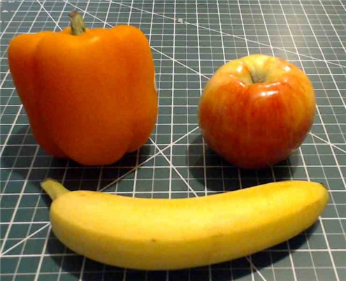

Fruitware
  •      Apple
  •      Banana
  •      Orange (Using an Orange Bell Pepper instead)

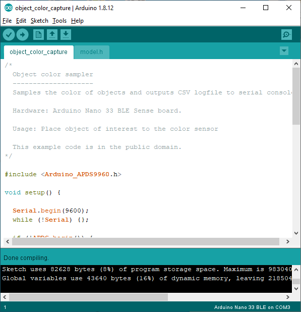

  1. Download the object_color_capture.ino file from the following link to capture the fruit data
      https://create.arduino.cc/editor/TensorFlowExamples/ca761558-13ed-4190-baee-89ced06147c3/preview
  2. Load the object_color_capture.ino sketch into the Arduino IDE; or just use the Arduino Create IDE.

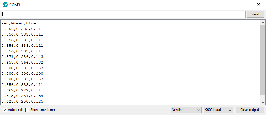

3. Open the Serial Monitor and select a fruit to collect data from.
      NOTE:  Ensure the board is close to the fruit and the fruit is well lit for better data collection.
                   Move the board over the fruit or the fruit over the board
    Ex: Banana
  4. Copy the data from the Serial Monitor and place it in a CSV file.
     Ex:
         banana.csv
         NOTE: Ensure the top line of the file includes the following:
           Red,Green,Blue
  5. Repeat for the other fruit.

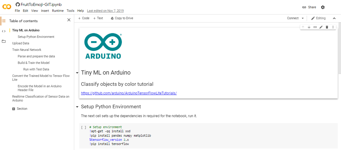

  1. Open the link to the FruitToEmoji-GIT.ipynb Jupyter Notebook to Train the Model
       https://colab.research.google.com/github/arduino/ArduinoTensorFlowLiteTutorials/blob/master/FruitToEmoji/FruitToEmoji.ip…

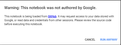

    NOTE: A Warning may pop up.  Just click RUN ANYWAY.
  2. Click the Arrow button next to Setup Python Environment to config the environment with the appropriate dependencies.
      Note any errors that are seen which may impact the session.

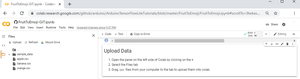

  3. Upload the banana, apple, and orange CSV files data to the Upload Data area in the Left Window Pane.

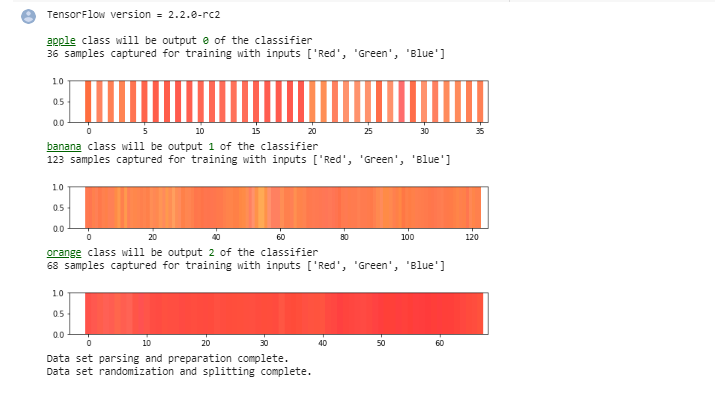

1. Run the Parse and prepare the data cell from the CSV files to a format that can be used to train the connected neural network
  2. Run the Build & Train the Model cell to build and train a TensorFlow model using the high-level Keras API.
   Output:

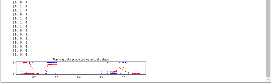

  3. Run with Test Data to put the data into the model and plot the predictions

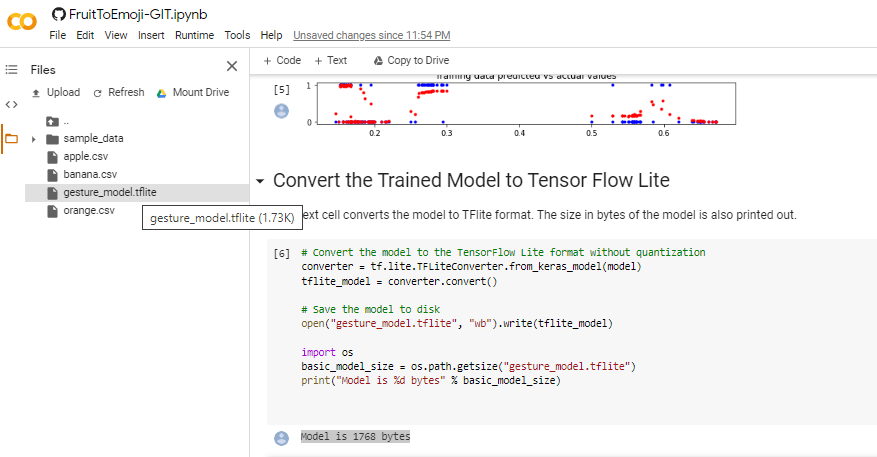

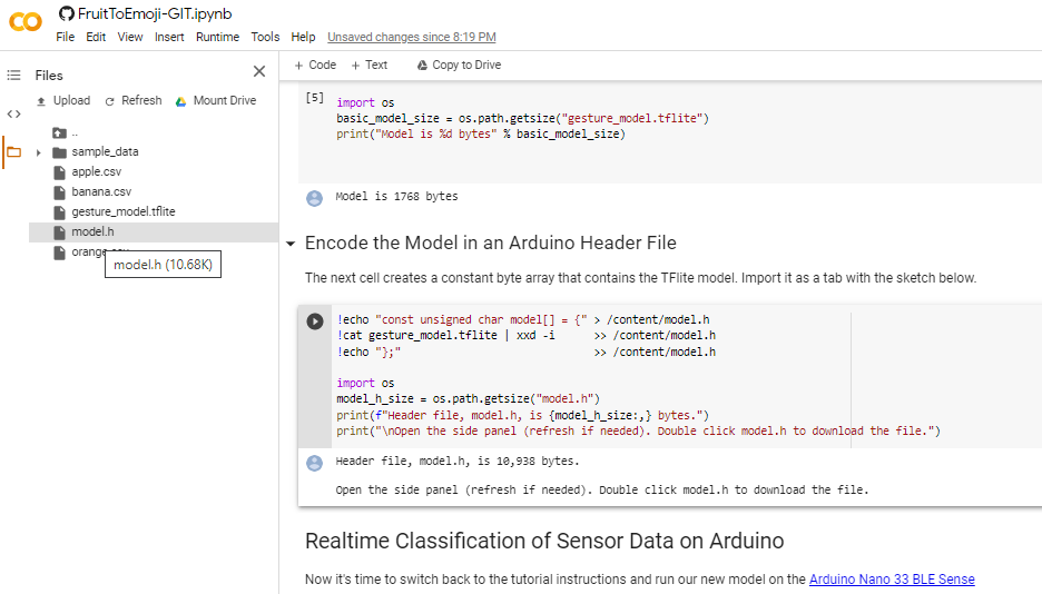

4. Convert the Trained Model to Tensor Flow Lite and show model size in bytes.
     Output
        Model is 1768 bytes
    Refresh files to view the gesture file that is created:
     File Created: gesture_model.tflite

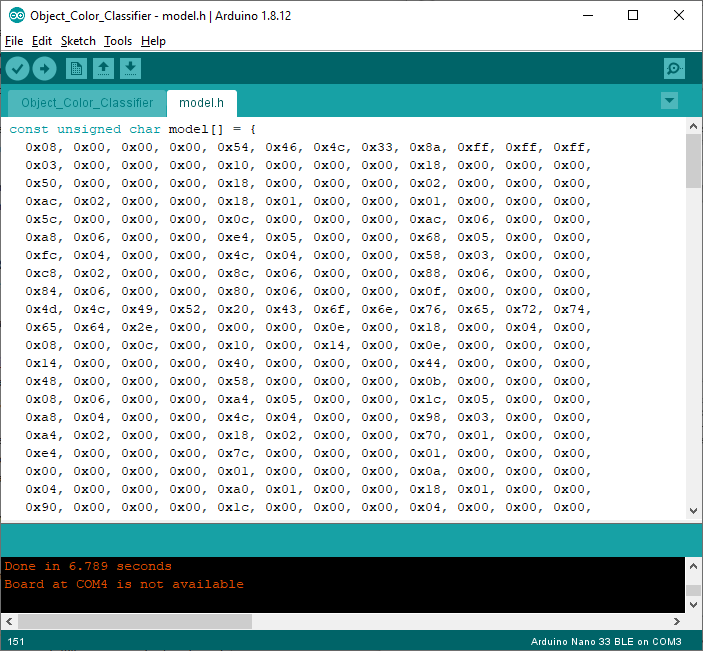

5. Encode the Model in an Arduino Header File
      This cell will create a byte array into the model.h file.
       NOTE: Previously this was not working but looks like it has been corrected.
       Refresh files to see the model.h file.
Run the TensorFlow Lite Model on the Arduino Nano 33 BLE Sense
   1. Download and load the object_color_classifier.ino file into the Arduino IDE or run it from Arduino Create
      https://create.arduino.cc/editor/TensorFlowExamples/8508c70f-5155-4e3b-b982-c5f6bd36ea5c/preview
   2. Add a model.h tab to the Arduino IDE Project and add the model.h code from the Colab session into the new file.
  3. Compile and Upload to Arduino Nano 33 BLE Sense

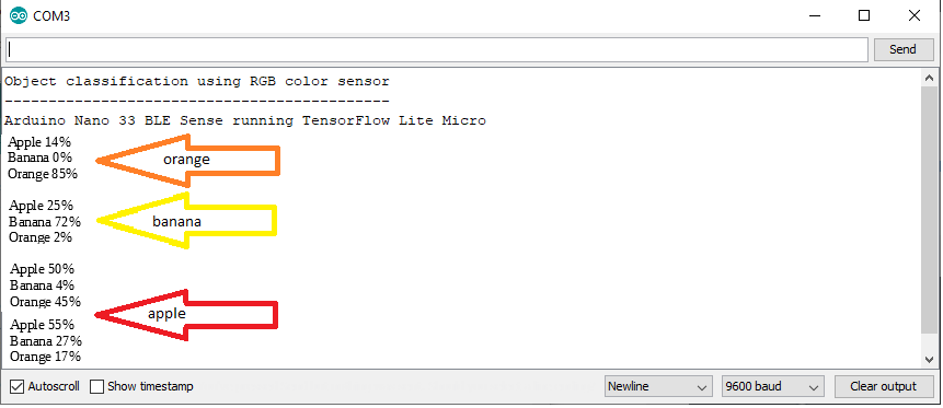

   4. Open the Arduino IDE Serial Monitor and present a well lit fruit to the Nano sensors to observe the identification data

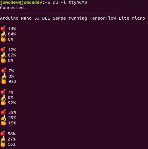

   2. Connect the Nano to either a MacOS or Linux system to view the emoji output.
       Note: I am not sure how to do this on Windows.
                An Ubuntu 18.04 VM was used for this.
   3.  Install emoji fonts and cu.
sudo apt install fonts-emojione
sudo apt-get install cu

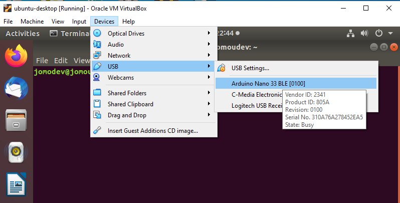

  4. Connect the USB connection from the Nano to the VM

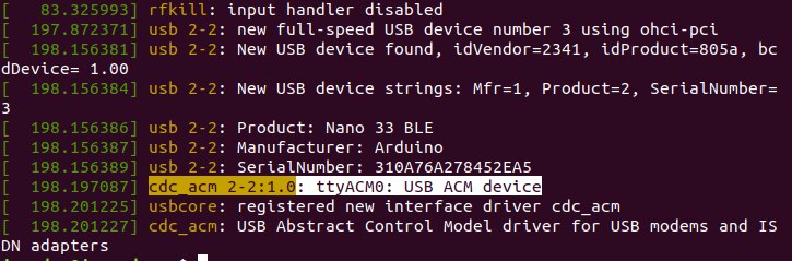

   5. Use 'dmesg' from a terminal to get the Nano tty device
   6.  Use 'cu' to connect to the Nano and open a serial connection.
cu -l ttyACM0
  NOTE: To exit 'cu' use '~.'
   7. Present a well lit fruit to the Nano sensor to view the data represented with emojis.
