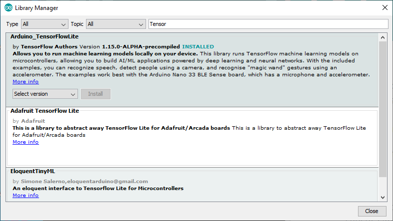

3. Install TensorFlow Lite library (Arduino IDE)
  Library: Arduino_TensorFlowLite

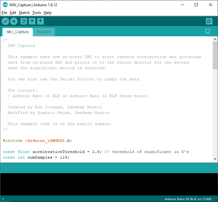

4. Download IMU_Capture.ino example and load into Arduino IDE :
    https://blog.tensorflow.org/2019/11/how-to-get-started-with-machine.html
    https://github.com/arduino/ArduinoTensorFlowLiteTutorials/blob/master/GestureToEmoji/ArduinoSketches/IMU_Capture/IMU_Capture.ino

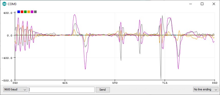

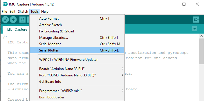

5. Use Arduino IDE Serial Plotter to view sensor data
  Tools→Serial Plotter
  a.  Pickup the Nano 33 BLE Sense and simulate a punch or arm flex movement to see the data plotted in the Serial Plotter:
Get started with machine learning on Arduino
https://blog.arduino.cc/2019/10/15/get-started-with-machine-learning-on-arduino/

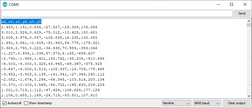

1. Capture gesture data
Collected data for the following files from the Serial Monitor
- punch.csv (10 times)
- flex.csv (10 times)
NOTE: Ensure to disable “Show timestamp” from Serial Monitor
Example Punch:
a. Pickup the Nano 33 BLE Sense and simulate a punch motion with the board in your hand.
b. Repeat 10 times
c. Notice the data that is collected in the Serial Monitor.
  d. Copy the data from the Serial console and create a .csv file associated with the action: either punch.csv or flex.csv.
      NOTE: Ensure the first line in the file looks like the following:
              aX,aY,aZ,gX,gY,gZ

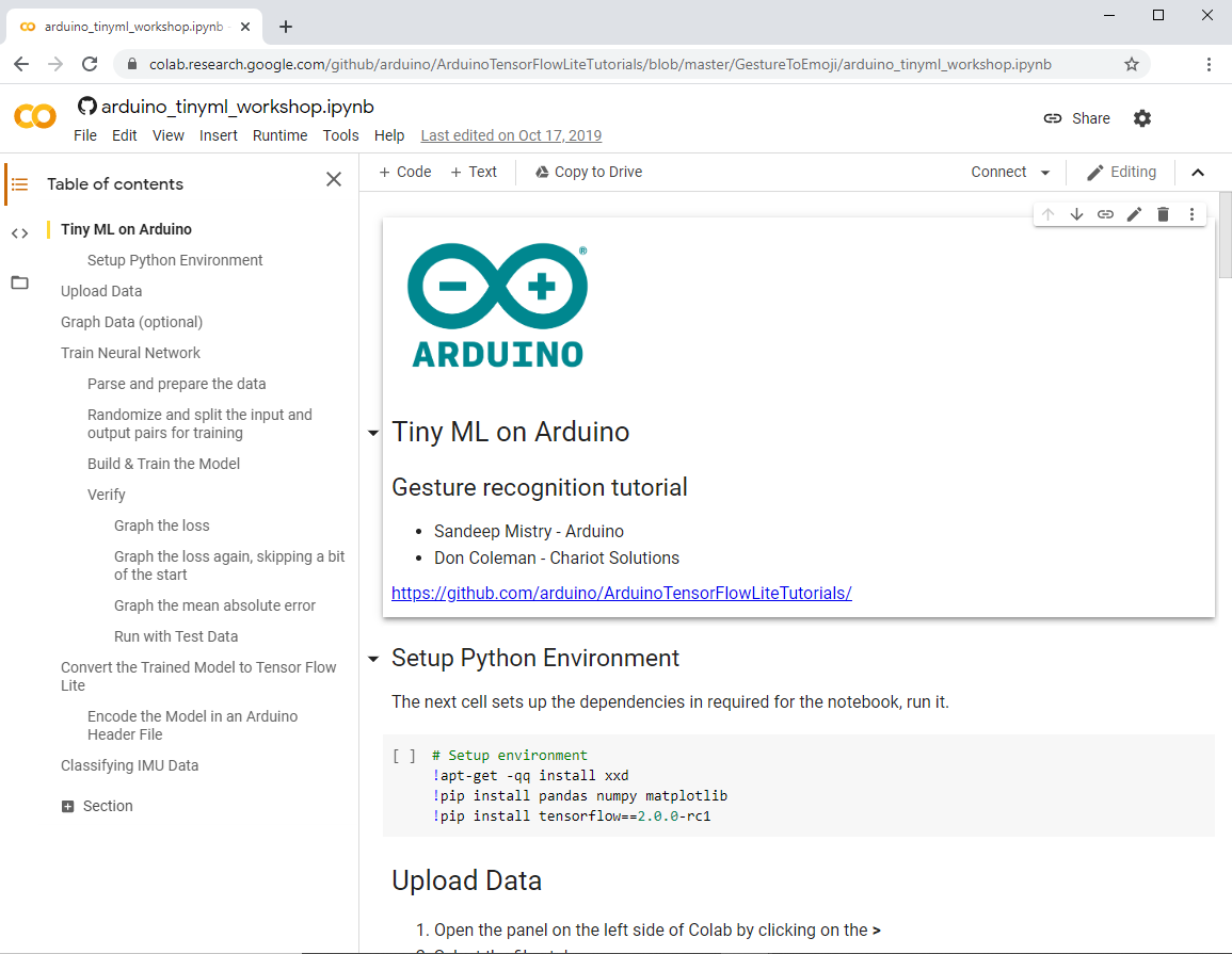

2. Go to Colab for Jupyter notebook
   Arduino Example:
   https://colab.research.google.com/github/arduino/ArduinoTensorFlowLiteTutorials/blob/master/GestureToEmoji/arduino_tinyml_workshop.ipynb
   GitHub Examples:

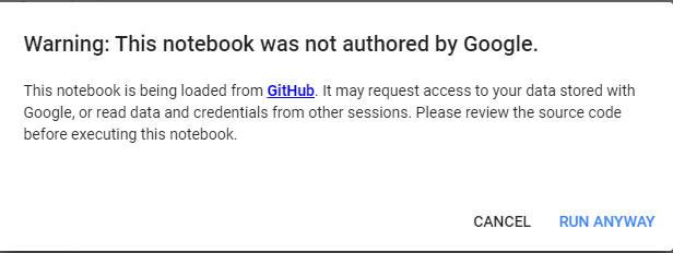

      NOTE: When first loading the Jupyter Notebook, a Warning screen will appear.
                  Just click RUN ANYWAY

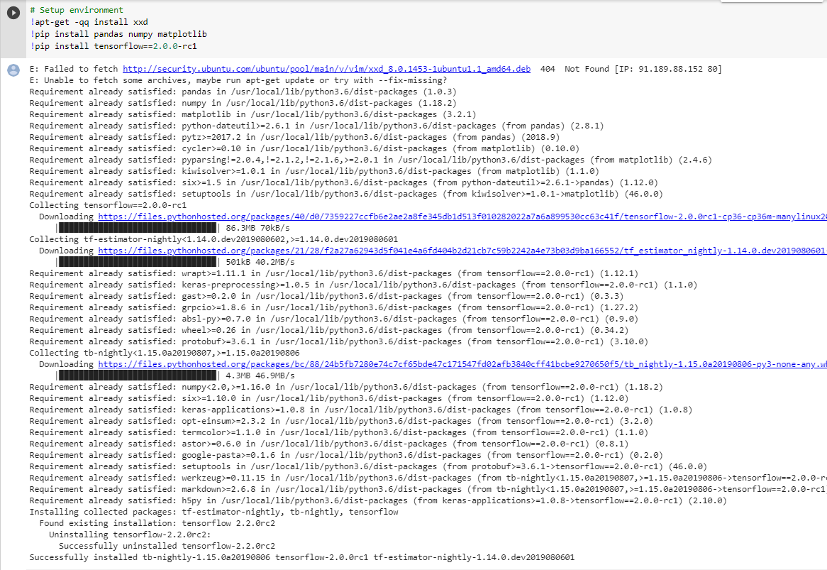

3. Run Setup Environment.
     NOTE: This will result in the install of a number of required packages

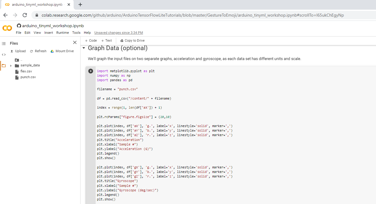

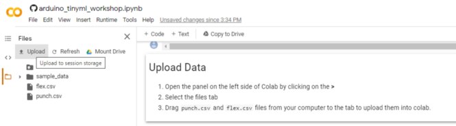

4. Upload the capture data
- punch.csv
- flex.csv
  Select the Folder icon in the left Window Pane to upload the .csv files

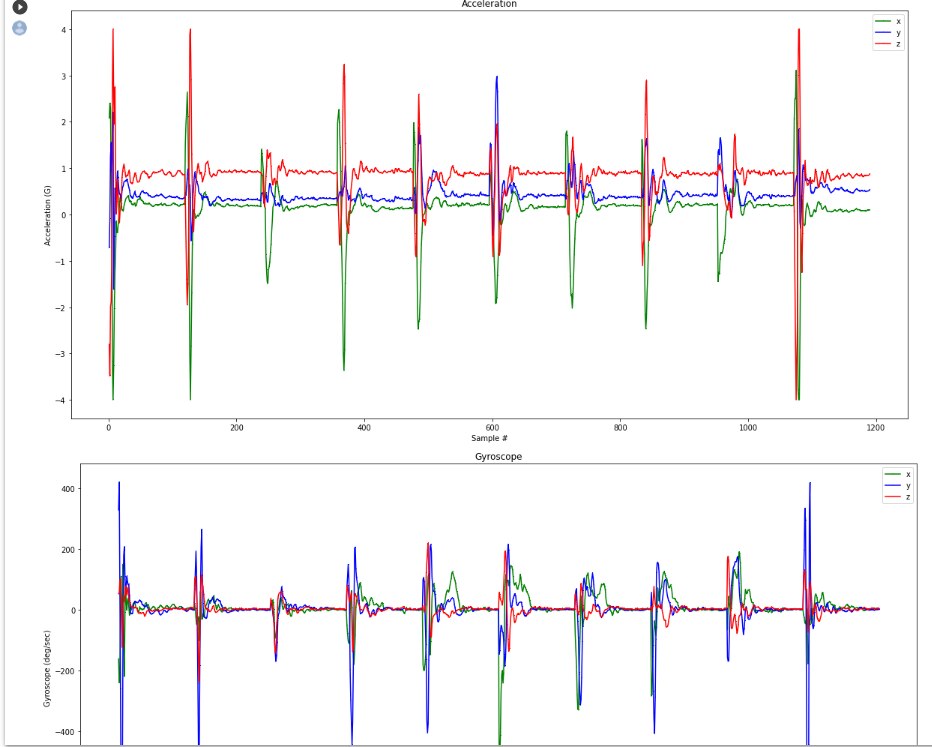

5. Graph Data (Optional)
6. Train Neural Network based on .csv data

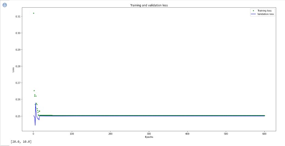

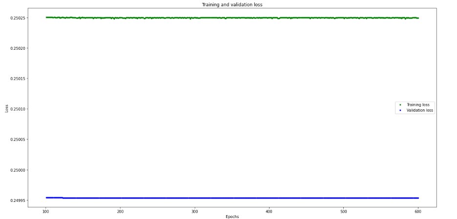

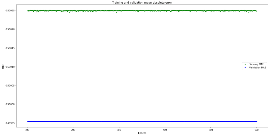

9. Verify
    Graph the models performance vs validation
- Graph Loss
- Graph the loss again, skipping a bit of the start
- Graph the mean absolute error

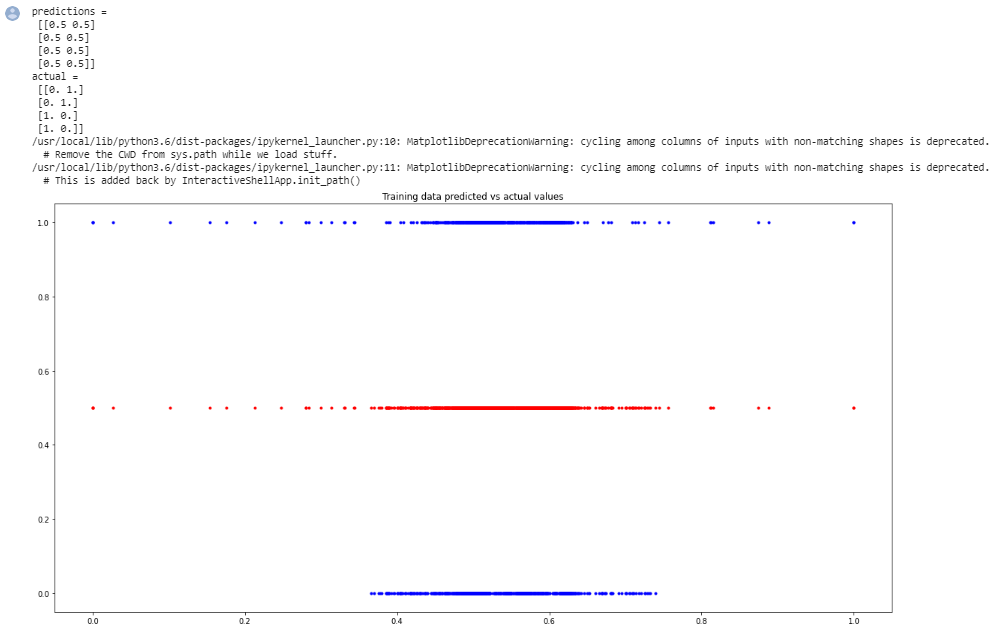

10. Run with Test Data

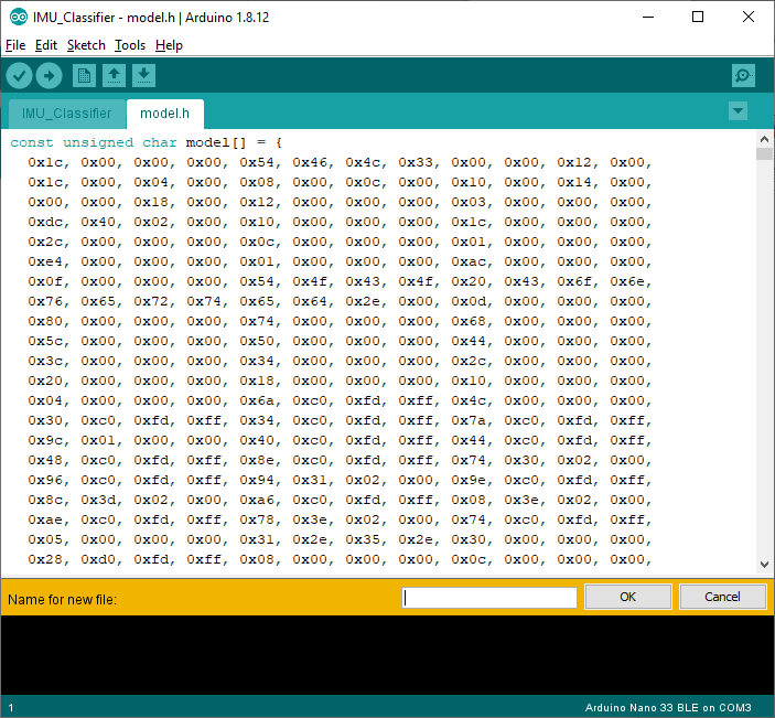

12. Encode the Model in an Arduino Header File
- Output from Notebook
/bin/bash: xxd: command not found
Header file, model.h, is 35 bytes.
Open the side panel (refresh if needed). Double click model.h to download the file.
NOTE: The model.h file has a blank array from the Colab exercise.
Issues were seen while running the example and an issue was filed on GitHub:
https://github.com/arduino/ArduinoTensorFlowLiteTutorials/issues/11
- Found I had to copy the files to a Linux system and run the commands manually:
- create_content.sh
#!/bin/bash
 echo "const unsigned char model[] = {" > content/model.h
 cat gesture_model.tflite | xxd -i >> content/model.h
 echo "};" >> content/model.h
- get_header_size.py
#!/usr/bin/env python3
 import os
 model_h_size = os.path.getsize("./content/model.h")
 print(f"Header file, model.h, is {model_h_size:,} bytes.")
 print("\nOpen the side panel (refresh if needed). Double click model.h to download the file.")
    - Once complete, copy the contents of the model.h file to the model.h in the Arduino IDE

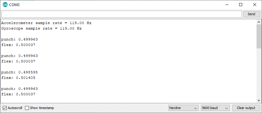

15. Compile and Upload the Sketch to the Nano 33 BLE Sense
16. Open the Serial Monitor and perform the punch or flex motions again.
The results from the model will be shown in the Serial console:
NOTE: This example resulted in about 50/50 split when doing a punch or flex
That is it for this example.

    The tutorial is fine but isn't the result wrong? If I understand the output correctly it gives a 50/50 percent chance of it being a punch or a flex.

    instead of running step 12 on a different machine, you can add a line of code to the Colab:
    !sudo apt-get install -y xxd
    and generate the model. Great tutorial, thank you!
