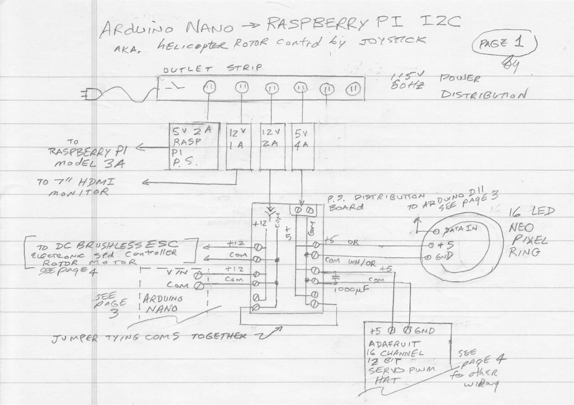

A DC brushless rotor motor’s speed is to be controlled by a Raspberry Pi using a I2C servo hat, receiving throttle data from the Arduino I2C.
The project goal is to send the joystick position from the Arduino to the Raspberry Pi using I2C for main rotor speed control.
A 3D helicopter printed helicopter has a DC brushless outboard motor mounted on it as main rotor (with a model airplane prop on it mounted upside down.)

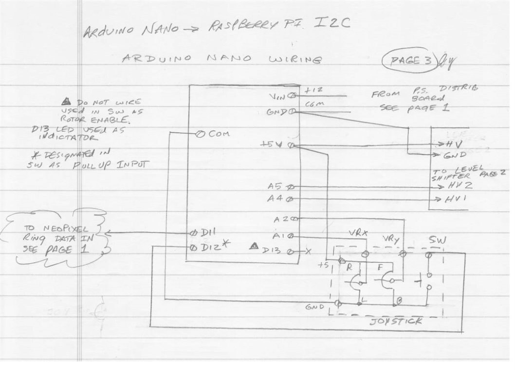

The tail rotor is a WS2812 neopixel ring was wired to the Arduino Nano, also using the joystick positions for color and speed of LED flashing.
The tail rotor neopixel ring will change cycling speeds with the joystick position FWD-Back.
The tail rotor neopixel ring will change colors  with the joystick position, center, left , and right.

  1. using the integrated joystick switch, create a rotor motor enable signal which resides in the Arduino Nano.
The enable signal will toggle by pressing down on the joystick.
When rotor motor is enabled, LED13 on the Arduino will be lit as visual feedback of a possible danger condition.
When the rotor motor is disabled, LED13 will be out.
The rotor motor enable bit is sent over I2C to cause the rotor motor speed reference to be set to zero when LOW.
When the rotor motor enable bit is HIGH, the rotor motor servo speed reference will follow the FwdBack joystick position. Full Back = top speed ( 90 degrees reference = 1.5 ms on the 20ms duty cycle) stick full back slows it to zero speed.

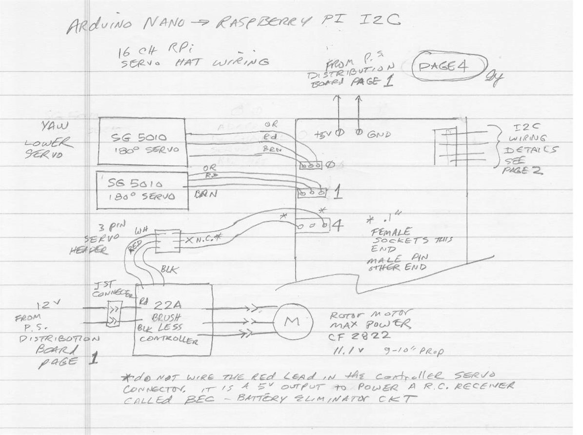

  1. YAW CONTROL The 3D printed copter will be mounted on a 2 axis servo bracket. The bottom servo position will be controlled by the left/right joystick so full left points the copter left, full right points the copter right. The servo position reference will have reference rate clamps so reduce mechanical stress on the mechanicals.
  2. PITCH (TILT) CONTROL – on the 2 axis servo bracket, the upper servo position will be controlled by the Fwd/Back joystick. The angle and rate will be limited to reduce mechanical stresses.

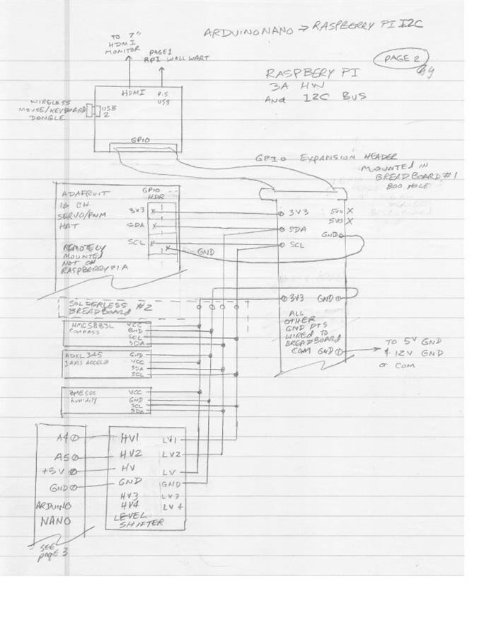

In the body of this submission is Arduino code, Raspberry Pi Python code, and the wiring schematics !
