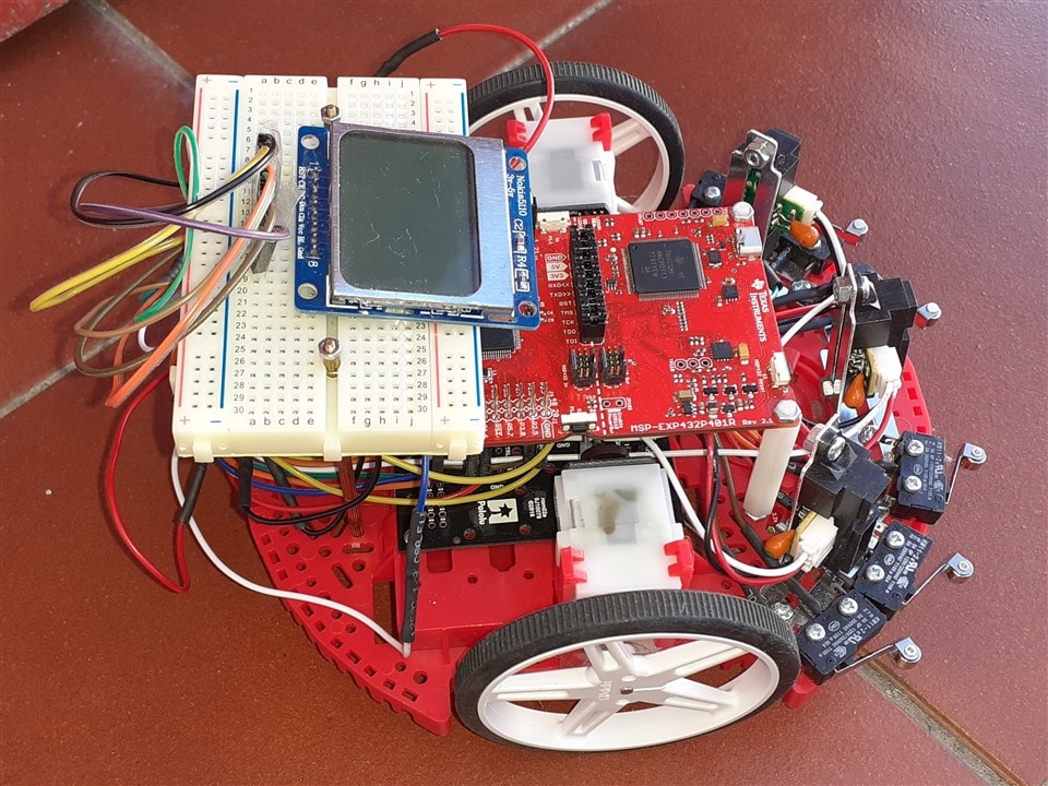

Something similar, a light follower jumping robot controlled with a TM4C123CXL.
I already had my rail-to-rail Op Amp to generate the triangle wave.  I only found one OP484 so I had to reduce the scope of the project and simplified the circuit.

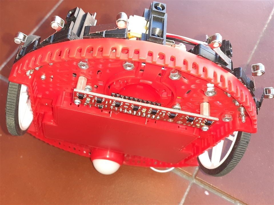

The TI-RSLK comes with a QTR-8RC Reflectance Sensor Array. The LEDs are controlled by a MOSFET with a gate normally pulled high, allowing the LEDs to be turned off by setting the MOSFET gate to a low voltage.
Unfortunately this line sensor could not be used for my Op Amp Line Follower. It is a recommended line sensor to be controlled from a microcontroller. You must first charge the output node by applying a voltage to its OUT pin. You can then read the reflectance by withdrawing that externally applied voltage on the OUT pin and timing how long it takes the output voltage to decay due to the integrated phototransistor.

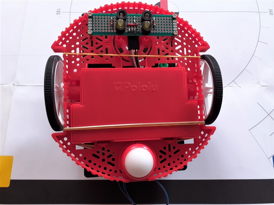

So again I went back to the light follower jumping robot and stole the photoresistors from it. I used them to react to reflected light emitted from two LEDs.
Romi chassis
And to continue with the recycling I used the chassis of the TI-RSLK. The Romi chassis is a differential-drive mobile robot platform with a diameter of 6.5″ (165 mm) and an integrated battery holder for six AA batteries. The drive wheels are located on a diameter of the circular base plate, allowing for turns or spinning in place. A large, fixed ball caster in the rear provides a smooth third point of contact.

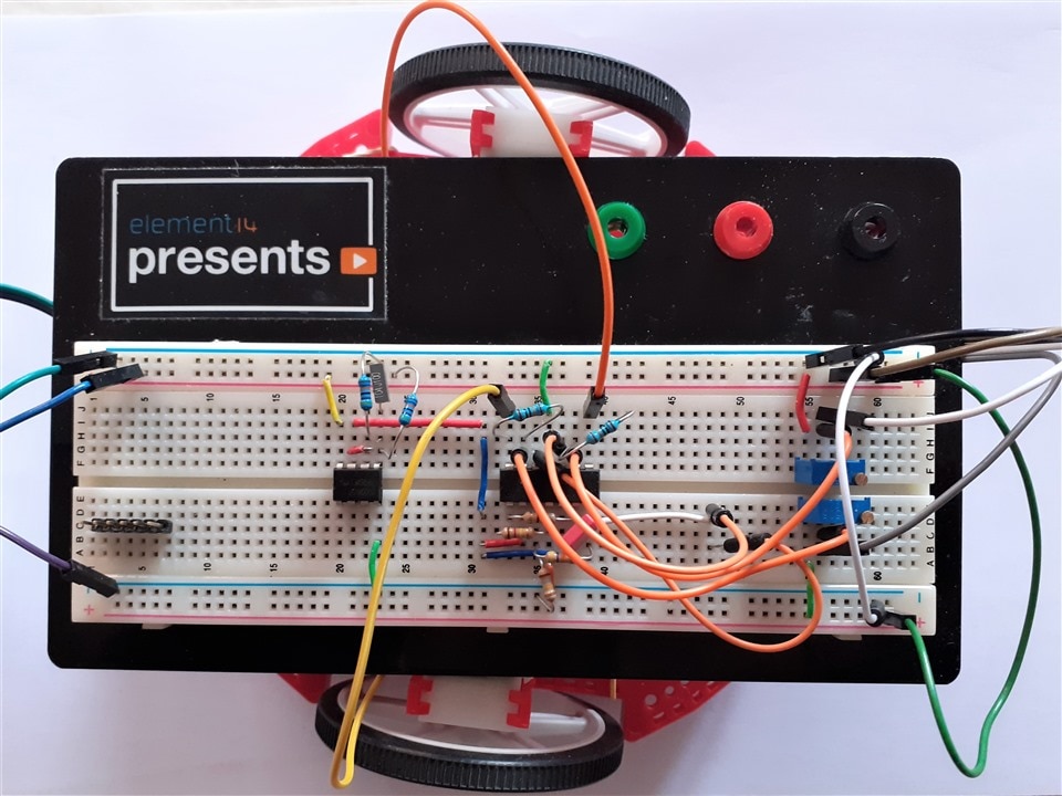

Breadboarding the circuit
For the first tests I built the circuit on a breadboard.
Checking the response without connecting the motors.
Oscillators square and triangle waves and PWM signals for both motors.

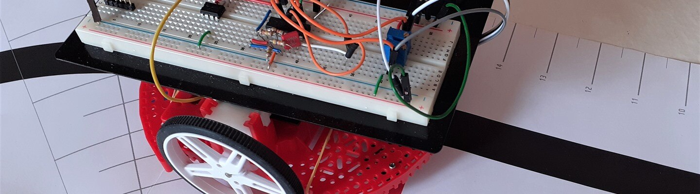

Testing with the motors
The first prototype in action. It already needs some tweaking, but the line follower... follows!

    Thanks, robogary.The Nokia 5110 LCD display was used for real-time monitoring, so you could view debugging parameters while the robot explored the world.
