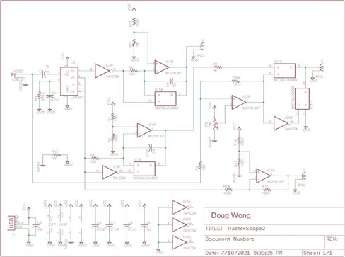

Here is one of the circuits I came up with:

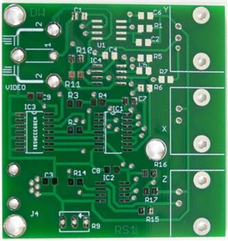

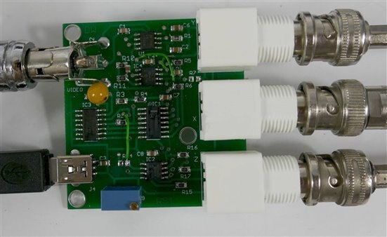

The PCB looks like this:
The PCBs cost $5 / 10 cards, and arrived 3 days after ordering.
This circuit has a composite video input feeding an LM1881 which extracts horizontal sync pulses and vertical sync pulses.

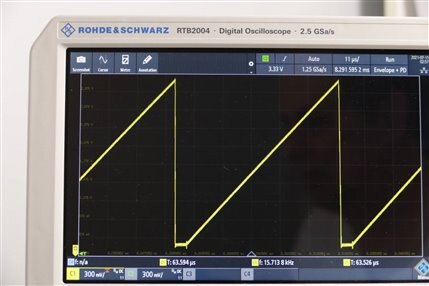

These pulses are used to reset op-amp integrators (using analog switches) to create sawtooth waveforms. The "horizontal" sawtooth is a ramp that increases with time where the voltage corresponds to a position in the X axis of the scope - when it is in X-Y mode: The op-amps used in this project have a 10 MHz bandwidth, because I am using one of them as a comparator at pixel frequency, but it could probably use an even higher bandwidth op-amp or a proper comparator.

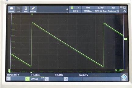

The frequency of the sawtooth in this case is 15.714 KHz. The flat section is due to the horizontal sync pulse duration.
The "vertical" (inverted) sawtooth has a decreasing voltage with time because its voltage corresponds to he vertical position of the trace and the raster scan of the video expects to start at the top of the screen which is the highest voltage.
This waveform has a frequency of 59.94 Hz.
When these sawtooth signals drive an X-Y display they should create a "white" screen as the signal scans back and forth over the whole screen.
The circuit also has a comparator to turn the voltage of one of the waveforms to zero volts (using an analog switch) whenever the video signal exceeds its threshold - which is adjustable using a trimpot.

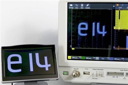

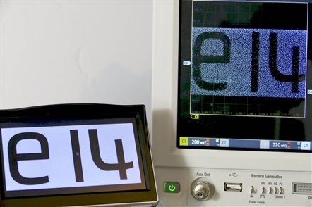

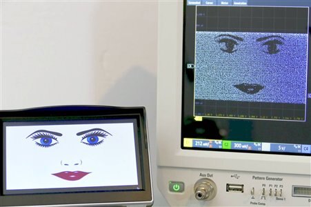

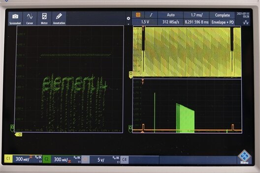

My circuit has an issue with displaying the raster as I envisioned it. There is some noise in the signals that cause the pixels to randomly be displaced a bit, which makes the image fuzzy.
The scope also creates a problem because it is digital. When the circuit is trying to turn off the trace, it switches the voltage to zero in a few nanoseconds. On an analog scope this wouldn't be visible because the trace brightness is proportional to the time spent at a voltage, so turning down the brightness would make fast signals disappear. On my digital scope it actually will display some of these fast signals (because they are actually there) as a sort of waterfall smear.
Here is an example of the 2 issues:

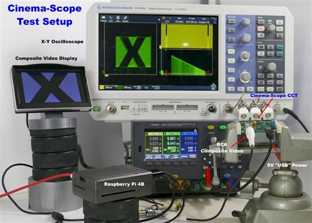

To display a composite video signal I used a Raspberry Pi and connected it to a small composite display at the same time as the Cinema-Scope circuit.
I spent quite a bit of time trying to minimize these issues - without much success.
I tried switching the horizontal signal to zero instead of the vertical - with similar results.
Running the "USB" 5 volt supply from a well regulated supply (instead of a USB power module) made a significant improvement.
I also tried a bunch of other methods to reduce noise, but it will need more radical measures.

Test Setup
The 5 inch TFT LCD (800x480) was surprisingly legible - all the small text generated by the Raspberry Pi was readable.

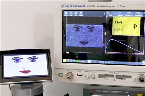

Test Setup Video With Example Video Content
I don't think I will be using this system to view video content, but it was an interesting exercise.
I will continue to ponder how to improve the circuit, but in the mean time, here is a video showing some of the graphics I created for the project as well as how the circuit and scope fare when displaying video:

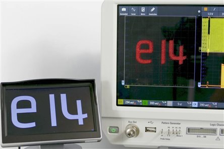

Here is an image showing results of filtering the vertical sawtooth to a half millivolt of noise and switching the horizontal sawtooth at pixel frequencies:
I did not show build details of the 3D printed stand for the little composite monitor since it wasn't central to the project, but if you want more info on any aspects of the project, or if you have any suggestions on how to improve system performance, let me know in the comments below.
Here are some images to show that this scope can do other colors (about 6 colors including rainbow and fire multi-colors):
Adjusting the scope can provide a more accurate image, but it is grainier (this is with filtered vertical sawtooth).....
