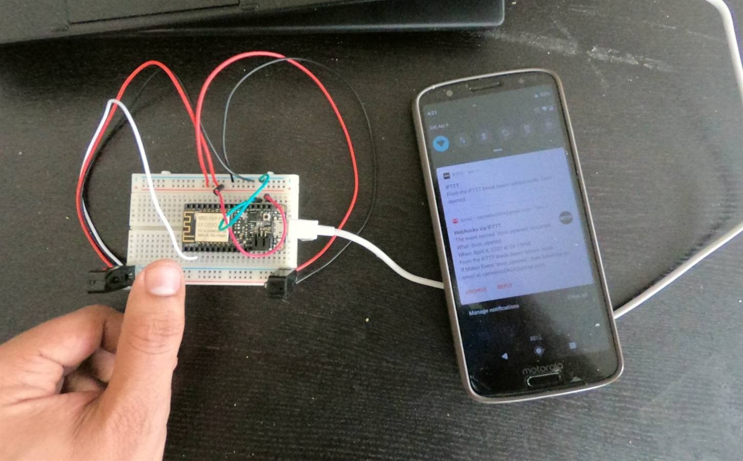

If you are into home automation or just starting with home automation, then this is a simple project to undertake. Basically as part of this project I am putting together IR break Beam IFTTT node, which send a message to the IFTTT cloud based on which you can trigger events, like send you a text message, email , turning on the lights in your home etc, when the IR beam is broken. In my case, I am using  Adafruit Feather HUZZAH which uses the ESP8266, which I think is most famous WiFi thing in the world today. Hoping this will spark some idea’s, and please leave a comment below, if you an interesting use-case.

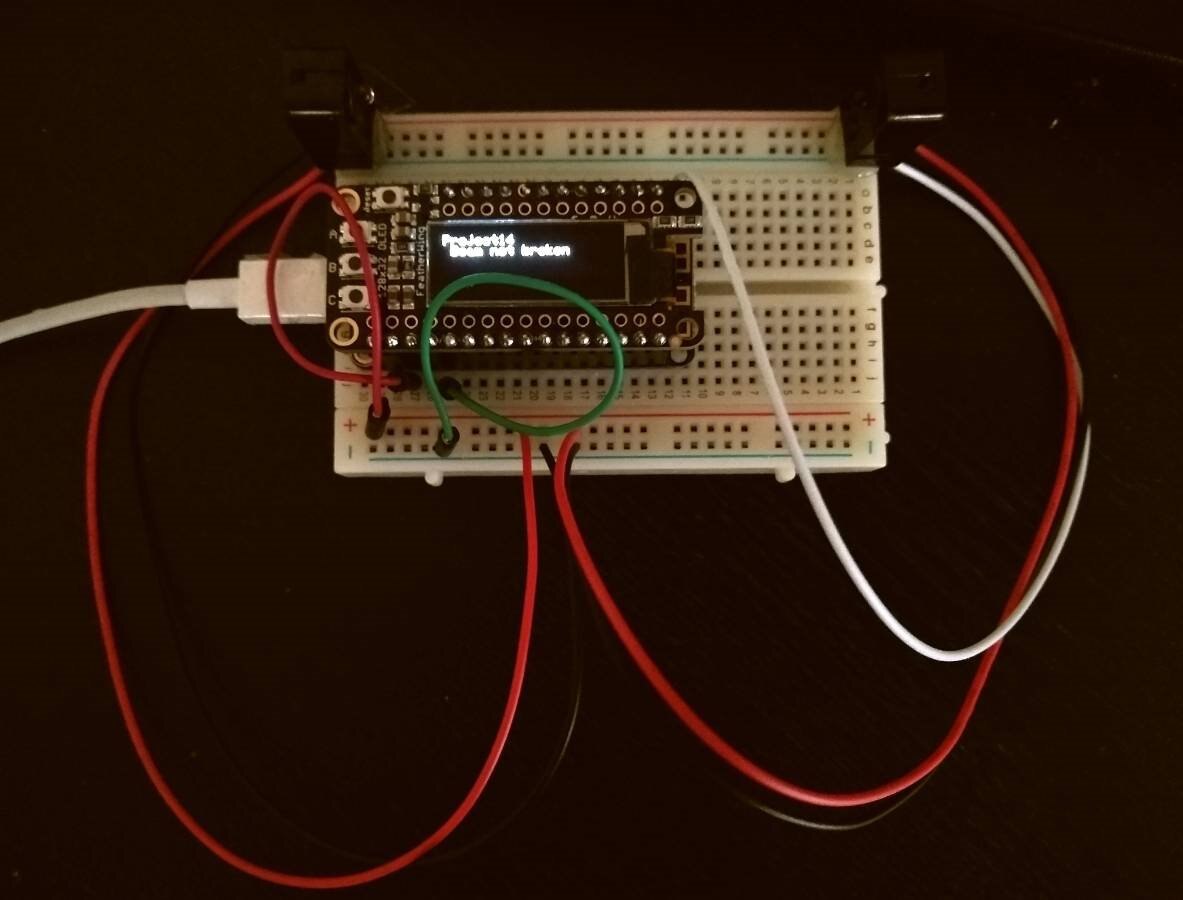

The circuit is simple, the IR break beam sensor receiver the one with the three wires is connected to the pin#4 of the ESP8266 feather. And if you wondering how I got the transmitter and receiver to point to each other, I just hot glued them to the end of the bread board.
The best part about the Adafruit Feather HUZZAH in addition to its WiFi capability, is that you can use a Lipo battery and it has a built in battery charging circuit, which means you can use the sensor node when you are out an about.In the picture above, I am using a OLED feather wing, which is not really required. I am using one because I have one handy and it help debugging , if you plan on doing something a little more complex,in the field.

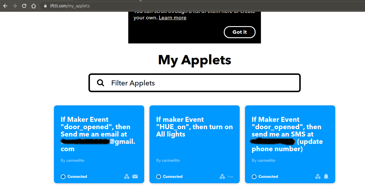

As part of the code above, a IFTTT webhook is invoked, which acts as the IF part of the applet and for the else/THEN part you can either trigger a text message, email or even switch on the lights if you have a Phillips Hue setup at home, you have a lot of option on the THEN side-

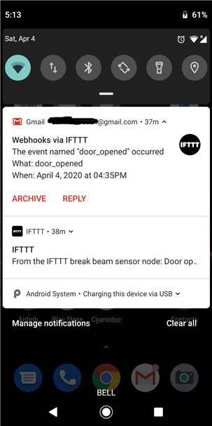

Here is are screenshots of the notifications received, from IFTTT
