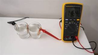

Salt water cell by kk99
During the Mixing Electronics & Water competition, kk99's idea was to create low power device with salt water cell as power supply. Here is example of salt water cell. For this he used two glass containers, two copper electrodes, and two silver electrodes. Voltage generated by these two cell was around 1.5 volt.  In its current form the salt water cell was able to generate voltage around 1.7 volt and current around 4-5 uA.  For this experiment its important to think about the proper material and shape of the electrodes.
