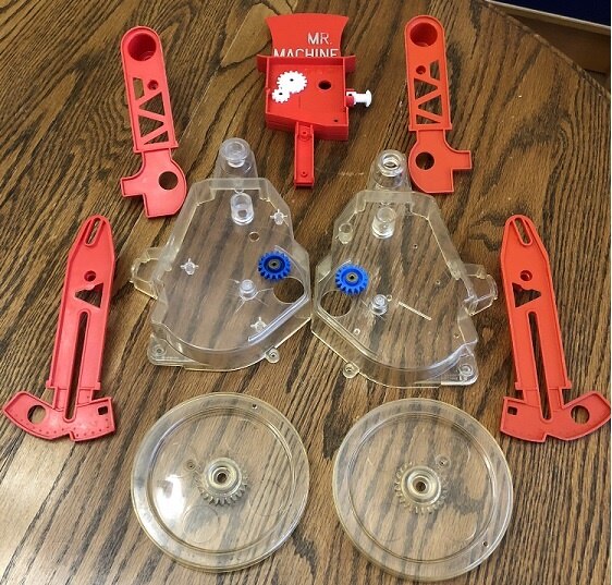

Today started with a bit of cleaning.  This version of Mr. Machine was sold in the later 1970's (starting with 1977), so it is no stretch of the imagination to say that these parts have 40+ years of dirt and grime on them (not to mention all of my recent handling - shop and office).  So today was bath time.  First I when through the collection of parts (from two host machines) and selected the best combination of parts.  In a sink full of hot, soapy water they go.  Then plenty of scrubbing (using my highly honed dish washing skills).  Here are the results:
Due to the broken arms (one on each machine), there is some differences in coloration in the arm and leg pairs.  The body and wheels also show some yellowing, but all in all not to bad for the years of play (and likely a lot of storage time).  From here I will walk through the re-assembly process, detailing the new pieces.

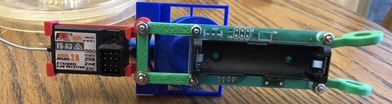

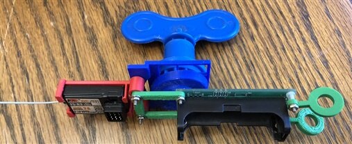

This is the key (power switch), power pack and radio holder assembly.  The key has and new 'clicker' mount that provides a simulated cranking sound, while providing attachment points for the power pack module (the larger, ring mounts attach to a boss which once held the rear wheel) and the radio holder.  The power pack PCB has a tiny microswitch mounted to the backside of the board to sense the cam lobes attached to the old winding key.  (Note: all of the PCB assembles are bare boards left over from my WalkyII robot, as my new PCBs have not arrived.  They have been shipped, but with the holiday shipping crunch it's anyone's guess if they will arrive in time for the deadline).

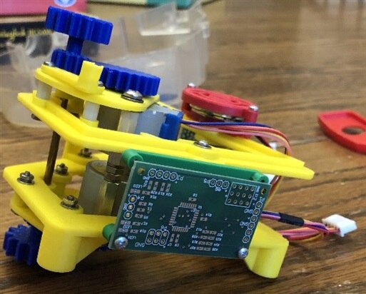

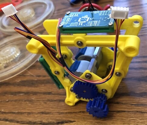

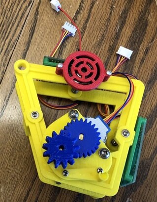

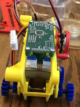

Next we have the completed skeleton/cage that holds the stepper motors, control and motor driver boards and the speaker for Mr. Machine's sound system.  Here are some pictures of those assemblies:
Newly added PCB mounts are added to the top and rear of the skeleton/cage for the control board (top) and the motor driver (rear).  A tiny speaker (with grill) is mounted to the top rail, along side of the control board.  Note:  The 'fake' motor driver PCB is actually an old version of the controller board, which is 0.1" narrower that the 'real' motor driver PCB, so it should fit just right (I hope).

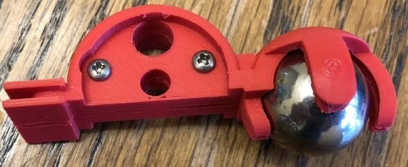

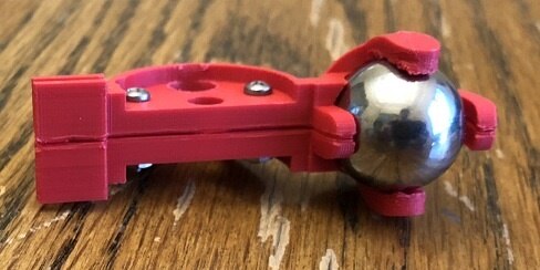

With Mr. Machine's independent stepper motors, it will now be able to turn left and right (and even spin).  This required a change to Mr. Machine's third wheel.  Instead of a simple wheel, I have opted for a free rolling cater ball.  Here are some pictures of this assembly:
The caster ball assembly is made up of two mirror image parts, that get assembled around a 0.75" metal ball bearing.  The assembly fits in the opening made for the old plastic wheel.  The caster will allow the robot to move (turn) more freely, while adding a bit of extra weight to keep Mr. Machine from falling forward.

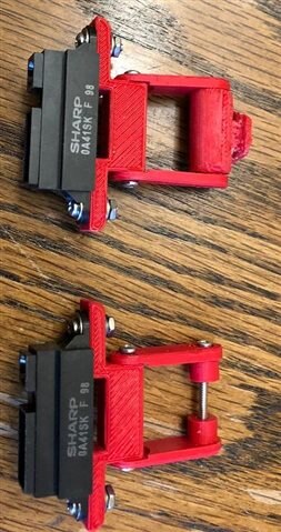

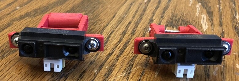

New to this project and the two I/R distance sensor assemblies, one for the front  and one for the rear.  These sensor will be used to keep Mr. Machine from running into things, off of things.  Here are some pictures of the new parts:
The front sensor uses a screw and screw button arrangement to mount in one of the joiner bosses, while the rear sensor uses a small slot cut into the two halves of Mr. Machine (just below the key switch assembly) and a pivot pint with a tab that fits into the slot.  The wires from the sensor will pass through a small hole in the parting line (not drilled yet) to route signals up the the control board.

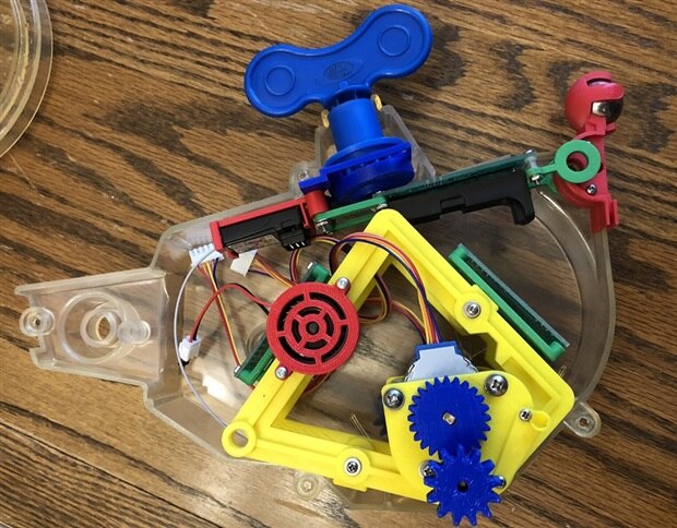

Now that we have gone through all of the pieces, let's finish putting Mr. Machine back together (I will have to take it apart several more times, but let's just see if everything fits.

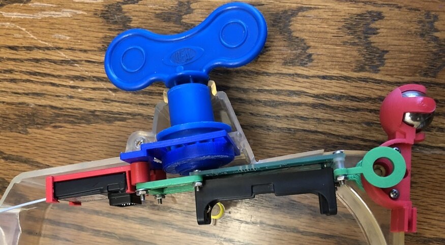

The Key/PowerPack/Radio and caster ball are installed first  (about midway on the back side of the power pack is the slot that was added to hold the read sensor mount).  The two bottom tabs of the power pack mount fit on either side of the caster ball (with a boss passing through the assembly).  The skeleton/cage slips in, around the power pack module and into the bosses in the case halves (three on one side, one and a tiny pin on the other side).  From here, the side of the case can be lowered into place (with a bit of fiddling and wiggling).

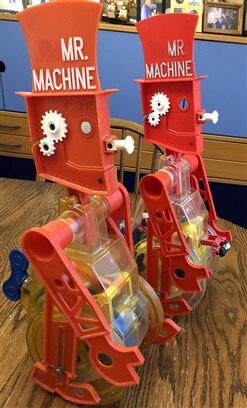

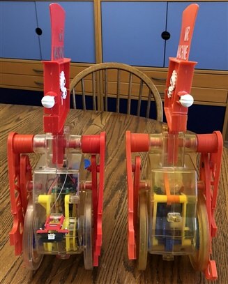

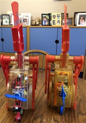

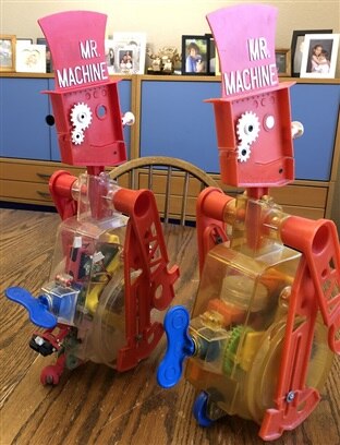

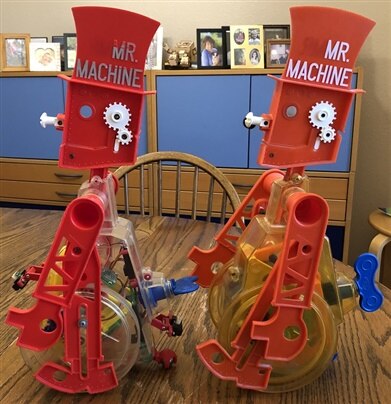

Here are some pictures for Mr. Machine (new) along side of Mr. Machine (old):
