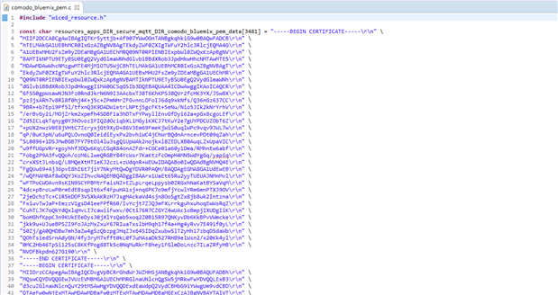

In this project I have used TLS authentication with digitally signed ibm-bluemix CA certificate. I have used the digitally signed CA certificate "comodo_bluemix.pem" of IBM cloud available at "..\STM32CubeExpansion_Cloud_WATSON_V1.0.0\Projects\Common\Bluemix" path in X-CUBE-WATSON (STM32 cube expansion package).
You can either copy it inside WICED-Studio resource folder and let the wiced studio to convertor its content into data arrays or you can open this file in any text editor and create a new array using all the data given in this file including BEGIN and END CERTIFICATE comments as shown below.
Automatically generated .c file in WICED Studio using comodo_bluemix.pem CA certificate file available in X-CUBE-WATSON STM32 cube expansion package.
For auto generated .c file for CA certificates use the following code.

Here the variable resources_apps_DIR_secure_mqtt_DIR_comodo_bluemix_pem represent the location of comodo_bluemix.pem file inside the 43xxx_Wi-Fi folder of WICED Studio (..\WICED-Studio-6.2\43xxx_Wi-Fi\resources\apps\secure_mqtt\comodo_bluemix.pem).
If you have placed this file in any other folder inside the WICED Studio then rename this variable accordingly. Always free the resources after using the TLS authentication CA certificate using the code line given below.
resource_free_readonly_buffer( &resources_apps_DIR_secure_mqtt_DIR_comodo_bluemix_pem, security.ca_cert );

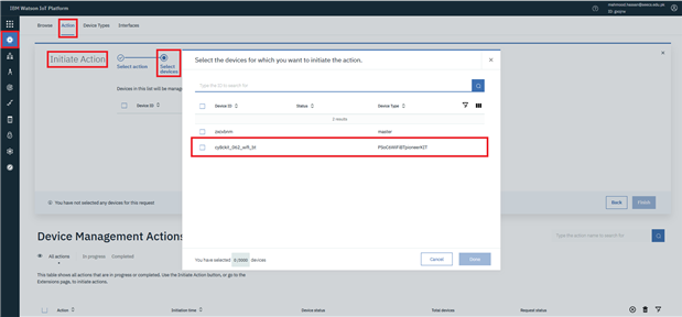

For remote management of any device connected with IBM cloud, first device need to specifically tell the cloud about its remote management capabilities by publishing the "WICED_MANNAGE_STR" at "WICED_MANAGE_TOPIC". After successfully publishing the device remote management capabilities at IBM cloud server the device will appear under "Device Management Actions" below.
To check if remote device management go to =>Devices=>Action=> Initiate Action=> select action=>select device=>Add devices=>YOUR MANAGED DEVICE
For more detail about remote device management visit MQTT connectivity for devices and Device management requests.

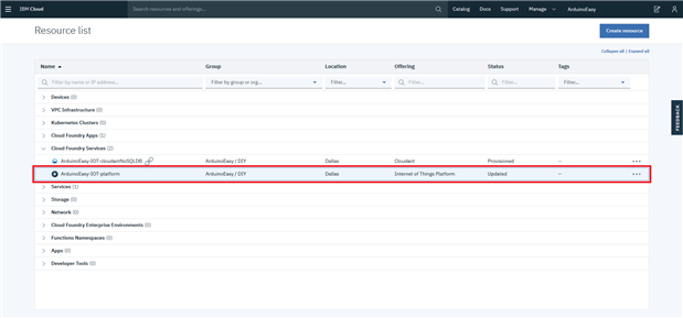

IBM Cloud configuration:

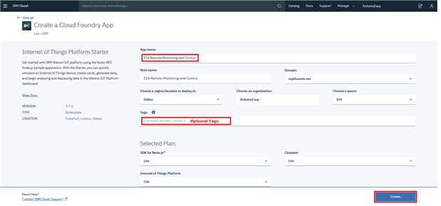

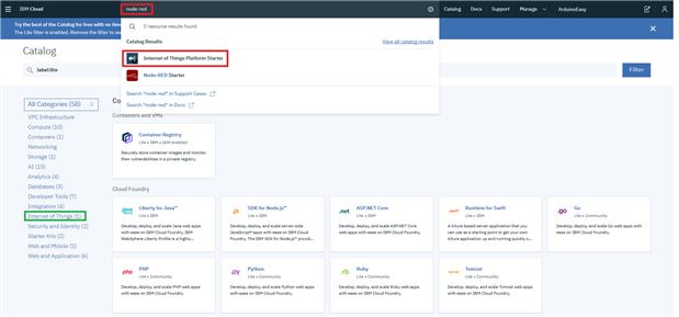

After creating a free account on IBM cloud search for node-red in search box (Important: here dash between node and red is important otherwise it will not show the result as shown below)

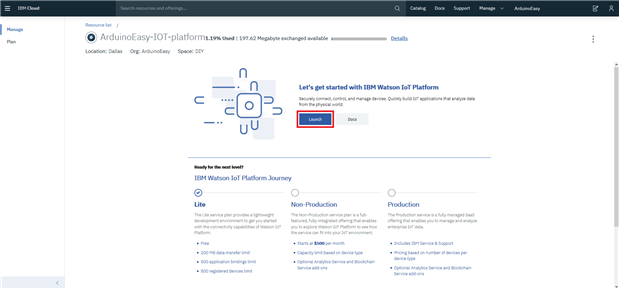

Create Internet of things platform starter using IBM cloud.
We can also choose internet of things options from Categories but it will require several additional configuration to enable real time data and event storage with remote device control. This option will automatically configure everything required for our project. Choose the appropriate name for the IBM cloud foundry app and create it as shown below.
It will take few minute to setup. After successful setup launch the IOT platform as shown below:

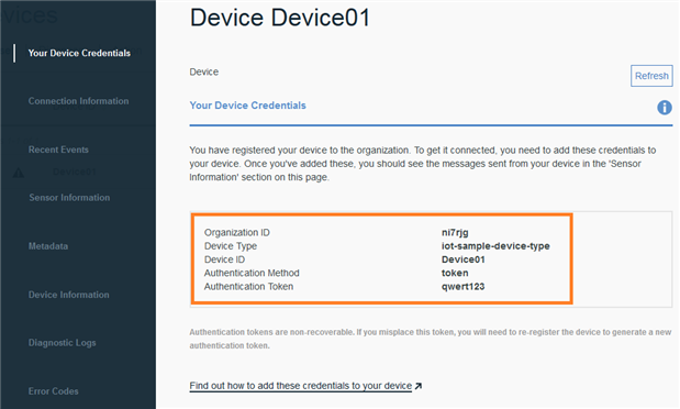

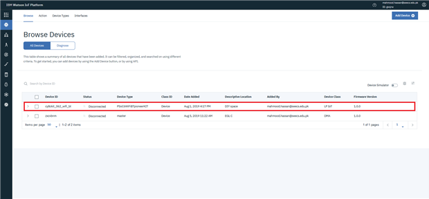

After launching IBM bluemix IOT platform our first step will be Add Device. All the steps required to add a new device are shown and explained in detail in this How to register Device in IBM IOT? tutorial. Only follow the steps 3 and 4 even though its based on old version of IBM iot platform but it will not be difficult. Or you can also follow the IOT platform getting started tutorial for adding a new device.
After adding a new device the device credential shown in last step are very important. Kindly take a print screen or save these values somewhere safe because these contain the device authentication token and you can not view or change it after this step.
source: IBM How to register device with IOT platform tutorial
Newly added device will appear in landing page of Devices in IBM bluemix as shown below.
PSoC6 device is added successfully in IBM IOT platform.

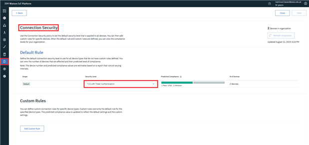

If you don't have any type CA certificate and want to use insecure MQTT communication then go to security => Connection Security => change the default security level to TLS optional. But in this project we will be using default connection security level of TLS with token authentication as shown below.
Connection settings used in this project to ensure only secure access to our cloud network.

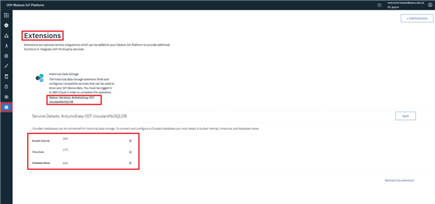

In the last step we will enable the storage database connected with IOT platform to record all the recevied data. To do this go to extensions window and configure the cloudentNOSQLDB externsion already connected with our IOT platform. the basic setting for this extension are given below. you can change these setting according to your requirements.
Cloudant NOSQL database settings used in this project to save all the received data automatically based on these settings.
