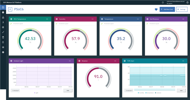

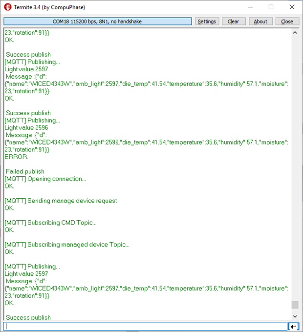

Finally I am able to interface all the sensors and successfully transmit all the data to the IBM IoT platform. There is definitely some room for improvement especially in selection of sensors etc. Currently, Instead of completely reinstalling the firmware I have used two specific locations in external flash to store the different constants, including WiFi credential and only one copy is replaced during update firmware request. And when factory reset request is received the other copy of initial data replace the newly added data.

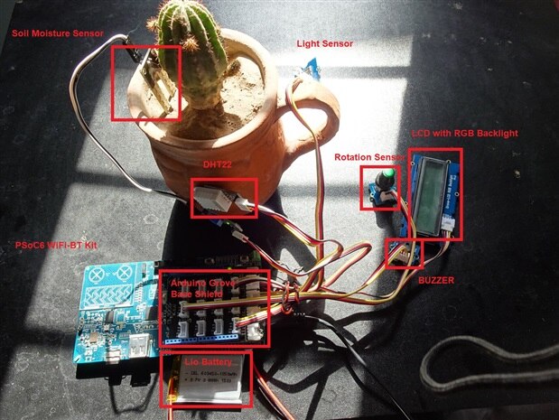

Hardware Used:
  • PSoC6 WiFi BT kit
  • Grove Base Shield for Arduino
  • Grove Light Sensor
  • Grove Rotation Sensor
  • Grove LCD with RGB backlight
  • Grove Buzzer
  • Soil Moisture senor
  • DHT22
  • Li-Ion battery for remote operation

The Final Interface with some gauges and charts.

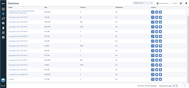

Real Time could storage of all the incoming data for later use.
