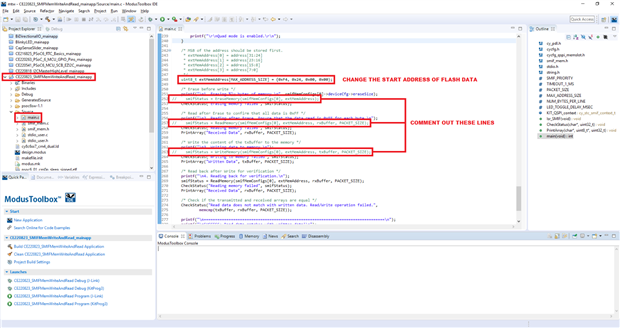

Modified Modus Toolbox Code:
Download the External flash example for modus toolbox from link given at the END. Open the project in modustool box and modify few code lines as shown below.
Modify the address as shown below;
uint8_t extMemAddress[MAX_ADDRESS_SIZE] = {0xF4, 0x24, 0x00, 0x00};
This code will be used to verify the earlier stored data. This address is choosen to make sure that reprogramming using WICED Studio does not effect it.
After running the Flash testing code created in WICED Studio, we will reprogram the PSoC6 device with some other program and then use this code to read the earlier saved flash data.
