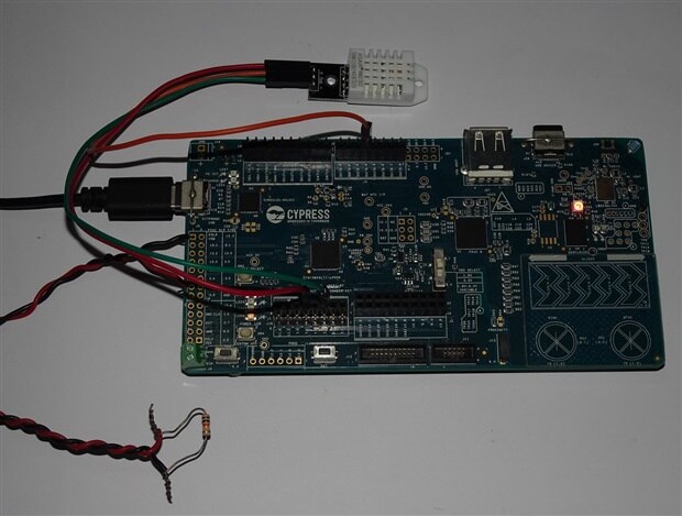

Hardware Required:
  • PSoC 6 (CY8CKIT-062) WiFi-BT Kit
  • DHT sesnor (using DHT22)
  • Wires to connect DHT sensor with PSoC kit
DHT22 senor connected at P5.4 (D4 of Arduino header) of PSoC62 Kit
If you are wondering about the other wire with a resistor then it is used to avoid burst of random data appearing at Com port during programming or when PSoC6 UART module (P5.1) connected to KitProg, is not initialized or used.
