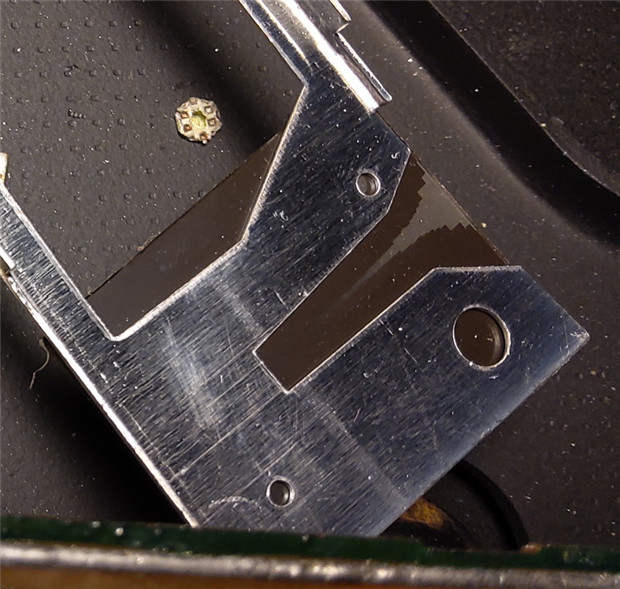

Auto Switch-Off LDR
The auto switch-off doesn't work. It's part of the start / stop circuit of the turntable.
The LDR is mounted under a light bulb that's always on when the TT is powered.
When the arm reaches the end of the record, an optical filter blocks the light reaching the LDR, and changes its resistance.
If you look at the optical filter, you'll notice that it has a funnel-form light lock.
This is a nifty trick. The filter moves very slow over the LDR. A groove per turn.
But because the filter narrows exponential, and there's a high-pass filter after the circuit, the table will only switch off when the narrow part of the filter is reached.

The circuit is held in that state until either the STOP capacitive touch button is used, or the LDR brings TS425 out of conduction.
I knew that the stop circuit works, because the capacitive circuit works. The LDR stop doesn't though.
