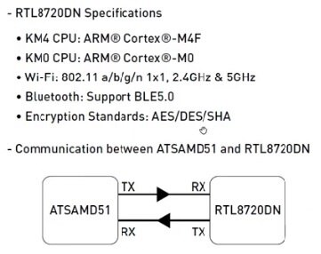

The firmware update is for the RTL8720DN WiFi/BLE chip so the process is interesting.  You can't communicate directly with the RTL8720 so you need to do it through the main ATSAMD51 processor.  The RTL8720DN has two MCUs so there are binary files included for both of them.  There is an Arduino program that is uploaded to the Wio Terminal to establish communication from the PC to the ATSAMD51 and then via UART to the RTL8720DN.  Then you need to run another program on the PC to erase/program the firmware over that communication channel.  A little clunky but it works well.

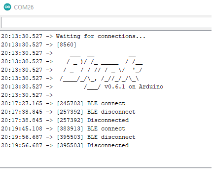

My Wio_Terminal_Blynk_Temperature program was then working properly.  Unfortunately, my BLE program was still having problems.  It would connect to the Android tablet and then immediately disconnect.
I ran some other non-Blynk BLE programs that use the nRF Connect app (iBeacon and BLE_UART) and those were working so the BLE connection was okay.  I tried new authorization tokens but just couldn't figure it out.  In desperation I tried running Blynk on my iPad - and voila - it worked!  No idea what's not working on the Android tablet (running Android 8.1) but for now I'll just demo the NeoPixel program using the iPad.

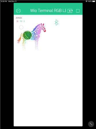

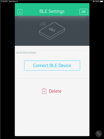

Blynk NeoPixel Control over BLE

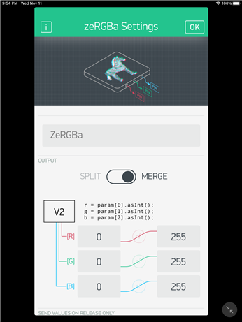

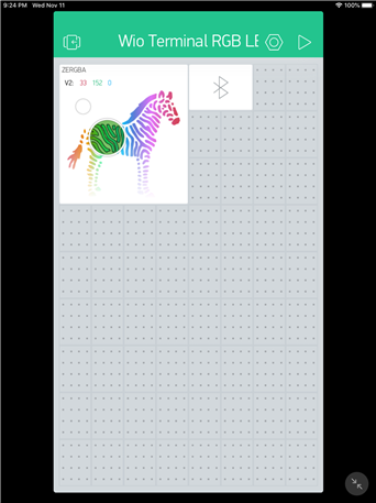

This example program uses the zeRGBa widget in Blynk which is a multi-colored zebra to send RGB values to the Wio Terminal based on where the selector is positioned on the zebra.  In the output merge mode of the widget the RGB values are sent to a single virtual pin as a 3 parameter array over BLE.

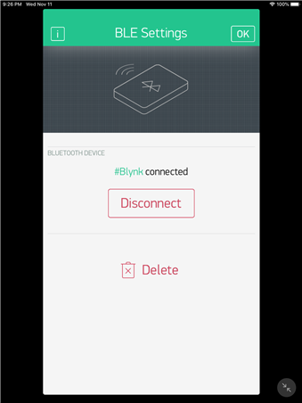

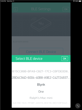

On the project screen select the Bluetooth icon to connect
Select the Blynk device which is the Wio Terminal
On the Wio Terminal the parameter array is used to program both the NeoPixel strip and the LCD color using the following program:
Wio_Terminal_Blynk_NeoPixel.ino

Once the program is uploaded press the run button in the app and a selection circle appears on the zebra.
Here is a short video showing the color changing as the selection circle is moved.
