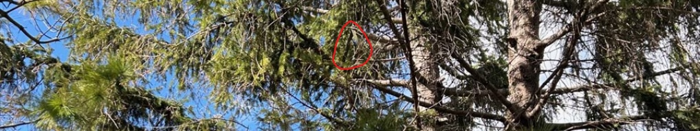

    Here is a picture of the antenna in use today.
    For those that enjoy a challenge, here is a picture with a bit less zoom.  Can you find it?
    Even once you see it, it's hard to see it. Relaxed

    beacon_dave over 1 year ago in reply to kmikemoo
    Not sure about the fox but I think we do have a tree climbing monkey in the vicinity
  • kmikemoo
    kmikemoo over 1 year ago in reply to beacon_dave
    beacon_dave Great job!  On the first hunt I hosted, I did climb a tree.  My wife was not thrilled.  She made me bring a ladder on the next one.  I did that for a couple more, but those collapsible ladders aren't exactly light.  That's when I broke down and bought a telescoping painters pole.  After about 2 years of supervising me hiding the fox - and promising not to climb any more trees, she has finally allowed me to go out on my own.
