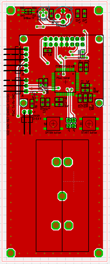

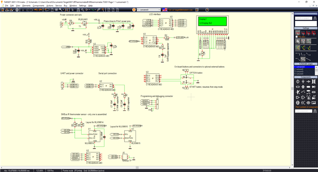

First of all, here is the schematics. I wanted to make it more pretty this time, because the last one was just a wiring mess.

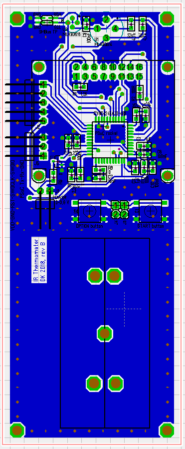

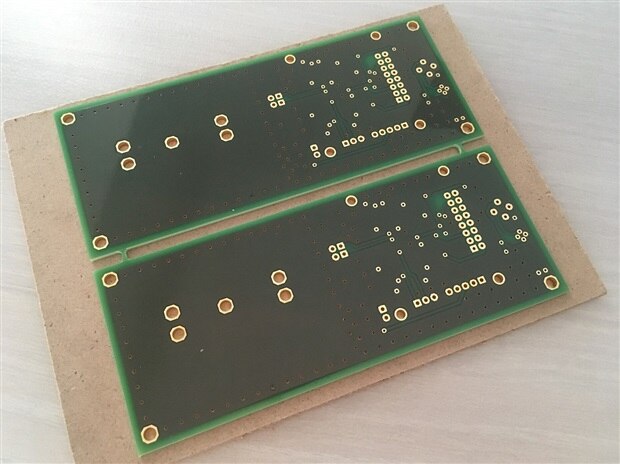

The schematics was then translated into a completely new PCB design.
What is new
  • Mounting holes in the corners. I haven't decided yet, whether to make my own box or use an existing one (at this point I guess the choice is limited, so I will have to somehow create something myself).
  • Place for battery pack holder with mounting holes.
  • Removed unnecessary LED from the first revision.
  • PCB adjusted for using one or even two thermometer sensors at a time (they have different SMBus address).
  • Design is more "remote control" like to fit better in the hand.
  • Display 8x2 characters instead of 16x2.
  • Debug connector for SMBus, just to have the possibility to externally debug the bus.
  • All capacitors and resistors are 0805 size.
  • Ground planes on both copper top and bottom layers. Connected using many vias.
  • Better filtering capacitors PCB layout to eliminate ground loops.

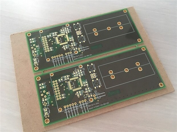

PCB
After a week, the PCBs were ready. Quite different than the first one, don't you think?

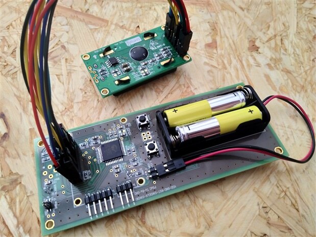

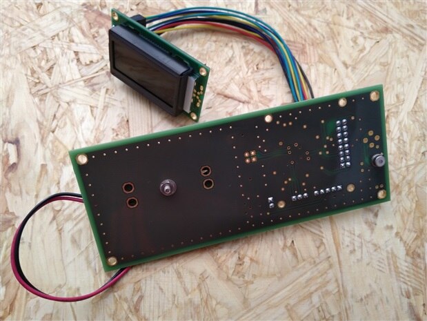

This is what the thermometer looks like after the assembly:
Demonstration video
What currently works is only the ambient temperature measurement (second line of the 8x2 character LCD). That is why I added the Sensirion thermometer for comparison.
The object temperature (first line of the LCD) is OK, but the emissivity is set to a not meaningful value of 0,09. Changing the emissivity doesn't work yet. The API is finished, however, I am struggling with the button control functions (described below).

  • I chose an impossible to obtain LCD. There are two types of LCD in the 8x2 characters format. They either have a connector above the LCD, or on the side. I had the first type lying in my component box, so I decided to use it. However, this type doesn't have the charge pump (I need to use a 3,3 V version) if you want to buy the LCD from official distributors. My LCD was some garbage bought from China on eBay. I have to buy a different LCD in the other format and use wires instead of a connector.
  • Second, I used a component symbol and footprint in the CAD program drawn by some user. Even if I got the LCD in the format I needed, the mounting holes were shifted a few millimeters, so I could mount the LCD in 1 or 2 stands of 4. All the LCDs have exactly the same format, so the person that drew it didn't bother to try it or delete it after finding out that is doesn't fit. Next time, I will draw the components myself, as almost all engineers do.

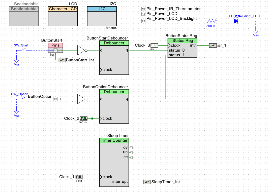

Help needed
  • I am currently stuck and not sure, how to deal with the button controls. Here is the current situation: the buttons are not debounced in HW. Also, an interrupt is needed to wake up from the stop mode. In addition to that, I use button interrupt to for waking from the 5 seconds sleep mode before entering the stop mode. More about the firmware state machine is here: "No lies" IR Thermometer - part III , the diagram makes it pretty clear (I believe).
  • PSoC offers a Debounce button component, but of course the interrupt input cannot be debounced. It doesn't matter for "wake up from stop mode", but it does in waking up from the "wake up from 5 second sleep" mode.
  • Should the buttons react to the button press, or perform something after the button release? Is it a good idea to use the button interrupt at all? Maybe I could set a periodic timer and debounce the buttons every time the code enters the interrupt (I don't mean waiting to debounce, but just checking how much time passed since the last interrupt or something similar).
  • I mixed functionality that needs interrupts and debounced buttons and just struggle to get away. The rest of the functionality (emissivity changing etc. is ready and working).
Here is one variant of my work in progress PSoC ideas:
Thank you for reading. Any help is appreciated.

    Hi David,
    This is a very professional build and great write up - well done.
    I'm not sure if you could implement this, but on microcontrollers I sometimes generate a small interrupt ticker that can be used for timings and debounce - in the interrupt routine all the separate peripherals (like switches, longer term timers etc are all decremented and flags set should they reach zero). Back in the main FSM loop I check those flags and action accordingly. That way the processor doesn't pause when I'm debouncing in SW.
    Rod
