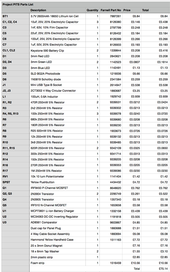

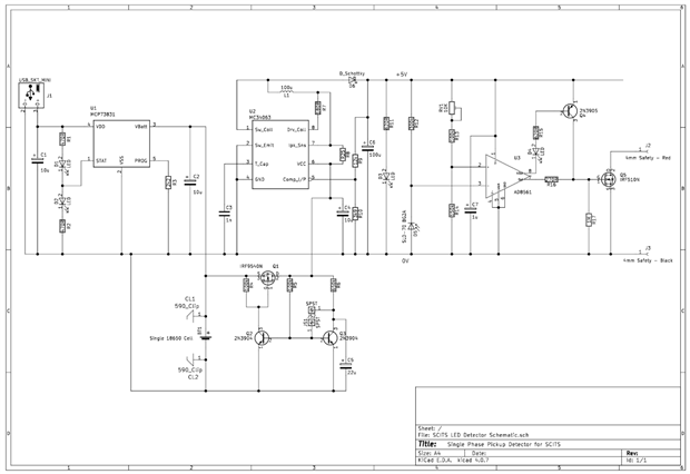

Since deciding that the best place for the on / off switch was between the charger and the boost circuit, the pre-manufactured board could not be utilised. The circuit has therefore been expanded utilising a MCP73831 charger integrated circuit from Microchip and a MC34063 for On Semiconductors to build up the boost circuit to convert the 3.7V from the 18650 cell to the required 5V.

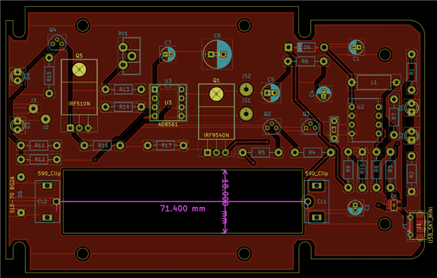

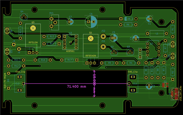

This has created a much larger parts list as seen above, now giving a total parts cost of just over £75.00. The only major part missing from the cost now will be the cost of the PCB. Given the increase in components, the PCB has substantially changed but I have still managed to keep it within the case size.
Front Copper Layout
Rear Copper Layout

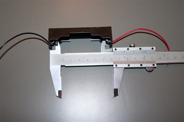

At the front, the board has been shortened to give room for the push button and 4 way socket that will be used to make connections to both the photodiode and the injection test set.
I am wondering If I should have a complete cutout of the copper around the whole of the battery positive clip as appose to just around the solder pads.
The battery clips themselves  have been positioned on the PCB utilising measurements from a manufactured battery holder, to get the correct tension on the spring clips. A couple of concerns are surrounding the connections to the USB socket and whether or not a copper track should be run up to the negative battery clip from this. I am also wondering if I should look at fusing  from the positive battery clip to the outgoing circuit and incoming from the charger. I am just wary of the power capability within the lithium ion cells and looking to prevent potential issues in the event of faults occurring.

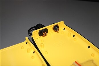

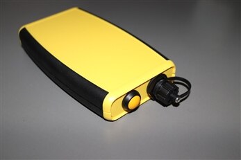

Practically, not much has moved on. The 4 way connector and on / off switch have been mounted into the front of the case. I will need to drill holes for the LEDs and cut out for the USB connector, but this will not be done until I have a PCB to confirm the positioning.

    Found the problem for the keep out area, The 'no copper pour' option is deselected by default, so selecting that removed the copper from the area.

    Donald,
    OK, the modified circuit does make a bit more sense now.  I am not sure that the gate voltage is a part of your problem, as you did initially turn on the MOSFET. The extremely low collector current (~7.5uA) might be keeping the Vce of Q3 from keeping the voltage on C5 low enough to turn off the Q2 (which in  turn shuts off Q1 MOSFET).  You can verify this by measuring the voltage on C5 while the MOSFET is on (the voltage should be less than 0.65V or Vbe).
    Looking around, I found a similar circuit might work a bit better.  Here the timing cap (C1) is low when the circuit is off and high when on.  This better much insures that you should be able to turn off.  (I am a little concerned that it might take a bit of time for the cap to discharge enough to properly turn the circuit back on)

    I have tried testing the soft latch circuit over this weekend and haven't had much success.
    Initially, I found an error in my original circuit. The connection to the 650k resistor (R6) needed to come from the live battery feed and not the switched feed of the mosfet. With that corrected, I had minor success of being able to switch it on but, I could not get it to switch off.
    I tried a number of variations of the circuit available from the EEVblog and the comments surrounding it, but did not have total success with any of them. Some options I couldn't try due to my minimal collection of components to test with.
    There were some comments about the circuit, that high capacitance loads would prevent the power from being switched off, not sure if that applies to my circuit though.
    I will now start to look at the MAX16054 controller, that can do the soft latch, but will need to order a DIP adapter for it before I can use it on the breadboard. I think I will also look for a mosfet with a lower gate voltage to get a better switching action.
