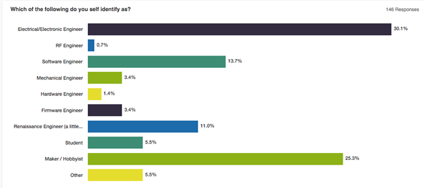

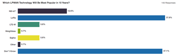

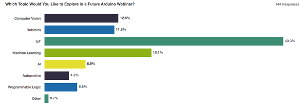

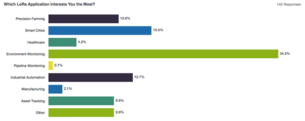

Survey Results:
{gallery} My Gallery Title
