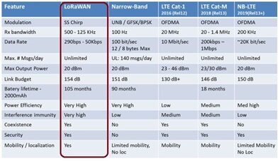

On June 10th, 2020 at 11 AM CT //  4 PM GMT:   Andrea Richetta,  Head of the Pro /IoT Market will take us on an LPWAN Journey where LoRa Meets Arduino:
  • LoRa Meets Arduino, a Journey in the LPWAN World
Buy NowBuy Now
Buy NowBuy Now
Download Tech Specs, Pinout, Eagle Files, and Schematics Below!

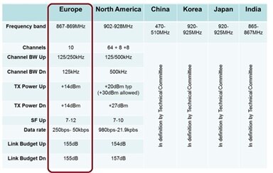

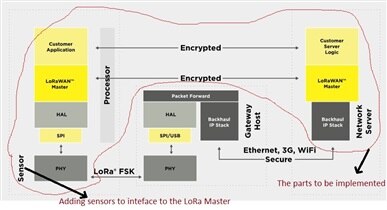

During this webinar,  Andrea Richetta, head of the Pro/IoT market at Arduino will give an overview of the LPWAN world, focusing on LoRa and the available solutions from Arduino.  You’ll learn how to create a complete end to end solution using Arduino hardware (boards, shields and a gateway) and the Arduino IoT Cloud.  We will be giving away a pair of MKR WAN 1310 boards to 5 attendees who ask the best questions.  The MKR WAN 1310, brings in a series of improvements when compared to its predecessor, the MKR WAN 1300. While still based on the MicrochipRegistered SAMD21 low power processor, the Murata CMWX1ZZABZ LoRaRegistered module, and the MKR family’s characteristic crypto chip (the ECC508), the MKR WAN 1310 includes a new battery charger, a 2MByte SPI Flash, and improved control of the board’s power consumption.  Additionally,  Arduino will be offering Arduino branded swag such as T-shirts, hoodies, and possibly mugs!
There are several ways you can connect using this board: the Arduino IoT Cloud, your own LoRaRegistered network using the Arduino LoRaRegistered PRO Gateway, existing LoRaWANTm infrastructure like The Things Network, or even other boards using the direct connectivity mode.  In the past, most members have opted to use two boards, whether it was through the Smarter World competition or through the roadtest that we are currently doing:

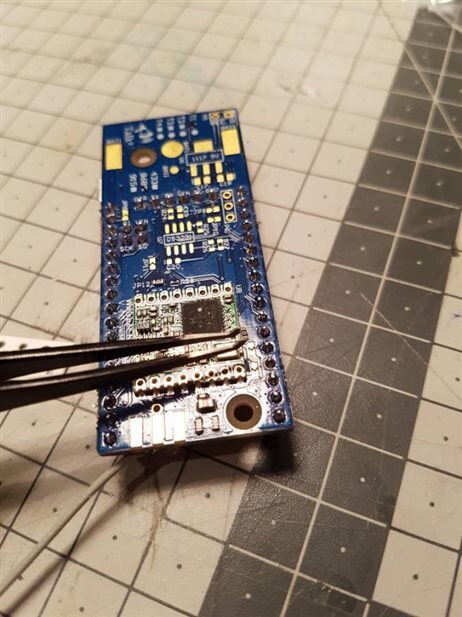

The new battery charger, a 2MByte SPI Flash, and power consumption should be of interest to fans of the MKR 1300.
Improved Battery Power
The latest modifications have considerably improved the battery life on the MKR WAN 1310. When properly configured, the power consumption is now as low as 104uA! It is also possible to use the USB port to supply power (5V) to the board; run the board with or without batteries - the choice is yours.
On-board Storage
Data logging and other OTA (Over The Air) functions are now possible since the inclusion of the on board 2MByte Flash. This new exciting feature will let you transfer configuration files from the infrastructure onto the board, create your own scripting commands, or simply store data locally to send it whenever the connectivity is best. Whilst the MKR WAN 1310’s crypto chip adds further security by storing credentials & certificates in the embedded secure element. These features make it the perfect IoT node and building block for low-power wide-area IoT devices.

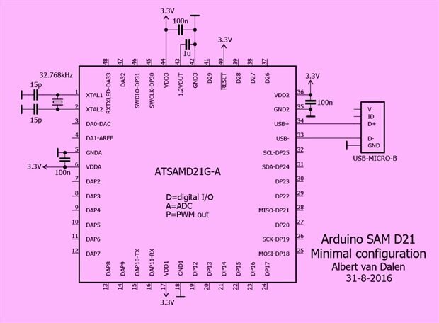

It features a Microchip AT SAMD21, 48 Mhz 32 bit MO+ ARM Cortex low power processor. Its the same SAMD21 as the MKR 1000, MKR Zero, and Arduino/Genuino Zero boards.

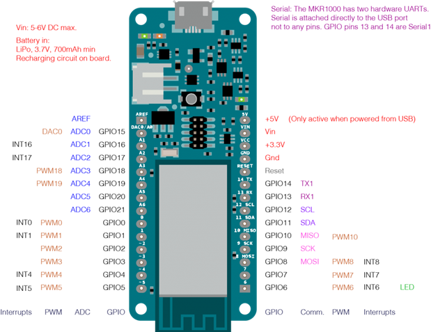

The Arduino MKR 1300 uses the same pin mapping as the MRK 1000:
Power Pins:

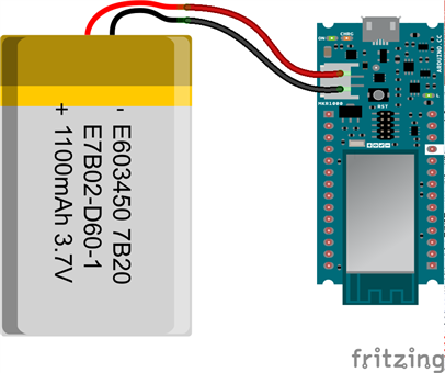

  • Li-Po (3.7V) - You can power the board by connecting a Lithium polymer battery (shown to the right) with a nominal voltage of 3.7.
  • Vin - The board can be powered by a regulated 5V supply with a maximum voltage of 6V for this Pin.
  • 5V - When the board is powered by USB, you can use this pin get +5V to power other circuit
  • Vcc - This pin uses the on board regulator IC to output a regulated 3.3V
  • GND - Ground Pins
Reset Pin - Bring this line LOW to reset the microcontroller. Typically used to add a reset button to shields which block the one on the board.
Analog Pins (Pins A0-A06) - The 7 analog pins are used to emasure analog voltage in the range 0- 3.3V with a resolution of 10 bit.
DAC0 Pin - The DAC pin is just above the Analog Pins and is used provide an analog voltage based in the digital input with a resolution of 10bit.
Digital I/O Pins (Pins 0-14) - Below the analog pins on the left and just below the reset are digital pins that can be used as either input or output pins.  Low is at 0V and high is at 3.3V.
Serial Rx, Tx Pins (Pins 13, 14) - Pins 13 and 14 are used to Receive (Rx) and Transmit (Tx) TTL serial data. These pins are connected to the corresponding pins of the FTDI USB-to-TTL serial chip.
External Interrupts (Pins 0,1, 4, 5,6, 7, 8, A1, A4) - These pins can be used to trigger an interrupt on a low value, a rising or falling edge, or a change in value. See attachInterrupt()function for details.
PWM Pins (Pins 0, 1, 2, 3, 4, 5, 6, 7, 8, 10, A3, A4) - These pins provide 8-bit PWM output with the analogWrite () function.
SPI (Pin 8 - MOSI, Pin 9 - SCK, Pin 10 - MISO) -  These pins support SPI Communication
LED - There is a built-in LED connected to digital pin 13. When the pin is HIGH value, the LED is on, when the pin is LOW, it's off.
I2C Pins (Pin 11 is SDA and Pin 12 is SCL) -  Pin 11 (SDA) and Pin 12(SCL)  support I2C (TWI) communication using the Wire library (documentation on the Wiring website).
AREF Pin - Reference voltage for the analog inputs. Used with analogReference().

ATSAMD21G18A Overview
ArchitectureARM Cortex-MO+
Voltage Range1.62-3.63V
Bus Size32-Bit
Max CPU Speed48MHz
Internal Oscillator21khz, 23Khz ULP, 8Mhz
Program Memory Size256KB
SRAM32KB
EEPROM32KB (emulated from Flash)
GPIO38
ADC Channels14
ADC Resolution12-bit
Digital-to-Analog Converter (DAC)Yes
USB ControllerYes
Direct Memory Access (DMA)12 Channel
Peripheral Touch ControllerYes
Inter-IC Sound 12SYes

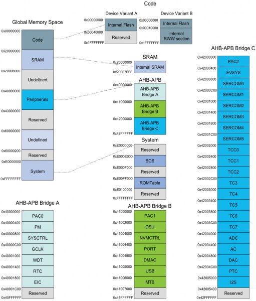

32 bits, 48 Mhz
The 32 bit architecture allows you to process your instructions faster at double the speed of an 8-bit AVR. While the AVR must process data in 8-bit, the 32-bit architecture allows the SAMD21G to process data in one large chunk.
Memory Map:
USB Controller
Like the ATmega32U4 used on the Leonardo, ATSAMD21 comes with an integrated USB controller, allowing it to be used as either a USB device or host. In device mode it configures itself as a USB CDC (communication device class) so that your computer talks to it as if it were a serial port. This allows the SAMD21 to emulate a mouse, keyboard, or controller, and also work as a mass flash storage.  If used as a USB host it can connect to keyboard or mouse, as well as, save data to a USB flash drive.  However, to act as a host requires extra power supply.
Real-Time Clock
The SAMD21 has a separate real time clock (RTC), powered by an on board 32.78 crystal, that runs at a full 48 MHz.  Also, almost every pin is tied to timer-counter, giving you a lot more PWM-capable I/O pins so you'll have plenty of options for dimming lights or controlling motors.

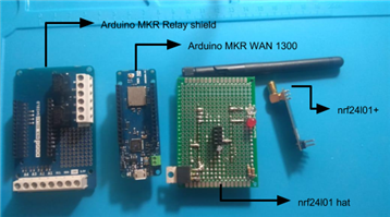

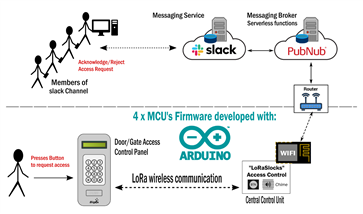

Communal-based Access Control using an Arduino MKR 1300 WAN by BigG
  • Smarter Access Control using Arduino MKR WAN 1300 boards
  • Communal-based Access Control using Arduino MKR WAN 1300
The design approach was to split the project into two phases. Phase 1 Smarter Access Control using Arduino MKR WAN 1300 boards, was to develop and test a standalone system using just LoRa between the access panel and the central control panel. Phase 2 Communal-based Access Control using Arduino MKR WAN 1300  took the phase 1 design and expand the functionality by adding in the Internet gateway to allow for communal based access-control. It will also include some BLE functionality to allow for the possibility of configuration control and another user interface.

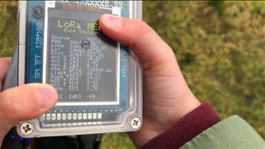

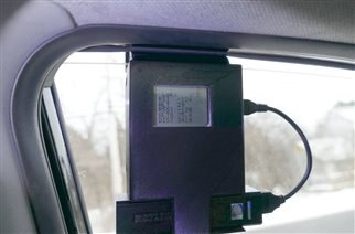

LoRa GeLo MKR - Long Range Geo-Locator MKR 1300 by dougw :
The plan was to build the MKR 1300 into a platform with a set of useful interfaces that allow it to be adapted to many applications.
The core interfaces:
  • a LoRa radio to enable low cost long range communications
  • a GPS receiver (with UART interface) to track the location of the system and provide an accurate time
  • a low-power SPI LCD to display graphics and text
  • an I2C Grove interface to connect any serial Grove module
  • 2 analog Grove interfaces to connect any analog Grove sensors
  • a digital Grove interface to connect any digital grove module
These interfaces and connectors were implemented on a custom PCB that results in a clean compact system platform.  Application systems were packaged in 3D printed cases tailored to accommodate the necessary features.The first application, which is the subject of this project, was a geo-locator system that can send GPS location data to a LoRa gateway.This system will initially be used to explore the reach of the LoRa radio.Some of the applications. Where you would use the geo-location capability include:
  • If you generally don't have your cell phone turned on, this may be used to show where you are or where my car is.
  • It could be used to show when you are arriving home.
  • It can show how far away your ride is when you are being picked up after work.
  • It could be used to tell you to turn your cell phone on and take it out of airplane mode.
The range of the radio will dictate which applications can be useful or how useful they will be.
Part of this initial project was to explore ways to maximize range of the radio.

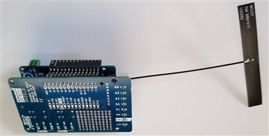

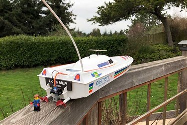

MKR WAN 1300: LoRa Marine Environmental Ranger
  • Week 1: Making it Portable
  • LoRa MER Week 2: Boat in a Box
  • LoRa MER Week 3: Building a Shore Station and Starting the Boat
  • LoRa MER Week 3.5: Testing Turbidity and Posting Data to Internet
  • LoRa MER Week 4: Boat Afloat and New Antenna
  • LoRa MER Week 5: Indoor Testing
  • Week 6: First Sea Trials
  • Week 7: Concept Demonstration

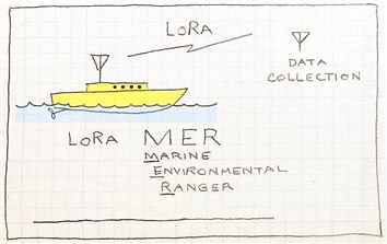

The LoRa Marine Environmental Ranger (LoRa MER) is a demonstration project using the Arduino MKR WAN 1300 to gather and assess environmental data in an aquatic environment.
With the advances in inexpensive microcontrollers, sensors, and low powered long range radio it is now possible to gather environmental data more easily and with less cost than ever before.  Open water being less sparsely instrumented than much of the land mass provides an opportunity for new study.  The near shore and inland waters are of particular interest in that they are susceptible to human activities and important to marine life.  This project makes use of the long range, low power wireless capabilities of LoRa to study this environment.
The prototype described here is housed in a radio controlled boat.  However, the platform can be modified to meet different requirements:
  • Stationary Buoy - Moored buoy to continuously monitor a location
  • Floating Buoy - Free moving platform to study currents or wind
  • Autonomous or Semi-Autonomous Boat - Boat with programmed route or even decision making capability
  • Radio Controlled Boat - Operator controlled boat

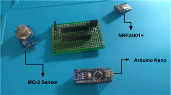

Arduino MKR WAN 1300 ---- Blog 1 Idea by snidhi:

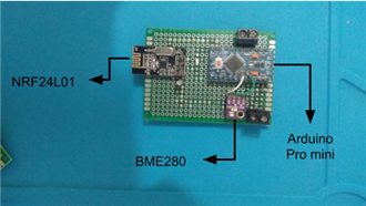

snidhi 's idea was to give the LoRa capability to my old project The SolarBot (Simple Solar BOT  ----Finale ) and read the sensor data via LoRa. Another option was to control the SolarBot via LoRa Connectivity and I want to check out if this works without a lag in real-time. Then one can control the SolarBot remotely via Lora and it can be used to send the BOT in hazardous conditions and measure data such as gas leaks, temperature, humidity.

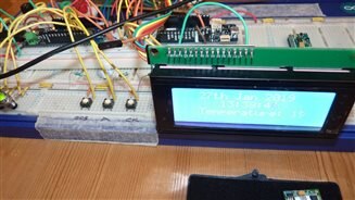

Smart Little/Special Child Safety Watch by mahmood.hassan:
  • tinyMonster - Smart watch for kids with SOS and RT Tracker
We all have little kids in our homes and every parent want to make sure that their kids are safe whenever they go outside of their homes. At the same time we also have little kids in our homes or around us how are special or little enough so they cant remember home address or their way back to home if they accidentally leave home and go little far away. And its very tough situations for parents if they cant find their little/special(mentally unstable etc) kids. Also if kids are in any sort of bad situation every parent want to help them but if they don't have any means to call for help or they don't have cell phone or unable to use it then there is no way to help/protect them.
To solve such issues long range of LORA module come into play. Design and built a smart watch using Arduino MKR 1300 equipped with GPS for the kids. And Other MKR module at home connected with display and alarm. Also internet connectivity is a plus point. Parent can set a Geo fence for the kids so whenever they go beyond that area it can alert the parents with there live Geo location. Also kids can alert their parent about any emergency/dangerous situation by simply pushing a button. Biggest advantage of using MKR module over GSM based is cost effectiveness and low power consumption. To built a Smart community we can also add multiple control modules at different public places and connect all these to one main server. In case of emergency MKR can connect to any of the available control module and alert their parent or law enforcement for timely action and to take preventive measures.
This is a really great project that was done during the Remote Monitoring & Control competition in Project14:

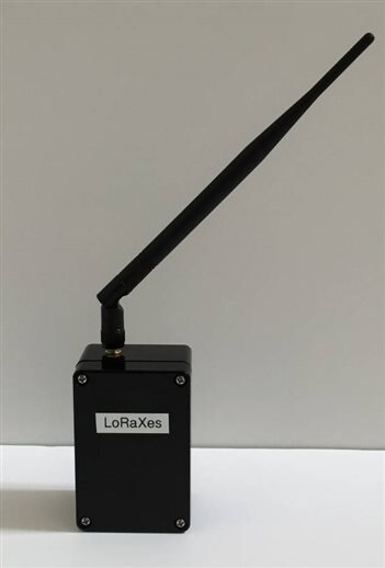

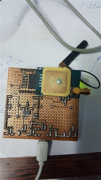

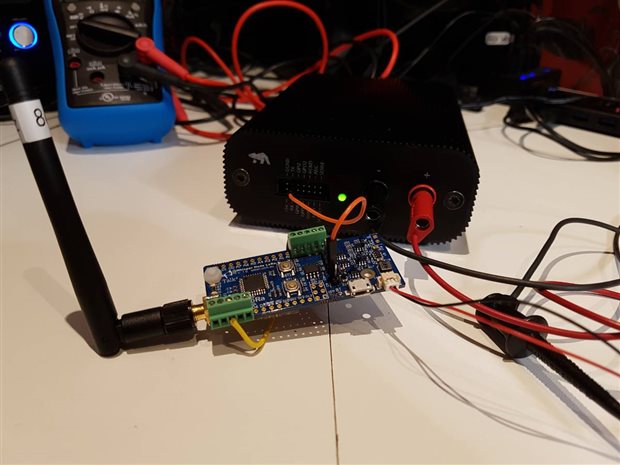

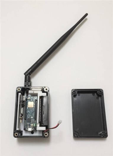

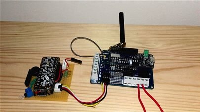

LoRa Experimental Environmental Sensors (LoRaXes) by ralphjy:
  • LoRa Experimental Environmental Sensors (LoRaXes) - Introduction
  • LoRa Experimental Environmental Sensors (LoRaXes) - Initial RSSI Tests
  • LoRa Experimental Environmental Sensors (LoRaXes) - Need to use a bigger case
  • LoRa Experimental Environmental Sensors (LoRaXes) - Case Layout

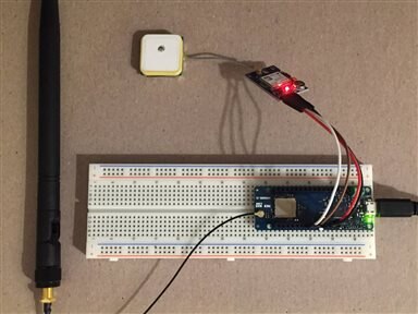

  • LoRa Experimental Environmental Sensors (LoRaXes) - GPS is Working
  • LoRa Experimental Environmental Sensors (LoRaXes) - Temperature Sensor Working
  • LoRa Experimental Environmental Sensors (LoRaXes) - Case Assembly Part 1
  • LoRa Experimental Environmental Sensors (LoRaXes) - Assembly Complete
  • LoRa Experimental Environmental Sensors (LoRaXes) - Conclusion
ralphjy 's project LoRaXes is a loose reference to a Dr. Seuss character in a book about the plight of the environment during the industrial age. He began building a pair of outdoor LoRa sensors to use for GPS, temperature/humidity/pressure, ambient light, water level, and PIR. He started his project to find a use for a Things LoRa Gateway and two MKR WAN 1300 boards that he won as the Grand Prize in the IoT: In the Cloud challenge.  This was his first experience with LoRa and the Things Network.
Goals achieved:
  1. Connect gateway to Things Network  - there were only five LoRa gateways within a 50 km radius of my location that were connected to the Things Network, so he added access for sensors near him.
  2. Build two portable battery operated sensor units - he only fully completed assembly of one of the units, but he's tested the electronics for both.
  3. Connect both units to the Things Network - he has unique applications running for each MKR Wan 1300 on the Things Network console.
  4. Provide GPS functionality for one of the units - the fully assembled unit has the GPS module and he has used it with the mapping integration on the Things Network to display the unit's location.
  5. Measure RSSI in the proximity of his house - units have good operational margin on his property.
Goals Not Achieved:
  1. Determine the effective LoRa range of he gateway/sensor setup - he needed to find the time to get some data walking the GPS unit away from the gateway.  hHe should be able to correlate the RSSI data associated with the GPS data packets and use -120 dBm as a range metric (or he could guess the real metric is when packets are not received - use the last location received).  His accuracy may not be that good if he doesn't do some averaging.  He's noticed that over time he could get geolocation outliers of 50-60 meters even though the clustering is more like 5-10 meters (with the unit in a static location).
  2. Measure/optimize battery life - He sort of gave up on this one when he realized that he has older MKR Wan 1300 boards that do not power down the Murata LoRa module in sleep mode (fmilburn pointed out this issue).  The achievable sleep mode current is ~2 mA.  He's seen implementations of full power shutdown using the TI TPL5110 ultra low power timer.  He thinks he will give that a try.  He can make room on the proto board to handle that.  And he'll need to make sure that the GPS handles save and restore of the tracking data correctly.  His guess is that even with the newer MKR Wan 1300 (released the end of 2018) he would still have had to power down the GPS since its power save mode draws ~11mA.  He may need to look at other GPS units.
  3. Determine the reliability of his system by analyzing uptime - this is difficult to quantify in the prototype stage since he's been constantly power cycling the units.  He noticed that his gateway reboots at least once daily.  He probably needs to automate some processing on the Things Network console.

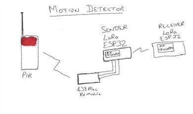

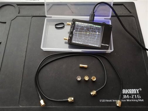

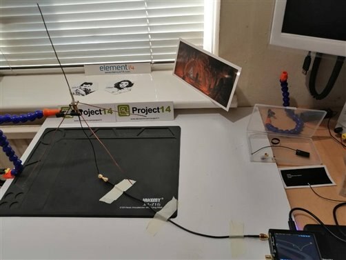

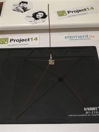

Building a poor man's quarter-wave 433MHz antenna: Introduction by gecoz
  • Building a poor man’s quarter-wave 433MHz antenna: Antenna’s construction
  • Building a poor man’s quarter-wave 433MHz antenna: Comparing Antennae
  • Building a poor man’s quarter-wave 433MHz antenna: Testing the antenna with ESP32 LoRa

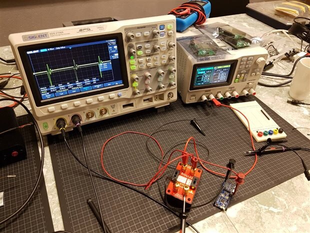

"Excellent experiments with a VNA, his project shows that anyone can start exploring antennas on a budget." - Community Member Judge
"This project blog taught me a great deal about RF measurements and also showed me the availability of some low-cost but effective test equipment. Fabio's series of blogs ofver the competition period were a real joy to see and read." - Community Member Judge
