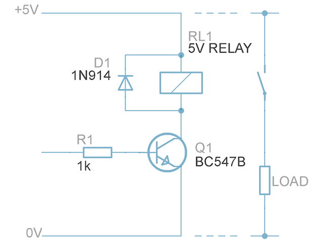

Has anyone tried switching slightly heavier loads using the CodeBug's legs, either using a transistor or a relay? I'm working on something that'll need to switch two loads on and off that I'm pretty sure would melt the CodeBug if I did it directly (maybe 1-2 amps each). I'm thinking that something as simple as a transistor, switched from one of the legs, would do the job, but thought I'd ask if anyone's experimented this as yet?

    The 'GPIO Explained' schematic with the transistor and relay should work too.
    (For some reason the editor is mangling the URL - will raise a feedback & support request. Circuit is below):
    (Finder 32.21.7.005.2000Finder 32.21.7.005.2000 is a convenient relay for up to 6A, fits stripboard nicely).
    Or a MOSFET based circuit, but I left them out of GPIO Explained due to opportunities to go wrong if people attempt to use alternatives!),

    Excellent suggestion, Shabaz, and I'm now wondering whether to go with Jon's MOSFET option, or whether to get a double pole relay and switch both loads from just one of the CodeBug's legs. Although I may need to control them separately... I'll have to think about that some more image

    0 shabaz over 11 years ago in reply to spannerspencer
    Hi Spanner,
    Personally I'd go with Jon's suggestion for my own boards, only caveat is that it is a surface mount device which not everyone is comfortable with. If you're using a relay, then you may as well use the NPN method, since it doesn't care what specific NPN transistor you use.
