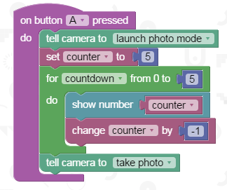

  • Go to the BBC micro:bit website, click 'create code' and begin a new Microsoft Block Editor project.

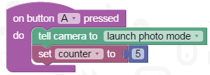

  • Under the left-hand commands menu, click 'Input' and find the 'On button [A] pressed do...' tile.
  • We want to tell the device to take a photograph when the 'A' button is pressed. However, we also want to add in a five second delay to allow us to set up the shot. To enable the camera, select 'Devices' from the left-hand menu, and drag in the tile 'Tell camera to [take photo]. Attach to your 'On button [A] pressed do...' tile, and change [take photo] to [launch photo mode].
  • To set up a countdown timer, drag in a 'set [item] to tile, and rename [item] to [counter].
  • Attach a number tile from the 'Maths' menu, and set it to [5].

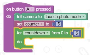

  • Now we need to tell the timer to start counting down when the A button is pressed. This is a slightly different process to the last time we created a countdown timer (see Project Two). First you'll need to bring in a tile entitled 'for [i] from 0 to [4] do...' and attach it to your code. This tile can be found in the loops menu.
  • In this tile, the [i] simply represents the variable being referenced in the code - in this case, the countdown timer. Feel free to change the name to something that makes more sense to you, but don't use 'counter' as we've already used this as a variable in this code. I've used 'Countdown' in this demo. Also, change the [4] to a [5] to bring it in line with your five second countdown timer.
  • Under 'do', drag in a 'show number' tile from the 'Basic' menu, and drag a 'counter' tile from the Variables menu into the input box.
  • Now drag in a 'change [item] by [1]' tile, also from the Variables menu, change [item] to [counter] and change [1] to [-1], to instruct the timer to count backwards from 5.
  • Finally, drag in another 'Tell camera to [take photo]' tile from the devices menu, and attach this at the bottom, as indicated here:
  • Now hit 'Run' to test out your script on the emulator. When you push the 'A' button the counter should begin counting down from 5 to 0. At zero, the device should take a photo. Compile your script and transfer it to your BBC micro:bit device to test it out for real. You can access your photos from the BBC micro:bit drive when you attach the device to your computer.

  • zenandy
    zenandy over 10 years ago +6
    It would help to specify the requirements for a smartphone here. The Micro:bit doesn't have an onboard camera.
    shabaz over 10 years ago +3
    It looks like this uses the Bluetooth and BLE capabilities of the micro:bit. I'm no expert, but there are dozens/hundreds? of profiles for doing different things, and one of them is for camera control…

    I would have loved this to work, but it didn't. I will work on it to see if I can get it going, but I managed to pair my S8 phone with the micro:bit without a problem (after looking up the details). I got the programme in (noting that the second step, inserting the "set counter to 5" tile, was in the "variables" not the "Math"- and I had to add the devices category by clicking on "add package" at the bottom of the categories - and was offered devices rather prominently). The countdown works fine, but then absolutely nothing happens, and there is nothing that suggests that the camera mode has been started on my paired phone. Even if I open my phone in the camera mode, nothing happens when I run the countdown.
    But I will try to debug it, and report back if I get it going...
