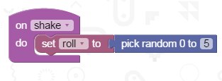

  • From the Input commands menu, drag in an 'if [shake] do' tile.
  • When the device is shaken, we want it to display a random number from 1-6. To do this, first we need to create a new variable.

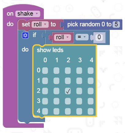

  • Attach a 'set [item]' tile, and rename the variable to 'roll'.
  • Now go to the Math command menu and attach a 'pick random [0] to [4]' tile. Change the figure in the dialog box to 5, like so:
  • Because the roll has a range of 0-5 rather than 1-6, we have to tell the device to show the number one when it rolls a zero, the number two when it rolls a one, and so on.
  • Drag in an 'if/do' tile and, for 'if', attach a '[0] = [0]' tile from the logic menu. Drag a 'roll' variable into the left dialogue box.
  • For 'do', attach a 'show leds' tile and set it to display the 'one' side of a standard dice by lighting up a single bulb at the co-ordinate 2/2.

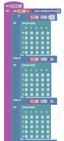

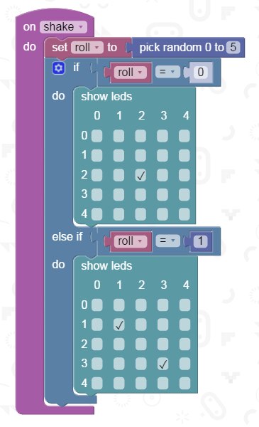

  • Click on the blue cog symbol in your 'if/do' tile and add an 'else if/do' option.
  • Use this to program your BBC micro:bit to display the 'two' side of the dice when the device rolls a one.

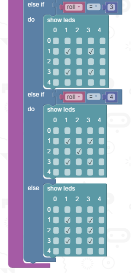

  • Using more 'else/if' and 'else' tiles, repeat the steps above so that when the roll is 2, 3, 4 5, the device shows a 3, 4, 5 and 6 dice side respectively.
  • You're done! Run your program to test it in the right-hand emulator, then click compile to download the script and transfer it to your BBC micro:bit.
