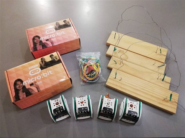

Equipment
I have two micro:bit club sets (20 micro:bits, USB cables and battery packs), four MOVE :mini robots (using four of the micro:bits), a pack of crocodile clip cables and four wire paths and wands (used for a specific project). I bought a lot of rechargeable AAA batteries to avoid ongoing costs and the waste from using disposables.

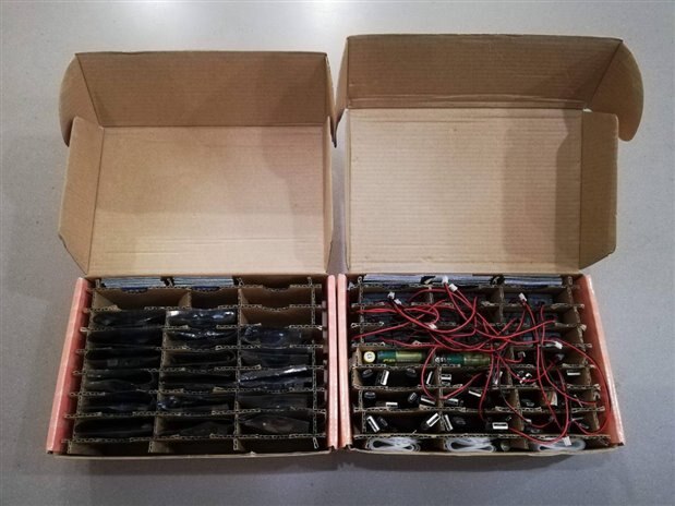

I divided up the club packs so one box has all the micro:bits and the other has the accessories. Having all the micro:bits in one box makes it easier to check if they're all returned at the end of the class (I keep the anti-static bags and let the class go when they're all full again). Every class I bring in the two micro:bit boxes, and I bring in the other hardware only on the days they're needed. This way nothing has to be stored at the school.

1. Interactive Badge
This is a really simple introduction to the micro:bit. I start by giving the kids some micro:bits to look at then describe the components on them. I talk about the microcontroller that is the "brain" of the micro:bit and how you'd find something similar in your microwave or other devices they might not consider to be computer controlled. By the end of this project the kids know about input using buttons, display using LEDs, animation using delays, testing using the simulated micro:bit in MakeCode and downloading to a real micro:bit.
2. Fortune Teller
This is an implementation of a Magic 8 Ball toy. This is a project that works really well:
  • It's a programmatic version of a real world thing, so it's easy for kids to understand.
  • Kids like to extend it by adding their own responses, e.g. "ask me tomorrow", "no way!".
  • They have a lot of fun asking their micro:bit questions and laughing at the answers.
3. Frustration
This project introduces some simple electronics with crocodile clip leads and the wire and pre-assembled wire paths and wands. The kids learn that you can connect things to the micro:bit and it can become part of a larger project. Watch out for kids shorting micro:bit pins together! (Doesn't seem to break anything but makes the micro:bits behave oddly).
4. Heart Monitor
One of the great strengths of the micro:bit is how easy it is to use the Bluetooth radio to connect multiple micro:bits together. I made this project to introduce a simple project to send a message from one micro:bit to another. This one can be a bit hard to diagnose when mistakes occur (is it the transmitter or receiver not working?). Good for working in pairs - give each pair a radio group number and then their micro:bits talk to eachother. The range is sufficiently short that the kids can find the limitations of radio.
5. Image Sender
This project is a more complex radio project. It also introduces using binary to encode an image. I wrote another radio project but found it a bit complex for the kids to understand. This is my second attempt to make something simpler and haven't yet tried it with kids.
6+. MOVE :mini
I have four MOVE :mini robots and get the kids to divide into groups of 2-3 to use them. I don't have a written project I get the kids to follow but I talk about how these robots have two servo motors and show them how to set their speed. We use felt tip pens and paper to get the robots to draw shapes. The robots provide 2-3 sessions of work with the following challenges:
  • Draw a circle (get one wheel working).
  • Draw a bigger circle (get two wheels working at different speeds).
  • Draw a square (need to move forwards, turn on spot with one wheel forwards and the other backwards, use timing to keep things square).
  • Show colours using the RGB LEDs.
  • Remotely control the MOVE :mini using the Bluetooth radio.
I hope this inspires you to try teaching with micro:bits!
