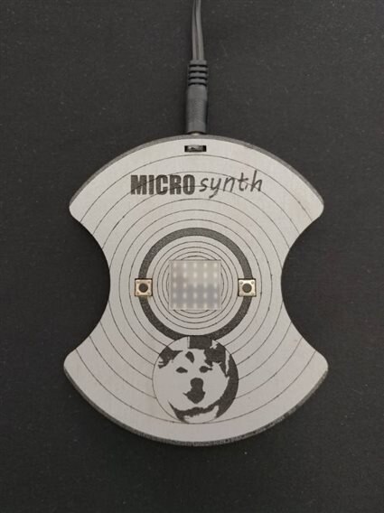

The Micro:bit Accelerometer Theremin. Cool case, but no lights this time. (All Images: ME)

Laser cutter to cut the case

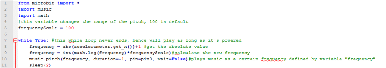

Load the code onto the Micro:bit.
I am providing the hex file you need to drag and drop onto the Micro:bit, and the python code as two separate files. For the below process, just use the hex file.
Plug the MicroUSB cable into the Micro:bit, and plug the other end of the cable to a PC or MAC.
At this point, you are going to copy over the code to the Micro:bit. I am providing the program (code) in this post that needs to be copied over. When the Micro:bit plugs into a computer, it shows up as a USB flash drive. All you have to do is copy the file over to the Micro:bit, like it’s a USB Flash Drive, and the Micro:bit will reset, and the program is active.
You can remove the Micro:bit from the computer at this point. The program will start running, and without the rest of the circuit, it will not function.
A little bit about the code:
This is the whole program! I was surprised how clear and succinct the concept's code turned out.

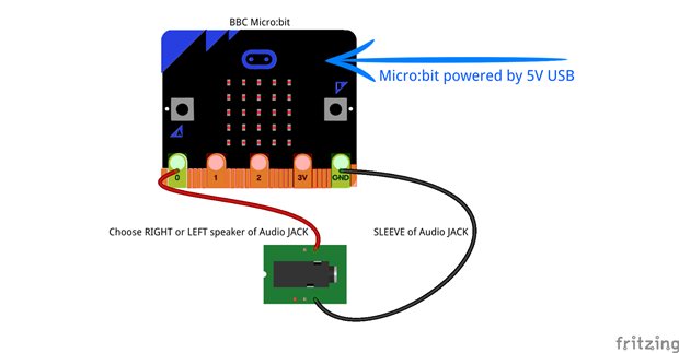

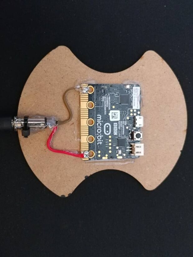

I like this project a lot, since it doesn’t have a lot of steps and parts. Following is the only wiring you have to do.
Wire up the audio connector.
STEP 3
Setup
- Plug in powered speakers to the 3.5mm jack.
- Power it with a 5V microUSB cable from either a PC, outlet or battery. It will immediately start playing.
- Move the Micro:bit around to hear the sounds.
