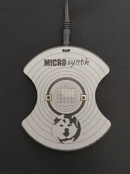

The Micro:bit Accelerometer Theremin. Cool case, but no lights this time. (All Images: ME)

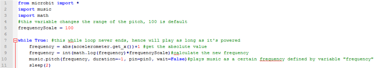

I am providing the hex file you need to drag and drop onto the Micro:bit, and the python code as two separate files. For the below process, just use the hex file.

A little bit about the code:
This is the whole program! I was surprised how clear and succinct the concept's code turned out.

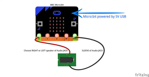

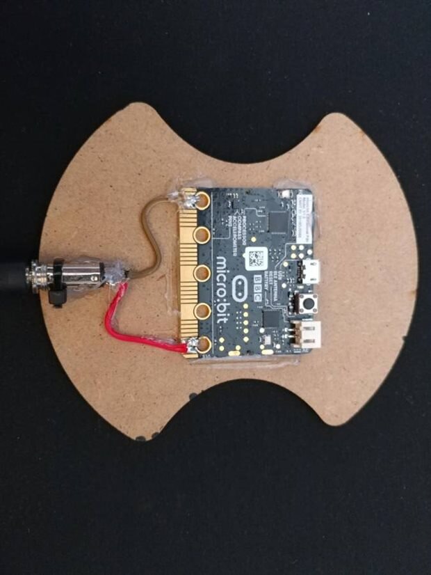

I like this project a lot, since it doesn’t have a lot of steps and parts. Following is the only wiring you have to do.
Wire up the audio connector.

Setup
- Plug in powered speakers to the 3.5mm jack.
- Power it with a 5V microUSB cable from either a PC, outlet or battery. It will immediately start playing.
- Move the Micro:bit around to hear the sounds.
