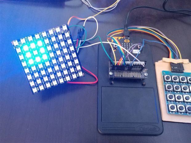

I activated one effect in this section of the LED panel. (via ME)
I will admit, I could not expand the memory much with the Micro:bit for the last project. So, before I explore memory expansion, I thought I would see what else I could do with the 8x8 LED grid panel.
Although the LED panel is simply a reconfiguration of an addressable LED strip, but I wanted it to act like a screen. So, when the keypad is pressed, I wanted effects to correlate with the buttons. So, in this version I wanted to do splash effects at those points.

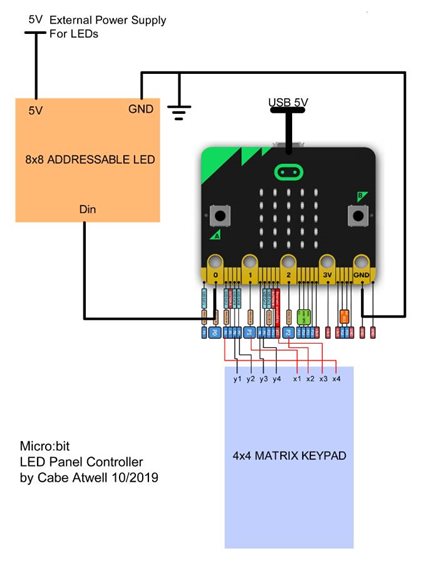

STEP 2
The schematic is fairly straight forward. It’s also the same as the last project. Wire it up like the drawing.

Speed of the Micro:bit is a huge drawback to this project. It can display the effects, but it’s very choppy. I will have to explore how to make this happen a bit faster. Easiest thing I could do is offload the LED control to an Arduino. Then I could swap in Micro:bit boards like cartridges for different effects. Maybe…
