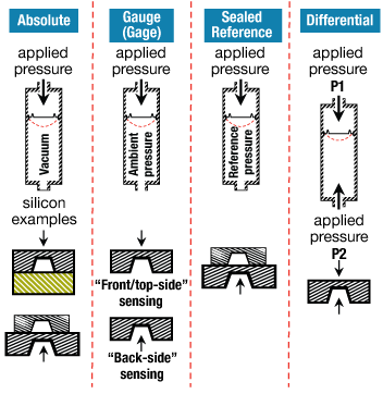

Types of Pressure Sensors
In addition to the various sensor categories and designs available, there are a multitude of specific types within each sensor category. Pressure measurement applications can be divided as follows:
• Absolute: This is the pressure measured as referenced to an absolute vacuum. An example would be a barometer that measures the absolute pressure of the atmosphere.
• Gage: This is the pressure measured as referenced from an atmospheric pressure to a pressure being measured. An example would be a pressure gauge on a process pipeline.
• Sealed Reference: Very similar to gage pressure, except the back side of the sensing element is sealed during the fabrication of the sensor. The gage pressure is now a measure from this reference atmospheric pressure to the pressure being measured. This type of sensor will be susceptible to changes in atmospheric pressure and will give significant error measurements at lower pressures. More suited for higher pressure applications where the sensor has to be sealed from the environment (i.e., eliminating fluid or gas ingress).
• Vacuum: Similar to gage pressure, except the pressure in the system is below atmospheric pressure.
• Differential: This is the pressure difference measured between two different pressures. Typically wet/dry differential pressure is a measure of a liquid on the sealed side of the sensing element, and a dry gas on the back exposed side of the sensing element. Wet/wet differential pressure is typically a measure of two liquids, and both sides of the sensing element is isolated from the media.
Figure 4: Types of Pressure Sensors

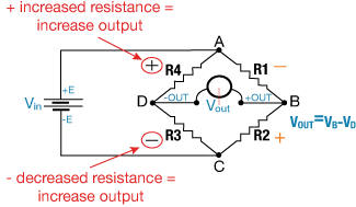

Wheatstone Bridge
Pressure sensors become a transducer with the utilization of the Wheatstone Bridge. When a force is applied (i.e., in this case a tensile force) to a structure with a single strain gage bonded to it (could also be a piezoresistive gage doped to a silicon substrate), the induced strain field will cause a resistance change (ΔR) in the gage (i.e., in this case, an increase in resistance).
So we can see that strain ε is equal to the change in length of the structure (ΔL) divided by the original length (L) of the structure, which in turn is proportional to the change in resistance (ΔR) divided by the original resistance (R) when no force is applied.
A measure of this conversion from strain to resistance is called the Gage Factor (F), and it can be defined as the ratio of change in resistance, divided by the ratio of change in length of the structure, which is the strain induced in the element.
In a load cell (also applies to pressure and torque sensors), these strain gages are strategically placed on the force sensing element, and wired in such a fashion to make up the electrical circuit called a Wheatstone Bridge. The gages are placed to ensure that some of the resistance changes are increasing (+ resistance), and some are decreasing (- resistance). The end result is to unbalance the output of the bridge which will be proportional to the force applied to the load cell structure.
The Wheatstone Bridge is powered by a fixed input voltage (V in), which is typically, but not limited to, 0 Vdc to 10 Vdc applied across points A and C, and the output from the bridge is measured as a voltage between points B and D. In the unloaded condition, the output voltage (V out) measured between points B and D will be approximately 0, and when the full scale load is applied, the output voltage (V out) is measured in millivolts (mV). Typically the sensitivity of a load cell is 2mV/V (i.e., if the input voltage was 10 V, then the output would be 20 mV in the fully loaded condition).
Figure 5: Wheatstone Bridge

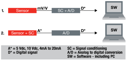

Working with Instrumentation
Typically, the output from Wheatstone Bridge-based pressure sensors is used to monitor and/or control an application or process. Since the full-scale output from a bridge-based sensor is typically low level voltage (i.e. 20 mV to 300 mV), additional signal conditioning (SC), and conversion to a digital signal (A/D) is typically required.
Two options are shown below, with both being very similar in that the mV signal from a Honeywell sensor is converted into the digital signal. The difference between the two revolve around combining the SC and A/D functions for Option 1, with separate instrumentation, and separating them in Option 2 (i.e., keeping the SC on the sensor and providing the A/D with separate instrumentation). The digital signal can then be supplied to a PC, where a variety of software programs can process the input, store the data, make decisions, etc. Honeywell provides pressure, load and torque sensors that have an amplified output (i.e., signal conditioned signal), and this is shown in Option 2, where the signal can be converted into a digital signal.
Figure 6: Instrumental Options for Pressure Sensors
