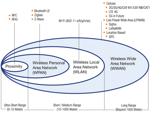

From an IoT application point of view, we can classify the protocols by the requirements for Communication Range. As shown in Figure 1, we have classified RF protocols based on their communication range below:
  • Long Range
  • Short / Medium Range
  • Ultra-Short Range
Figure 1. Classification of RF Protocols
Long Range
The long-range communication protocol provides high availability of a network in a large coverage area typically beyond 1km. Long-range RF communication is associated with the higher power required to transmit and receive the signals. The primary challenge is to transfer the signals over long distances with minimum power consumption enabling battery-operated IoT installations. The long-range protocols include Cellular, LoRa WAN, and Sigfox.
