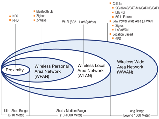

From an IoT application point of view, we can classify the protocols by the requirements for Communication Range. As shown in Figure 1, we have classified RF protocols based on their communication range below:
  • Long Range
  • Short / Medium Range
  • Ultra-Short Range
Figure 1. Classification of RF Protocols
