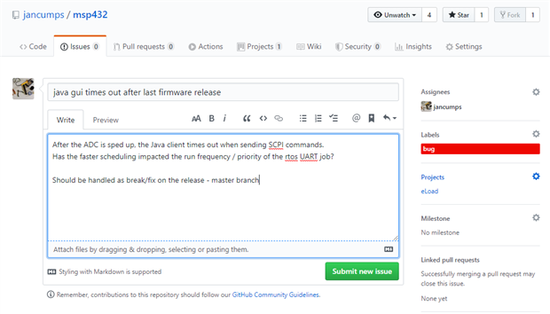

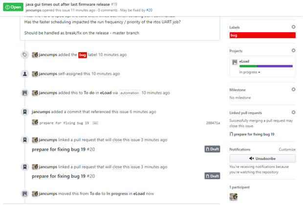

Create production issue
In GitHub, create the issue to report the production bug:
Because this is a bug, I assign the existing bug tag to the issue - and later to the pull request too.
Assign the owner and project, to get it on the board.

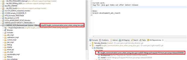

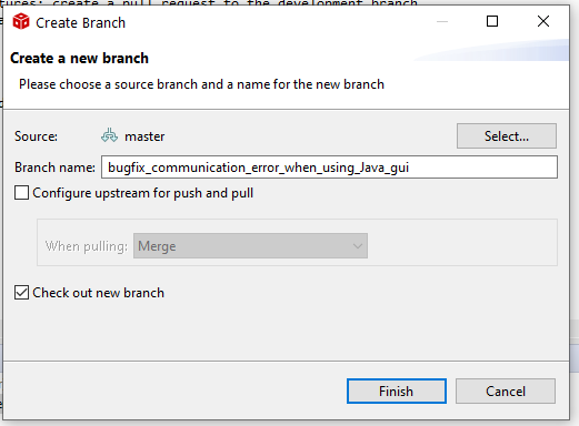

Create a Feature Branch in Eclipse to work on the breakfix, with the GIT Plug-in
We used the command line in the previous posts. Many IDEs have a plug-in though.
Here, I'm using the Eclipse GIT plug-in in Code Composer Studio. TI's Eclipse based IDE.
You can create a new branch by right clicking on the project, then select Team -> Switch ...

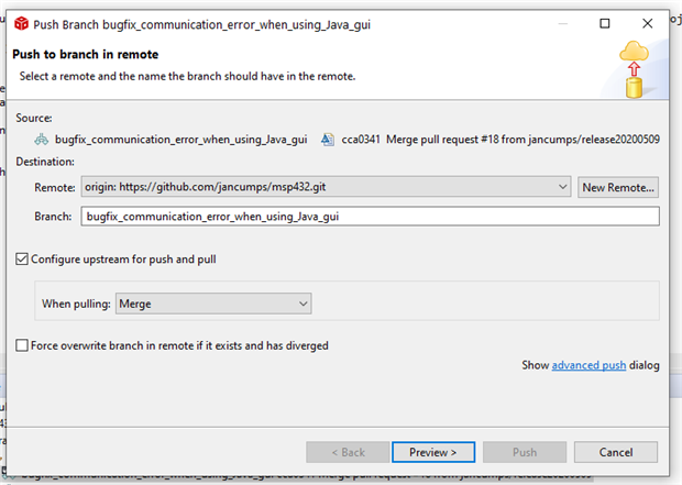

Then push that branch to GitHub so that your work is tracked.
The parameters are pre-filled if this is an active Git repository.
note to self: maybe later write a post on how to initiate a repository. But there are many around that are very clear ...
You can see in the project view (left) and Git Repositories window (bottom right) that the active branch is highlighted.
Eclipse and the plug-in do a good job to show what branch you are currently working in.

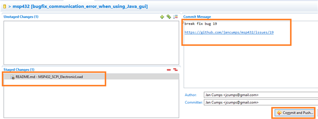

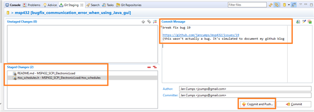

Make an edit. Any edit will do, but I usually enter a comment in the readme or in the "what's changed" file. And save it.
Not everyone is a fan of storing what's changed info in the project sources a s a text file. They prefer to source it from the bug system.
In this example it doesn't matter. We just want to have a first file change, so that we can commit it and out branch becomes "dirty".
Update the readme to flag what we're working on. Then use the Eclipse plug-in to commit and push upstream.
It's the excuse to get that feature branch dirty so that we can immediately start a draft pull request... (controversial image)

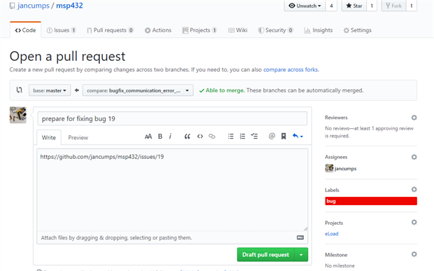

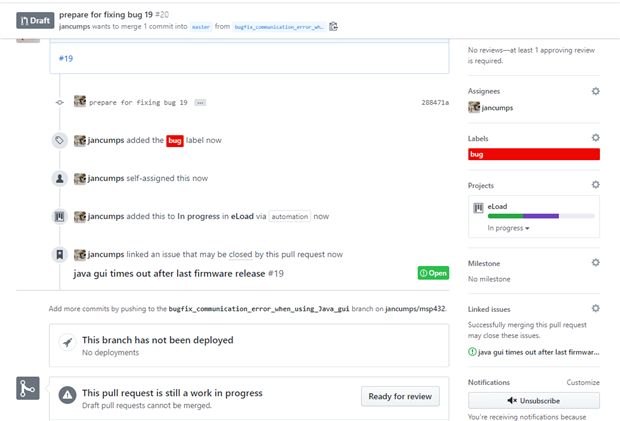

The pull request is made just like in the previous blog. But against the master branch. I'm fixing a production defect.
Next to the green create button, there's an arrow. Select that and mark that you want a Draft pull request.
Set the tag to flag it as a bug.
A draft is just like any other pull request, but it will not be submitted to the approvers. You can keep on working.
Any new commit + push you do will be automatically collected into the draft.
Why, Jan? We didn't use it in the previous flow.
Well, there are 2 possible advantages:
  • you give the reviewers an early heads-up of the work on the horizon
  • you can link the pull request to the incident. When the pull request is being approved, the issue status hikes along.
Once the draft is there, I can link the incident to it (I forgot this in my previous blog)

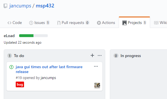

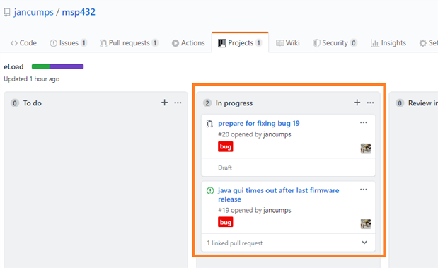

The draft pull request is now visible on the issue too. And it's moved to in progress.
The board now shows the pull request and the issue cards, both in progress. Project manager will be delighted.
Fix The Bug in Eclipse, using the Git Plug-in for the Commit & Push
Now, actually write the fix, committing and pushing to the feature branch.
I'm again using the Eclipse plugin to do this.

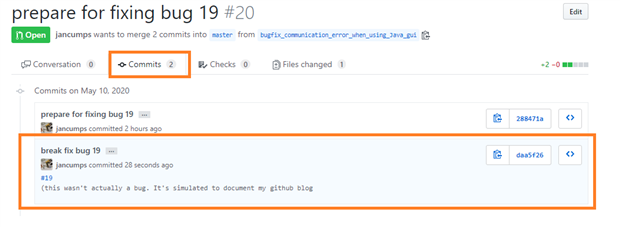

In the spirit of Git and Agile: commit and push often. Develop iterative until the bug is fixed and tests pass.
Once that's complete and I'm confident that the bug is fixed, it's time to submit for approval:
Submit the Pull Request

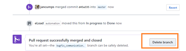

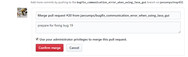

In GitHub, review the draft pull request and make it a firmed one.
You'll see that our subsequent commits were automatically added to the draft pull request.
I use my admin rights again to override branch policy (explained in the previous post). Normally done by the code reviewer and branch owner ...
... and also delete the - now obsolete - feature branch:

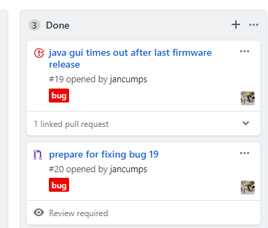

Now, this should (and will) pull everything to complete (issue, pull request and both Project cards), just by accepting the pull request.
Work Done for the Bug Fixer - but there's a next step
And yes, that works image.
So approval of the pull request has closed the issue it was related to.

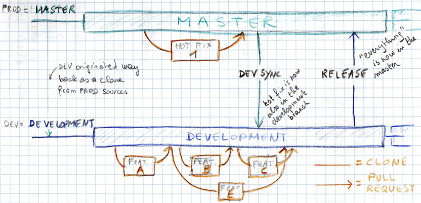

But if we fix something in production and don't apply that fix to the development team, we set ourselves up for a future drama.
The next deploy from project to master would overwrite our good work and we'd have the bug again.

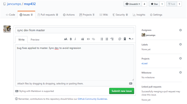

So the solution is to send these changes to the development branch.
I will now create a task for the development branch owner to sync this break/fix into the development branch.
Handling that task is for the next post ... The circle of life
