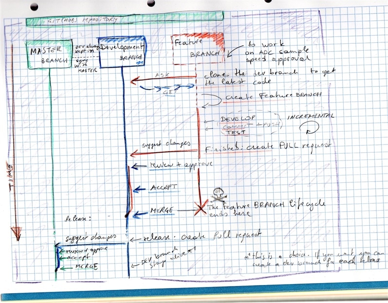

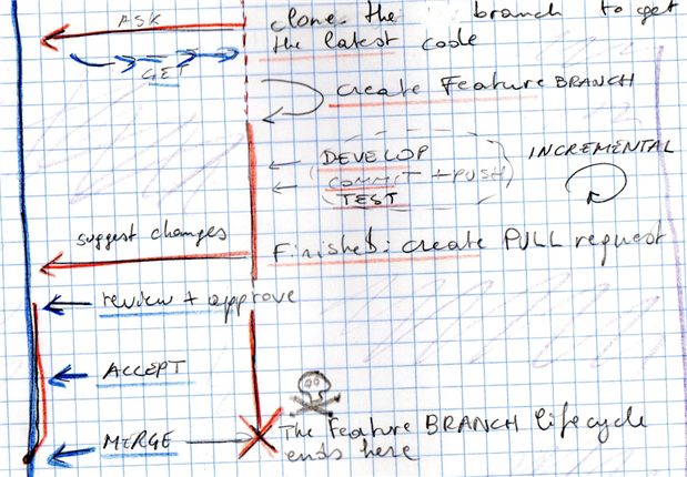

Feature Branches
If you want to control what goes into the master (or any meaningful) branch, you can use the feature branch strategy.
In that case, you allow contributors to create their own branches on the fly*2. You don't give them commit access to the master branch.

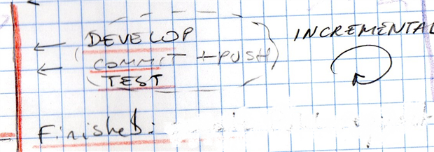

Feature branches are short-lived by design. They are meant to work on one aspect of the software.
The developer works in that branch and has all the advantages of version control. Changes are tracked, but they stay safely in that feature branch.
It doesn't matter if non-working or partial code is checked in. The "official" code base is not impacted.
Once development is deemed finished - you can set rules here if wanted, like all test cases passed, code style checks passed, .... - the developer can create a pull request.
This is where the hosting site matters*1. They support this process to generate the request and get it merged into the official branch.
Once the repository admins accept that pull request, the feature branch is typically deleted because it has lived its life. No need to keep that.
The change will be eternally traceable via the pull request that stays in the repository forever.

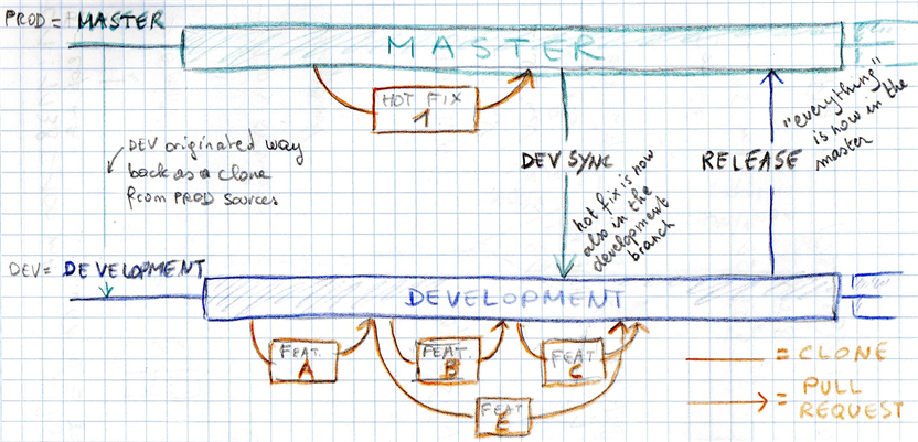

Project / Development Branch
When you want a stable master branch that represents the official released code, and you have active development going on, then there's the possibility to create long living additional managed branches.
The development branch starts as a clone from the master.
You'd want to set up a policy for such a branch too, similar as the master branch.
Then developers will create feature branches based on that development branch, not the master.
Their process is the same as explained in the Feature Branch section, while they are developing inside that feature branch.
But once done, they create a pull request to the development branch. Not to the master branch.
When the admin approves the request, code is merged into the development / project branch and the feature branch is deleted. Job done.
The repository admin should not accept direct pushes from such a feature branch into master.
At release time, the release manager (or you if you are lonely) will create a pull request with the development / project branch changes to the master branch.
Once the repository admin accepts that request, this is the new released version.
You can have several managed development / project branches in a complex project.
