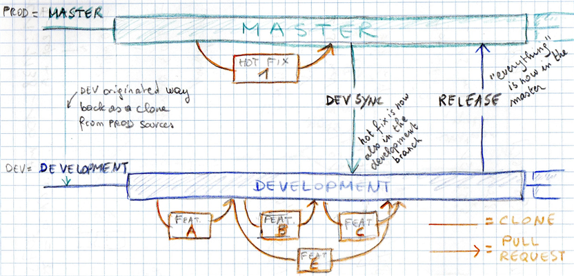

This is going to be a short article, because the activity is identical to Firmware Release with GitHub: Branch, Issue, Pull Request and Project support , but the other way around.
When creating a release, you merge the development code into the official master.
But here,  after finishing a hot-fix, you merge the production changes (fixed code) with the ongoing project.

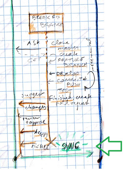

Step 1: Work is done - create a temporary dev-sync branch to prepare the merge of master changes into development

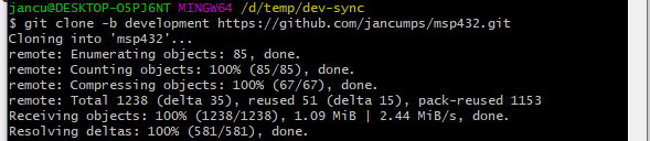

$ mkdir dev-sync
$ cd dev-sync
$ git clone -b development https://github.com/jancumps/msp432.git

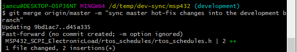

$ git merge origin/master -m "sync master hot-fix changes into the development branch"
$ git checkout -b prod-sync
$ git push --set-upstream origin prod-sync

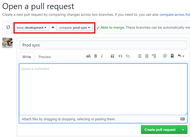

Step 2: Merge into development via pull request
We've seen this a few times now. I'm not going to dive into this. Take care to merge from dev-sync into development.

In this flow where I didn't discuss the project board, the core steps are more apparent. The raw steps to get bug fixes synced to development with branch strategy.
