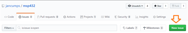

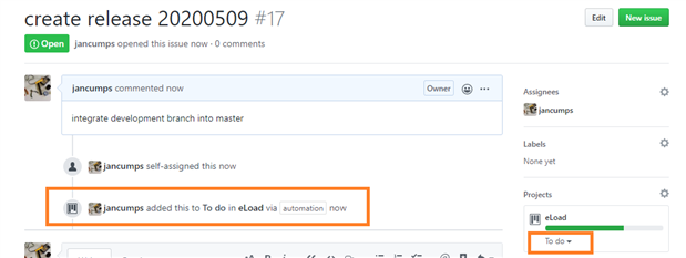

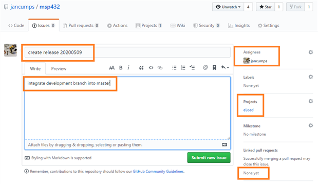

Step 1: Assign the work - create an issue
An issue can be a bug report, but also a task such as creating a release.
By assigning it to someone (hey, that's me again), and linking it to a project, you automatically get scrum / Kanban style functionality.

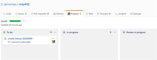

Step 1a: Review the project board
I want to use automation as much as possible. The project integration is supposed to give insight. Not give more work to the developer.
You can see that our board has one new card, in the To do lane. Let's just look, don't touch.

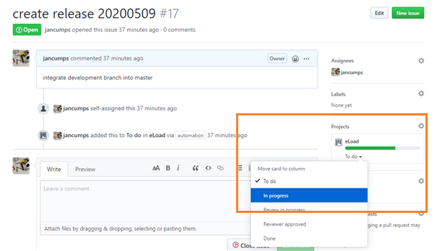

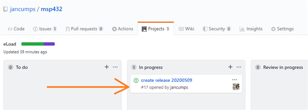

Step 2: Start working on the release
I have this issue open on my name now, with the project board reflecting this.
From the issue, we can flag that we're going to work on it:
Step 2a: Review the project board
As expected, the task has moved lanes.

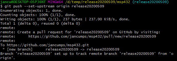

Step 2b: Do the work - create a release pull request to merge development into master
Creating a release is actual work. We can change statuses and stuff, but that'll never get things done.
We need to make the hands dirty. In Git.

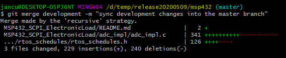

$ mkdir release20200509
$ cd release20200509
$ git clone -b master https://github.com/jancumps/msp432.git
I specify the master branch here, although that is the default branch.
I do it because in reality I automated this in a batch script with parameters.
So I can pull in changes from branch B into branch A by just defining the two branch names (+ the name of the feature branch I temporary create to support the pull request).
$ cd msp432
$ git merge development -m "sync development changes into the master branch"
$ git checkout -b release20200509
$ git push --set-upstream origin release20200509

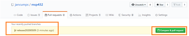

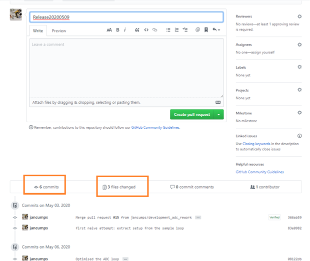

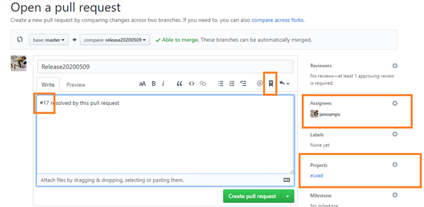

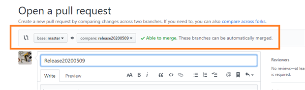

Our release branch is now ready to be integrated into master:
Review the pull request content before creating it. You get an overview of all the files that changed, and what has changed.
Also check that you are actually pulling the correct branch into the correct branch.
In this case, the goal is to pull the changes from development (collected in temporary branch release20200509) into master.
Link the pull request to the project card. See next section - you only have to do this if you want to get a view of pull request progress on the board.

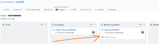

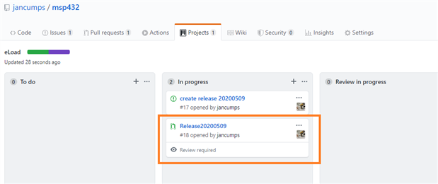

Step 2c: Review the project board
Because I selected the project in my pull request, a new card is created on the board.
You don't have to do this. If you just want to stick to one card to manage the issue, just don't add the pull request to your project.
But if you want to enable tracking of the approvals by the reviewers (hey, that's me) , you can use this functionality.

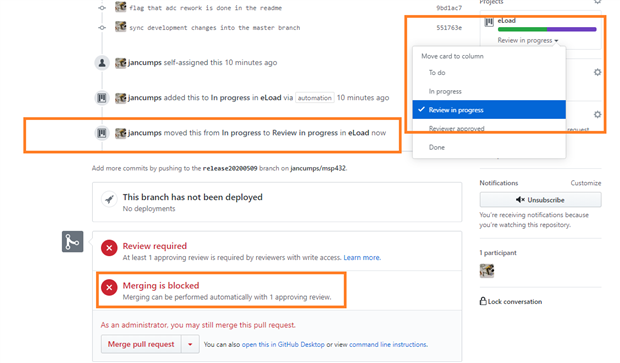

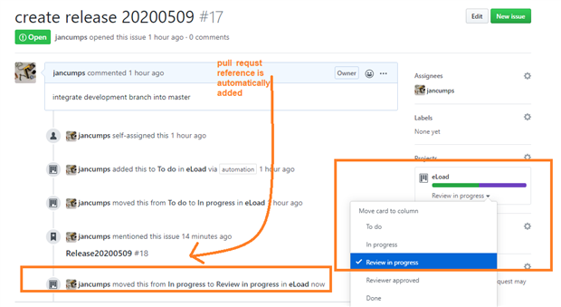

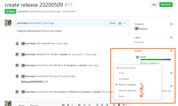

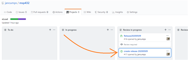

Step 2d: Flag that you've submitted the issue for review
You're finished with the work. You as developer (hey, that's me) can flag that in your issue.
Your issue card has progressed. Both developer and reviewer tasks are visible for the project manager (hey, all 3 me) on the board.

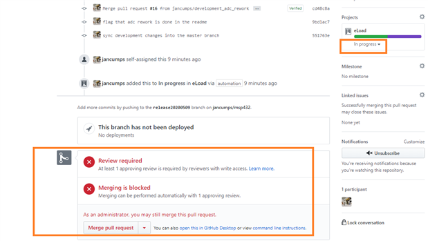

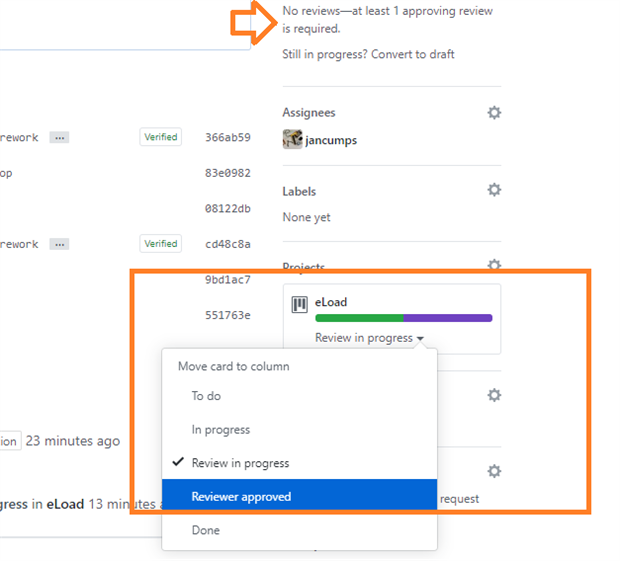

Step 3: Review the pull request
Here I can't show the full flow because I haven't set up a second contributor to review the pull request.
I'm using admin override to approve my own request.
GitHub makes this very clear by using bright red for all admin override options.
Let's set it to In Review.
Step 3a: Review the project board

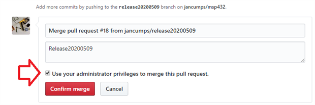

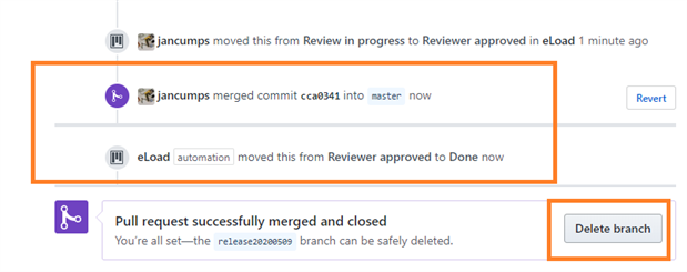

Step 4: Approve and merge the pull request
In the real world an approver would be assigned. You can select one from all the repo members that have commit access to the destination branch.
In my case, I use the admin override to accept my own pull request:
The pull request card moves to done.
I always delete branches that have been accepted. Some platforms, such as Azure DevOps, allow that this happens automatically at acceptance.

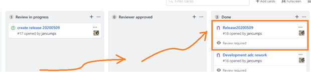

Step 4a: Review the project board
The reviewer / approver tasks are done. The card moved to the done lane.

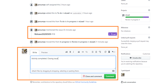

Step 5: Release Done. close the issue
Totally optional, the release manager can flag that the pull request is reviewed and done.
In a work situation, I'd flag that it's been sent for review, just to keep the project manager aware.
The card will then show up in the relevant lane on the board.
What you have to do as release manager, is close the issue.
The acceptance of the pull request is automatically recorded (see purple label):
Enter a closure message and close the issue. You have finished the task. The release is confirmed and available in the master branch.

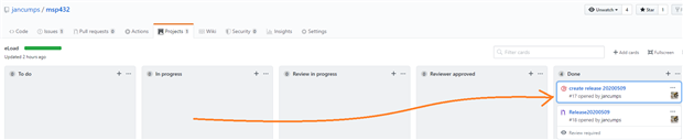

Step 5: Review the project board
This is what project board automation can offer:
Having a project view of the activities, based on real activities by the developers, release manager, reviewers and approvers.
If you've ever been in a situation where you have to maintain task status as a separate activity in a project management system, you may appreciate that,
if you define a repeatable process, you can have the status on the project board up to date.
Without updating project stats. Goal b.
The one that's responsible for the issue can manage all statuses from the issue (me image).
The one responsible for review and acceptance can manage all statuses by approving review and accepting merge (me image).
The one responsible for project management gets a real time view of everyone's duties (me too image - there's no escape in a one person repo).

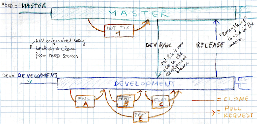

    Thanks, Jan. This is a super helpful tutorial for advanced uses. With a diagram like this, I finally started understanding the concept of git: - W.
    Jan Cumps over 6 years ago in reply to shabaz +3
    If Git designers goofed up one thing, it's reusing terms that have been used since forever in the problem domain, then use them for an unrelated activity. Git commit Git checkout It makes my life as an…
    shabaz over 6 years ago in reply to wolfgangfriedrich +2
    Nice diagram. It confused me for ages too, until I saw something like that. This is the type of diagram that software developers will want, even though it is possible to operate git without needing to…
    Git commit
    Git checkout
    It makes my life as an advocate unneccesarily difficult.
