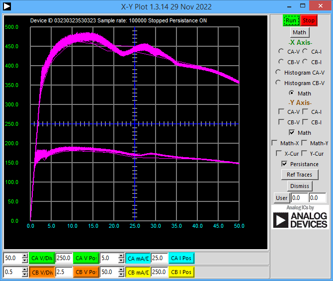

For this blog, I thought I'd have a go at measuring the DC gain (beta) of a transistor (used common-emitter) versus the collector current, using the built-in functions rather than by scripting anything. How hard could that be? Actually it turned out to be quite difficult, though some of that might be down to the dunderhead that we've got operating the equipment.
My first attempt was the simple, straightforward approach. Source a current to the base of the transistor (via a 220R resistor, as a little insurance in case the output did anything silly before the current regulation began), and source a voltage to the collector whilst measuring the current on the same pin. Unfortunately, the result left a lot to be desired.
That's supposed to be a nice curve for a 2N3904 transistor, with collector current (in mA) on the X axis, and the gain on the Y axis. We can see better what's going on if I show you the oscilloscope view.
The cyan trace is the base current, the yellow trace is the resulting collector current, and the purple trace is the gain computed with the math function.
It's a mess because of all the noise on the lowish current (<1mA) that's driving the base.
There are a couple of other problems, too. One is that because I'm using a sawtooth waveform, the slew at the start messes up the first part of the curve. A second problem is that, as I don't know the gain ahead of time, I ended up adjusting the range the base current sweeps over to give a reasonable range on the collector current.

It still suffers from the slew in the region up to 4mA, though, whilst it's still not exactly professional level, we're getting a better idea of the shape of the transistor characteristics now. I've thrown in a 2N2222A for good measure.
I wasn't expecting the hump in the curve for the BC549C, so that might indicate a problem of some sort with the test.
Here is the sweep extended up to 100mA:
Keep in mind that they will all be suffering from self-heating at the top end, the 2N3904 and the BC549C in particular where they are above the max dissipation limit. Also, because with my circuit the collector voltage falls with current, I'm not measuring at a constant Vc.

That gives this for the plot of transistor gain against collector current.
Leaving aside the mess up to about 5mA, the noise on the current output from the ADALM1000 affecting the calculation of the gain quite badly at lower currents, and the untidy lines from the 'fly-back' at the end, that's not too bad.
