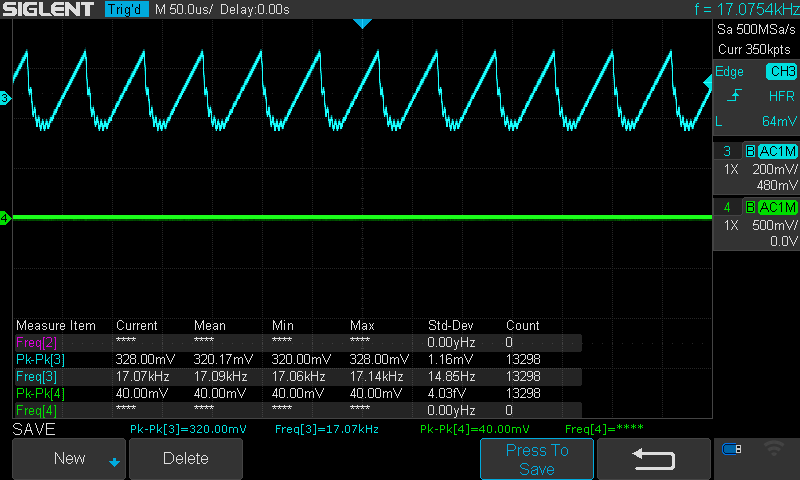

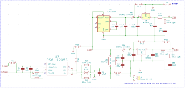

I'm looking for some help with resolving a noise and what I believe is stability problem of a -5V LDO regulator.  Here is the circuit:

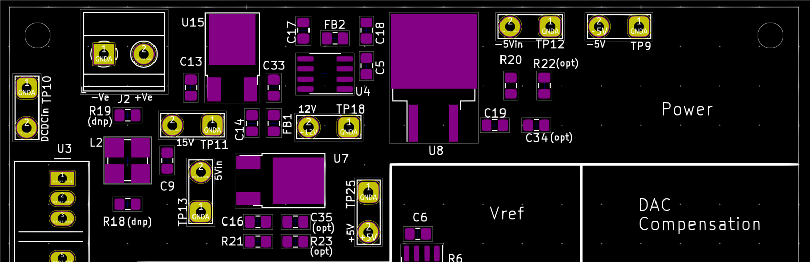

and in case it's useful, the relevant part of the PCB:
The circuit section I'm having difficulty with is the top right (yellow ICs).  I have a 285Ohm resistor soldered across terminals of TP9 and it draws 17.5mA.  R22 and C34 are not populated.
The TC7662TC7662 DC-DC charge pump, is fed from a regulated 12V and outputs -11.8V to feed into a -5V LDO regulatorMC7905CDMC7905CD which is outputting -5.011V.

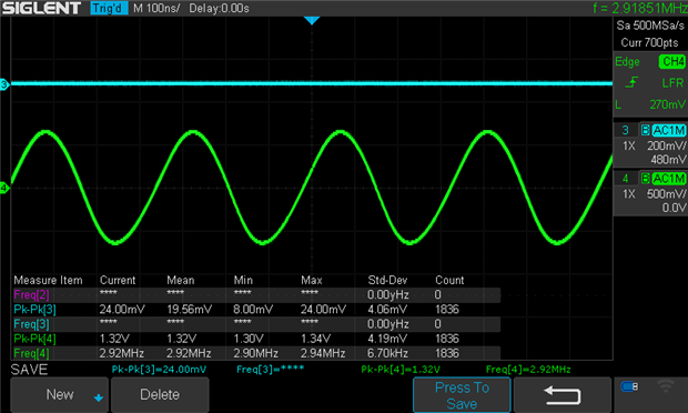

When I take measurements (AC coupled, BW 20MHz, 1xprobe with the pigtail rather than flying lead) of the charge pump output (at TP12) and -5V output (at TP9) I get:
CH3: Charge Pump output with HF reject on (matches what is expected in the datasheet).  I was expecting that the frequency of the output would be 35kHZ due to way I have pins 1 and 8 connected together.
CH4: -5 LDO output with LF reject on.
I think the LDO output looks like it is oscillating.  Looking at the circuit the input capacitor, C18, is too small and should be a 0.33uF tantalum for stability, according to the datasheet but I have used a 0.33 ceramic capacitor as I don't have any useable tantalums and my thinking was the ceramic should have a low ESR.  I've actually tried with 22uF and then a 68uF electrolytic capacitors, in parallel, but both have zero effect on the LDO output which remains steadfastly at 1.32V.  I've tried the circuit on a breadboard but unfortunately I only have a TI LM7905 - this seems to work ok even with the original capacitor value and doesn't oscillate.  I think the TI part behaves differently so it's not a great comparison.  Its output is slightly improved with a 22uF input capacitor.
I really thought that adding an electrolytic capacitor at the input would help (the ESR of the 22uF was around 2.2Ohm) but it makes no difference at all.  I'm out of ideas short of "it really needs a tantalum capacitor on the input", so I'm putting this out there to see if anyone can give me pointers or things to try.

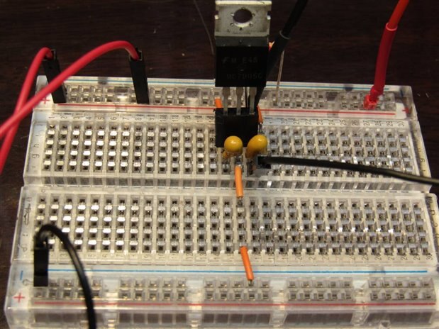

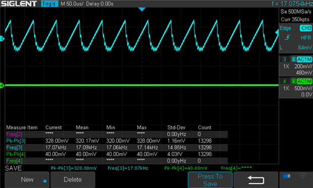

    Andrew J over 5 years ago in reply to jw0752
    Thanks John, that's really helpful.  I tried a similar setup on a breadboard but could only use a TI LM7905 which seemed to have different behaviour as it worked with a 1uF ceramic as well as a 10uF and 22uF electrolytic.

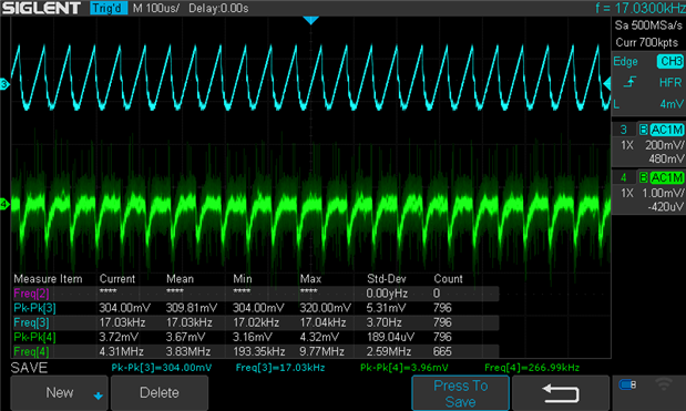

    michaelkellett you were right about the output capacitor and the problem lied with me leaving the 1uF ceramic in place and using a 10uF/22uF after that.  Removing the 1uF and tieing a 10uF electrolytic across the output and gnd terminals stabilised it:
    I now have a <4mV ripple on the output which corresponds to the ripple from the charge pump output.
    Thanks both for your help.  That's something else I've learned about these regulators.

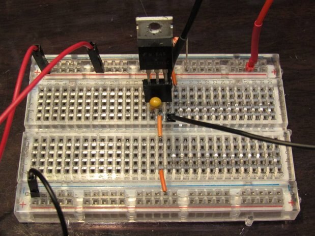

    jw0752 over 5 years ago
    Hi Andrew,

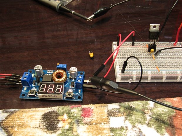

    For the fun of it I decided to see if I could duplicate your problem. I fed a small adjustable DC switch mode converter with 15 volts from my power supply and regulated it down to 10 Volts. This was to simulate your switch mode chip on your board. I then fed the 10 volts from the convertor to a standard 7905 linear regulator. I also loaded the circuit with a 270 Ohm resistor. The regulator data sheet called for a 2.2 uF Tantalum on the input and a 1 uF Tantalum on the output. Here is my set up:

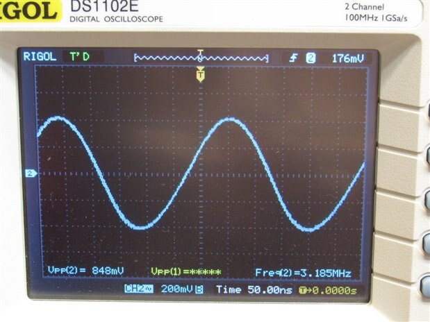

    When I set up the regulator with only the input capacitor installed I found that there was a quite large 848 millivolt PP 3 MHz ripple on the -5V output of the 7905. The polarity of my oscilloscope probes did not matter.

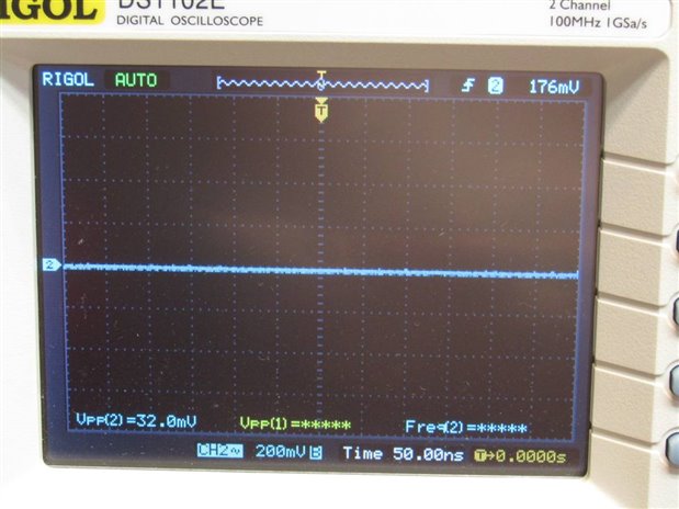

    As soon as I put a 1 uF Tantalum capacitor between the image5 volt output and the ground the ripple totally disappeared.
    Your problem may be as simple as using the correct capacitor on the output of the 7905. Unfortunately in my case the Tantalum was not a magic bullet. A 1 uF electrolytic did just as well at eliminating the oscillation. Let me know if you want me to try any other permutations.

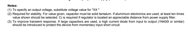

    Hi Andrew,
    According to note 2 in the data sheet the Tantalum Cap is important and at least a 10 X value of Electrolytic is needed to substitute. Also if the pig tail on your scope is earth grounded this may have some effect if you are using it to tie to the -5 volt rail.
