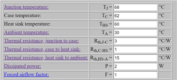

From the datasheet, the TO-220 package has the following thermal characteristics:
Rja = 19C/W
Rjc(top) = 17C/W
Rjp(top) = 3C/W  (jp in this case means Junction-to-exposed pad)
Am I right in thinking that for a TO-220, the Rjp value is a reference to the tab when used with a heatsink?  Typically, Rjc would be used, but if this was the case, then adding a heatsink of any thermal resistance > 2C/W would make it worse!  An older version of this datasheet just referred to:
Rja = 19C/W
Rjc = 3C/W
This would tie in with my interpretation.

    Not sure I understand Doug.  When I've been doing a thermal calculation it is along the lines of:
    Pdiss = V*I
    Tj = (Pdiss * Rja) + ambient  (no heatsink)
    Tj = (Pdiss * (Rjc+Rha)) + ambient (heatsink with thermal resistance of Rha)
    Typically, Rjc is a lot less for an IC than Rja because it's a value to use with a heatsink:  Junction-to-Case-to-heatsink-to-air (ignoring thermal paste or thermal pad).  In the datasheet, Rjc is only 2C/W less than Rja so adding a heatsink would make it worse.
    Example
    Ambient: 25C
    Pdiss: 2W
    Tj = 2w*19c/w + 25C = 63C
    Tj = (2W * (17c/w+10c/w)) + 25 = 79C (with heatsink Rha of 10c/w)
    If the Rjp value was used:
    Tj = (2W * (3c/w + 10c/w)) + 25 = 51C
    Hence my question.  In the slightly older version of the datasheet, TI only gave a Rja = 19c/w and Rjc = 3c/w.

    I think we are saying the same thing. The case-to-air resistance should be the main component in the junction-to-air resistance number (Rja = Rjc + Rca).
    Heatsinks increase the surface area which reduces the metal-to-air resistance which decreases the case-to-air resistance because case-to-heatsink resistance (metal-to-metal) resistance is small.

    Measuring current for reading three thermistors and displaying text values on the LCD is drawing approximately 0.235mA - although it does vary between that and 0.224mA.  I could get away with a 15C/W heatsink which can be quite small (and I think I might squeeze in just) but I much prefer your idea especially as it's a pin equivalent, fits and a lot more efficient.  I also don't know if it will work a lot harder once I get the graphics going and the voltage/current monitoring.  Got one on order so I will be able to test it out tomorrow hopefully.
    0 shabaz over 7 years ago in reply to Andrew J
    Hi Andrew,
    You might find the Arduino takes much less power on average (but I'm not sure.. also depends on which Arduino) in which case the 7805 may be fine with a smaller heatsink, but in any case that DC-DC converter should be ok without a heatsink.

    The Arduino takes 5v input, 5.5V max, 320mA (average use of features) and inverting charge pump (LTC1683) 3.5V to 5.5V max, 14mA so a 5V 1A converter should be sufficient - possibly 500mA, although the datasheet for the Arduino mentions the provision of a 5V 1A supply.  Is there anything in the datasheet I need to be picking up on?
    The Traco Power component, for example, gives 50mV pk-pk; 0.4% regulation load variation.  It doesn't state any thermal characteristics except "Allows full load operation upto +70C ambient without heatsink"
