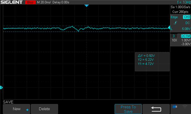

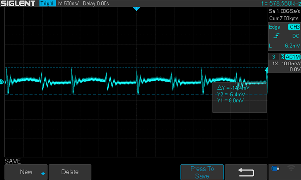

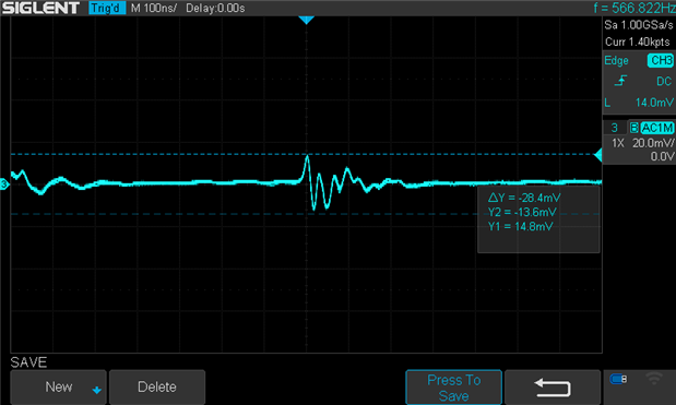

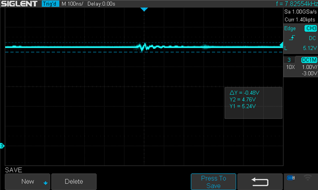

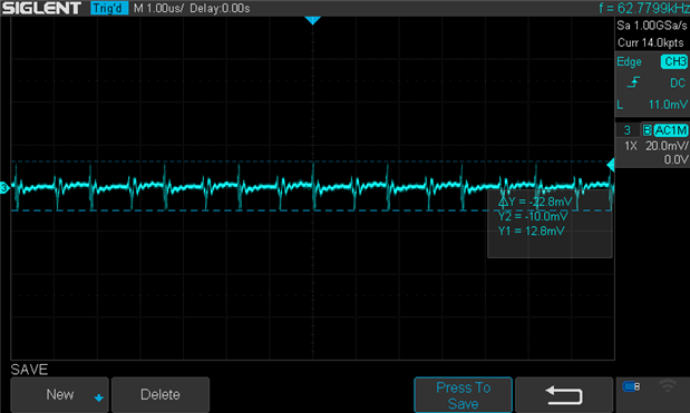

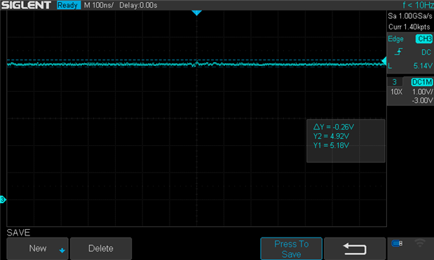

    The isolator arrived and I hooked it up - in the end I went for a Recom RS6-1205S.  It's very similar to the Traco one, a bit cheaper.  It actually works for what I want to do: using it to power Side A of the i2c and digital isolators as well as the Arduino.  I did some quick measurements:
    Initially load was just a 1K resistor:
    AC with 0.1uf and 1uf capacitor on the output:
    DC with 0.1uf and 1uf capacitor on the output:
    AC with 0.1uf, 1uf and 10uf (electrolytic) capacitor on the output:
    DC with 0.1uf, 1uf and 10uf (electrolytic) capacitor on the output:
    Powering side A, still with 0.1uf, 1uf and 10uf (electrolytic) capacitor on the output:
    AC:
    DC:
    It's quite noisy, as Michael alluded to, and there is quite a large amount of ripple induced on the DC (datasheet states 25mV to 75mV) but it's on a breadboard without any great output filtering.  I still need to work through any impact this has on Side b (where the DAC and ADC are located.)  In theory, I would expect none as they are driven through I2C commands and the DAC is powered from a REF5040 which is used as the reference source for the DAC output.
