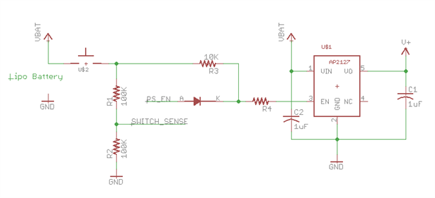

    0 genebren over 6 years ago in reply to justphred
    Michael,

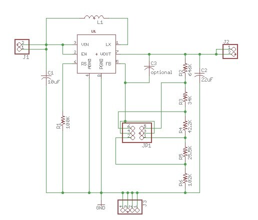

    It appears as if there is a pull-up resistor on the enable input.  You could add a 10K resistor to ground to pull the pin low when it is not being driven high.  (Note: in a quick read of the chip and board datasheets, I see no mention of a pull up on the enable.  I should check this again with glasses on in the morning).
    If you have a 10K resistor to try as a pull down.  It will interesting to see what happens.

    0 justphred over 6 years ago in reply to genebren
    Ok I have some circuits out in front of me and I'm seeing a problem.
    I have one of those voltage boosts wired up. With nothing going to the Enable pin, and as it sits it is sending current to the board. If I jumper enable to ground the circuit shuts off and stops sending power to the board.
    Is this Enable working differently than expected?

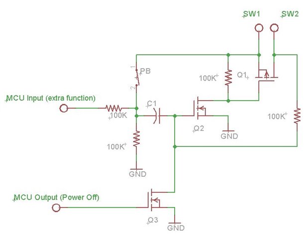

    The FET circuit I posted above handles all your requirements as I perceive them. If there is a feature missing, please explain.

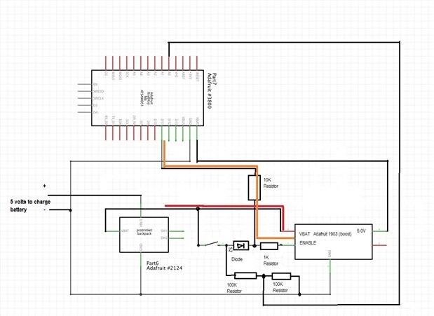

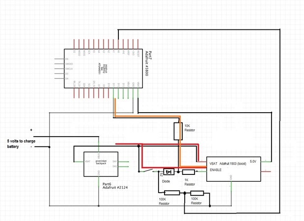

    Michael,

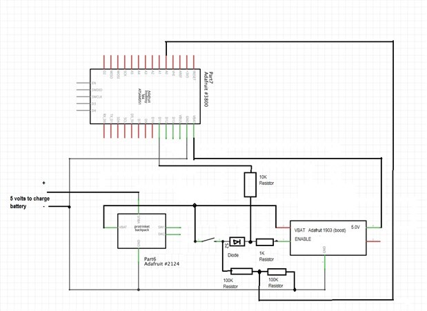

    In each of the examples that I shared with you, I solve the problem with the switch release removing power, by having the microprocessor hold the circuit on (i.e. keeping the regulator, or boost enabled).  This removes the need for timing circuits to keep the transistor and/or MOSFET turned on.
    OK, let's break this down just a bit.  In the first image, the switch is pressed and current flows (lower RED path) through the switch to the 'ENABLE' on the boost board (or regulator).  This applies power to the ItsyBitsy. (also showing current path to the boost in RED)
    Now, upon wakeup the ItsyBitys Turns D11 High to provide another current path (ORANGE) to the 'ENABLE' on the boost board (or regulator).  This acts as a 'keep power on' signal.
    Now, when the switch is released and current quits flowing through the lower RED path, the ORANGE path holds the  power on.
    Now it is possible to use the switch as a user interface function, by monitoring the voltage between the two 100K resistors on 'A0' pin of the ItsyBitsy.  When the 'ItsyBitsy' decides that the current should shut down, the ItsyBitsy it turns D11 Low to to the disable on the boost board (or regulator) and shut the circuit down.
    I have used this logic on a number of battery powered projects and I find it to work quite well.

    What about the timing of it all, using a MOSFET would still give me the same issue wouldn't it? when I let up on the switch the board will lose power, and thus not keep the MOSFET circuit closed. Or am I not understanding how a MOSFET works correctly?
    0 dougw over 6 years ago in reply to justphred
    If you use a P-channel mosfet instead of a bipolar transistor, the voltage drop can be negligible and the capacitor will hold it on for a long time.
    However the drive logic would be reversed (low gate voltage turns it on).

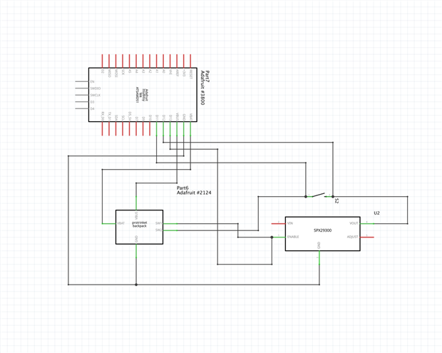

    Hey Gene,
    I had taken the last few weeks to put some distance between me and the project and, also was trying to do some test on my own.

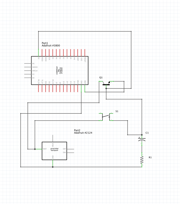

    Where I ended up with my own testing was using an NPN Transistor with the switch going to the base. So that when I pressed the switch V would flow to the board.
    This worked, however, I was not able to get the board to keep the transistor open. Mainly due to the timing of it all. When I let up on the switch the power to the board was gone, thus the transistor would close. So I tried to add a capacitor in line with the switch so that when I would let up, there would be some time before the board fully lost power. yet the falloff is still too quick and the board dies almost instantaneously.
    What I need fo this to work is a capacitor capable of delivering 5mA for ±500mS after I let up of the switch. I tried putting a resistor in series with the capacitor so that its decay would take longer. But that either made the capacitor never reach the desired voltage. or didn't slow the decay enough. also the larges cap I had on hand was a 1000uF 25v.
    The other thing that I noticed this way is that I am now under-volting the board by going through the transistor. I went ahead and picked up two different boost converters. A 5v @ 1A (https://www.adafruit.com/product/4654 ) and a 5v @ 100mA ( https://www.adafruit.com/product/3661  ) both have the enable pin that I believe you are referring too.
    I toyed with using the enable pin on the itsybitsy, but that doesn't cut power to the vHi pin which I am using elsewhere in the circuit, which would leave stuff on.
    here is the schematic of where I have gotten too. I am gonna take a look at what you drew up. again I took some time from this to try and get a fresh take on it.
    Also, THANK YOU to all. this has been the most helpful forum post I have ever been a part of!

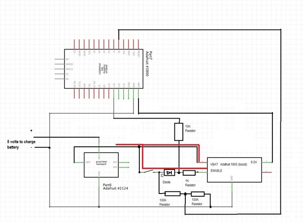

    Michael,
    Here is a crude attempt at a drawing of a circuit that might work for you.  I found another Adafruit part (#1903) that might help you.  This should allow to prototype your project and see how it works.
    I could see that you were struggling a bit trying to understand how the pieces connected, so hopefully this will clear things up.  There are three Adafruit modules and here is how they connect:
    1. Adafruit 2124 - Charger -  5 volts connect to the module at 5V and GND and are used to charge the Li-Ion battery.  The battery voltage (BAT) connects to the switch and to the VBAT terminal of the Boost module (1903).
    2. Adafruit 1903 - Boost - The Enable pin (EN) is driven high by the momentary switch (from VBAT) or from the Adafruit 3800 (ItsyBitsy) to turn on the Boost Circuit.  The output 5.0V provides power to ItsyBitsy.
    3. Adafruit 3800 - ItsyBitsy - Power from the Boost is applied to the VBAT pin (power input). D11 (or any other Dx pin) is used to hold the boost on (high), or to shut it off (low).  A1 is used to sample the switch output to see if it is pressed or not (for user interface functions or to turn off the unit).
    4. Misc parts.  - Diode - this is used to prevent voltage applied by the ItsyBitsy (holding power on) from attempting to charge the battery.  The two 100K resistors are scaling the voltage at the switch output (from 4.2 - 2.5V down to 2.1 to 1.25V so that they will be in the proper ranges of the ItsyBitsy ADC input (< 3.3V).
    Hopefully this will be a little clearer of a picture in how things could be interconnected.  Please keep in mind that I have not used any of these modules, and only quickly reviewed the documentation, so some of this may require a bit of tweaking to get it all correct.
    Good luck and have fun!
    Gene
