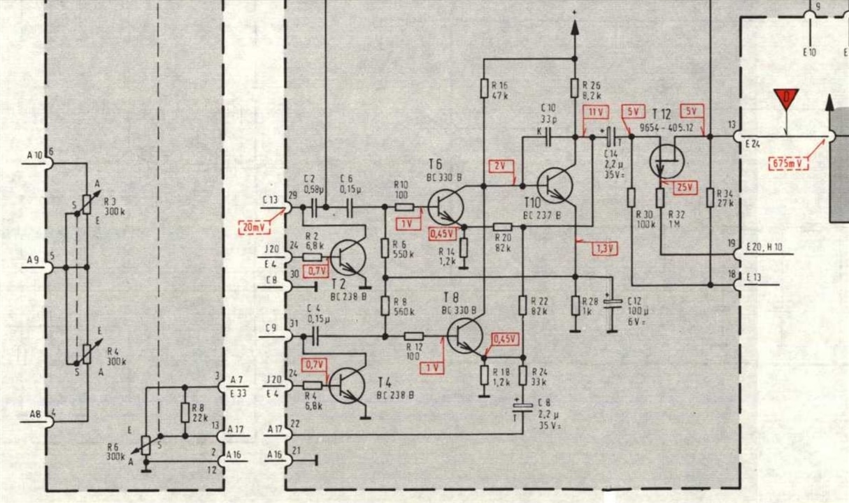

I need some smart input from you... I am looking for some replacement transistors for my old tape recorder. The recorder sounds like a thunderstorm, so I think one transistor is bad. Since those transistors (BC330C, BC237B, BC238B) not are available anymore, I am looking for replacements.
In this case, since the design already is given, is "typical hfe" the parameter witch is most important to match with the original transistor? - To keep the same amplification steps.
All maximum-voltages must of course to be the same or higher to the original.
I have some BC550C with hfe=420-800. Is it correct to think that the typical hfe for the BC550C is in the middle of this values =610 ? Too much amplification in my case?
Any input is appreciated Blush
Christian

    b139b said: The recorder sounds like a thunderstorm, so I think one transistor is bad Have you already replaced the electrolytic capacitors? They are far more likely to have gone bad.

    Hi, The BC550 is likely fine for all of these NPN transistors, since the actual transistor gain doesn't matter usually (because the circuit will control the actual gain). The BC550 is a very decent substitute…
    shabaz over 3 years ago
    Hi,
    The BC550 is likely fine for all of these NPN transistors, since the actual transistor gain doesn't matter usually (because the circuit will control the actual gain). The BC550 is a very decent substitute for most TO-92 NPN transistors I expect. It's my standard go-to transistor (well, the BC549 version) for non-RF stuff.
    You could swap out one transistor at a time, replacing it back if it makes no difference. However you have voltages labelled on the schematic, so you can actually do the testing in-circuit with a multimeter.
    Are you sure it's not just a faulty switch or noisy potentiometer? Silicon transistors are very reliable. I have a ~60 year old radio receiver on my desk and it is still functioning.
    You could also use a test tool (or a crystal earpiece) to view or listen to the audio too; the crystal earpiece is non-intrusive to most of the circuit. Ideally you'd want to use an oscilloscope if you have access to it however.

    Just a little more info please.  What does "sounds like a thunderstorm" mean?  When you adjust the volume does the sound change?  Does the sound occur for both tapes you recorded and pre-recorded?  Gordon

    The Thunderstorm is heat depended...came when I thought the player was fixed after the backlid was on. I have changed all electrolytes and C2. With a oscilloscope/RTA I can see that the signal is ok at the left side of C2 but the noise is present at the right. I have tried to find the faulty component by knocking on the components, potmeters too. Cool them with freezespray... heat with a heatingun but no component changed clearly.

    The worst case noise figure for the Multicomp BC237 is much worse than for the BC330C or BC550 (although the typical figure is similar). The OP's schematic doesn't give enough context to know if that matters much or not .
    My source for BC330 data is not that traceable either !
    MK

    So the BC550C would be a better choice? Both BC237B and BC550C are low noise types
