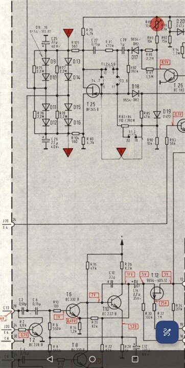

I need some smart input from you... I am looking for some replacement transistors for my old tape recorder. The recorder sounds like a thunderstorm, so I think one transistor is bad. Since those transistors (BC330C, BC237B, BC238B) not are available anymore, I am looking for replacements.

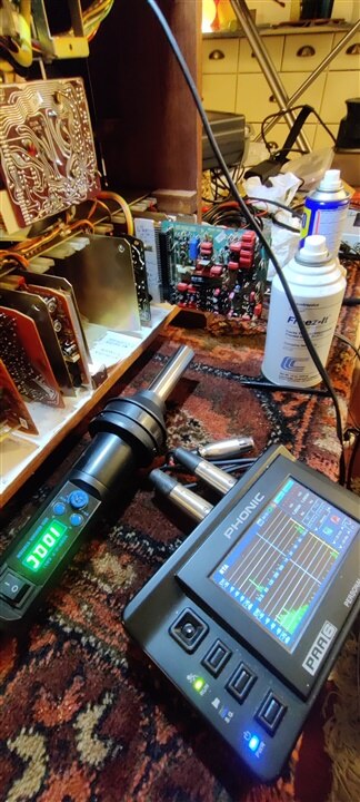

    Here is my setup. The 50Hz comes from the charger. image

    Right side of C2 goes with the wire somewhere up high - could the noise come from there?

    Almost certainly a better choice. In the original design they could have used a BC237 for T6 and T8 but they used a different part. If in doubt it's probably best to respect the intentions of the original designer.
    What make and model of recorder is it. Is the complete schematic on the web ?

    This is a Grundig TS1000. There are schematics on the web. Not all of them with good quality. The player uses BC550 another place originally too. When the BC550 is better, why not used it here...? T6 T8.

    Goes to the Auto level part. I think they rectify the signals an use this to set the recording level automatically. image
    Could be, cause the other channel has made a "bump" (... oh, my English Rolling eyes) onces or twice. But very seldom. Could be something else too.
  • ggabe
    ggabe over 3 years ago in reply to b139b
    Is the issue happening with or without auto leveleing, or in both cases? T6/T8 seems serving the leveling/regular path. I would look at replacing C25/C26, perhaps before doing it just to put a known good cap in parallel to see if it reduces the noise. Are the voltages across R77 and R78 equal?

    Also, you could temporarily bypass the autolevel to see what happens, by lifting the two capacitors C2 and C6, and bridge across with a single capacitor, if you suspect auto-level.
    If you don't already have a 'scope (not sure the Phonic product you have there will replace it unfortunately) then it would be worth picking up a low-priced one, since there are some reasonable options at $200 and under.
