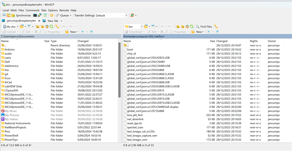

    an other option (as mentioned by SensoredHacker0 ) is to use an scp client on your windows PC. Instructions here . After logging in, you 'll get an interface like this, with your PC filesystem(s) left…

    an other option (as mentioned by SensoredHacker0 ) is to use an scp client on your windows PC. Instructions here.
    After logging in, you 'll get an interface like this, with your PC filesystem(s) left, and the Raspberry filesystem right.

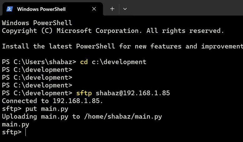

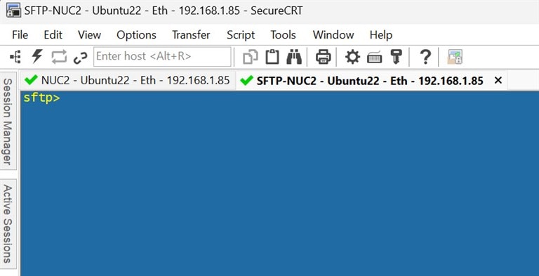

    I cannot remember the last time I used a USB memory stick with a Pi, but don't recall an issue; my daily desktop machine is a Windows PC. However, as mentioned by others, if your machines are connected, then it's much simpler usually to use the network. Many SSH clients will have SFTP capability built-in (or use command line). I use SecureCRT a lot, but it's paid software (but excellent, well worth it).
    Or, another free option,, just directly from PowerShell, you can use 'sftp'.
