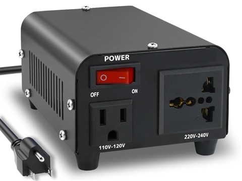

    Just before COVID, I bought a 300VA 120V to 240V transformer off Amazon.  It looked like the one below.  It was about $20 then.  I plugged it in and it starter shooting flames out the side.  I tried to turn it off, but the power switch was already in the OFF position.  So I yanked the cord.  Doing the forensics, the incoming power contacted the case just below the transformer ring.  About half of the wire inside was intentionally bare.  All of the splices were bare - ergo the short to ground.  AND the unit was switched on the neutral (return) conductor.
    Given what I saw inside, I didn't ask for a replacement.  I just took my loss and ordered a larger, better brand.

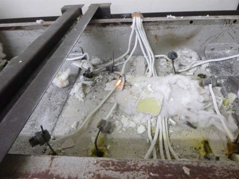

    attached is a photo of the wire just as we opened the cover of the BTU engineering oven just after it broke
    I think the impresive part of this was getting the photo in time
    the warning we had was temperature was varring
    working on machines while live can be dangerious but useful
    Yes we turned it off to repair it

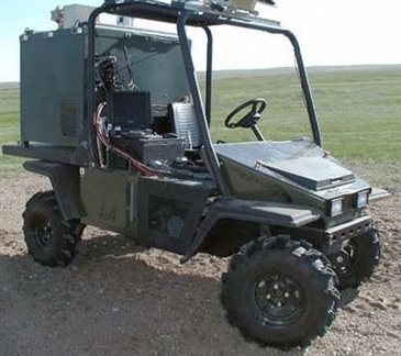

    This isn't about a low cost component, but it was dramatic and terrifying. I was standing nearby when my associate dropped a large wrench that shorted out a large battery capable of supplying over 700 Amps.
    Well, it sounded like an explosion followed by sparks and flames. It was pretty tense while we tried to figure out how to remove the short. Fortunately the wrench eventually melted enough to lose contact with the battery terminals.
    Unfortunately, I don't have a picture of the mangled wrench, but the big robotic vehicle we were working on looked like this...
