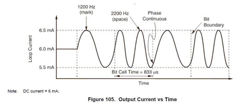

The DAC8775 implements the physical layer. It doesn't know HART protocol or data handling, but can generate the compliant signal on its output.
In essence, it accepts a sinusoidal signal of 0.5 Vpp, either 1200 or 2200 Hz, and translates that in an AC current component on the output of 1 mA
The image above, from the DAC8775 datasheet, shows how the DAC, when set to a  6 mA DC output current, mixes a HART signal of 0.5 mApp to it.

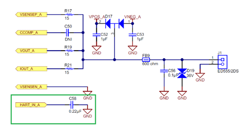

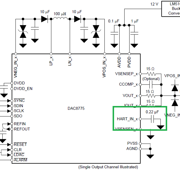

The evaluation kit used in the element14 Road Test has no breakout point for the HART inputs. On each of the 4 DAC channels, that pin is coupled to ground via a capacitor.
I'm using channel A, so I have removed the capacitor for that module's HART input - C58, and soldered a patch wire to the PCB.
The HART input signal has to be capactive coupled. The HART pins on the DAC8775 have a DC bias. I used a 0.470 µF capacitor.
According to the data sheet, a value between 10 and 20 nF is recommended. I wasn't in the mood to go look for one.

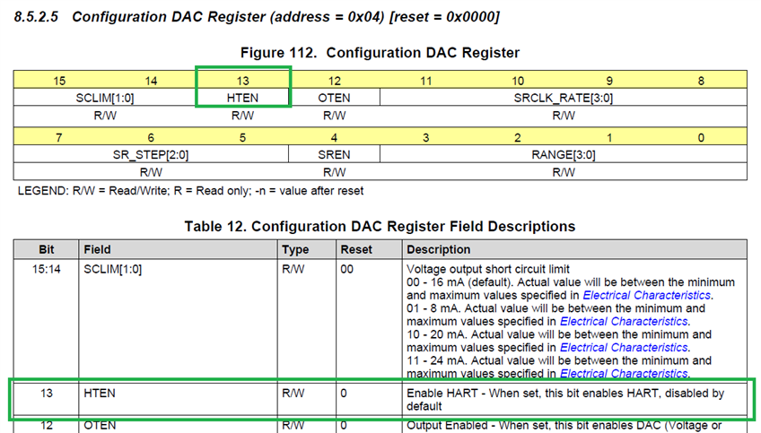

There are two things you have to do:
  • enable the HART interface on the DAC in your firmware
  • provide the HART input signal. A sinus of 0.5Vpp, with 1200 or 2200 Hz frequency.
To enable the HART interface, you need to set bit 13 of the DAC Config register 0x04.
In our initial example, we were setting the bit 12 high, because we enabled the DAC output.
So we only have to change that part of the code, and instead of sending 00010000b (0x10), we send 00110000b (0x30).

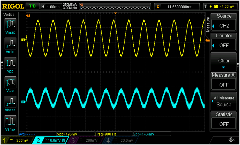

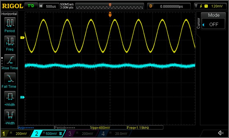

I simulate the HART signals with a generic function generator. I set it to sinus 1200 and 2200 Hz. I used my oscilloscope to set up a 500 mVpp output after the coupling capacitor of 0.470 µF.
Then I inserted the signal into the DAC and checked the output. Just like in the previous blog, I used an EEVBlog µCurrent as a load. It translates the DAC's output current into a voltage.
I attached channel 2 of my oscilloscope to the output of the µCurrent.
The yellow signal is the HART input, generated by the function generator. It's 500 mV, 1.2 kHz.
The blue signal represents the DAC's output current. Each mA is a mV on the Oscilloscope display.
You see the DC component of 10 mA, and the 0.5 mVpp AC component superposed by the HART interface.
    Why not just use a resistor to convert the current to a voltage?
    If you used a 500R resistor (quarter watt or better - a pair of 1k resistors in parallel, maybe?), you could use a voltage probe and you'd see a voltage signal the same size as the one you're feeding in.
    I'm presuming here that the output is floating and the current is sourced rather than sunk, so it doesn't matter if you have the grounds on both the input side and the current output side connected to your 'scope ground (but you're now the expert on this chip, so you decide if that's correct or not).
    That way you'll probably see a better signal and can properly measure the current amplitude (if you have a reasonably accurate resistor); you'll be able to measure the delay; and, if your generator has a sweep capability, you can see what the frequency response is like (not essential, but what kind of engineer are you if you're not curious about these kind of things?)
